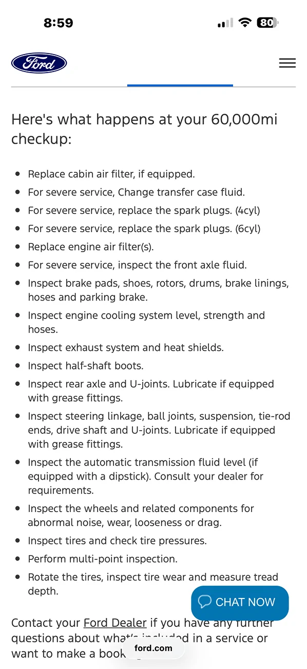

I like this idea, but am having trouble finding the severe service maintenance chart. Any idea where I can find it?
Ditto. Anyone hve a copy of the "severe service maintenance chart."

Hello, everybody. I’m the proud owner of a 2022 Wildtrak that I bought about 9 months ago used. I’m quickly approaching the 50k mileage mark. The maintenance schedule that Ford provides is… optimistic, in my opinion. I should mention I do a decent bit of offroading and towingWhat do y’all think I should REALLY be doing at 50k miles, and how often in general do you think preventative maintenance items should be done?
Here’s what I’m thinking for 50k… let me know if I’m missing anything, or if I’m being overly cautious.
