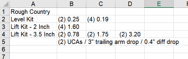

Ford Bronco Readylift 1.25" Level Kit Specs 1645735008653
Notes: Level 0.25 are the bottoms only.
3.5 Inch 0.78 is the spring preload

Buy either RC or Zone 2 inch lift. These give you four spacers that are about 1.5" high. Since the front has a ratio of about 1.5:1 they will push the front up about 2.25". But they only push the back up 1.5 inches.
Interesting! I’ve been looking for this sort of info on here.
So the uniform-size spacers still do provide some leveling? Seems counterintuitive, but it makes sense.
Has this been verified IRL?

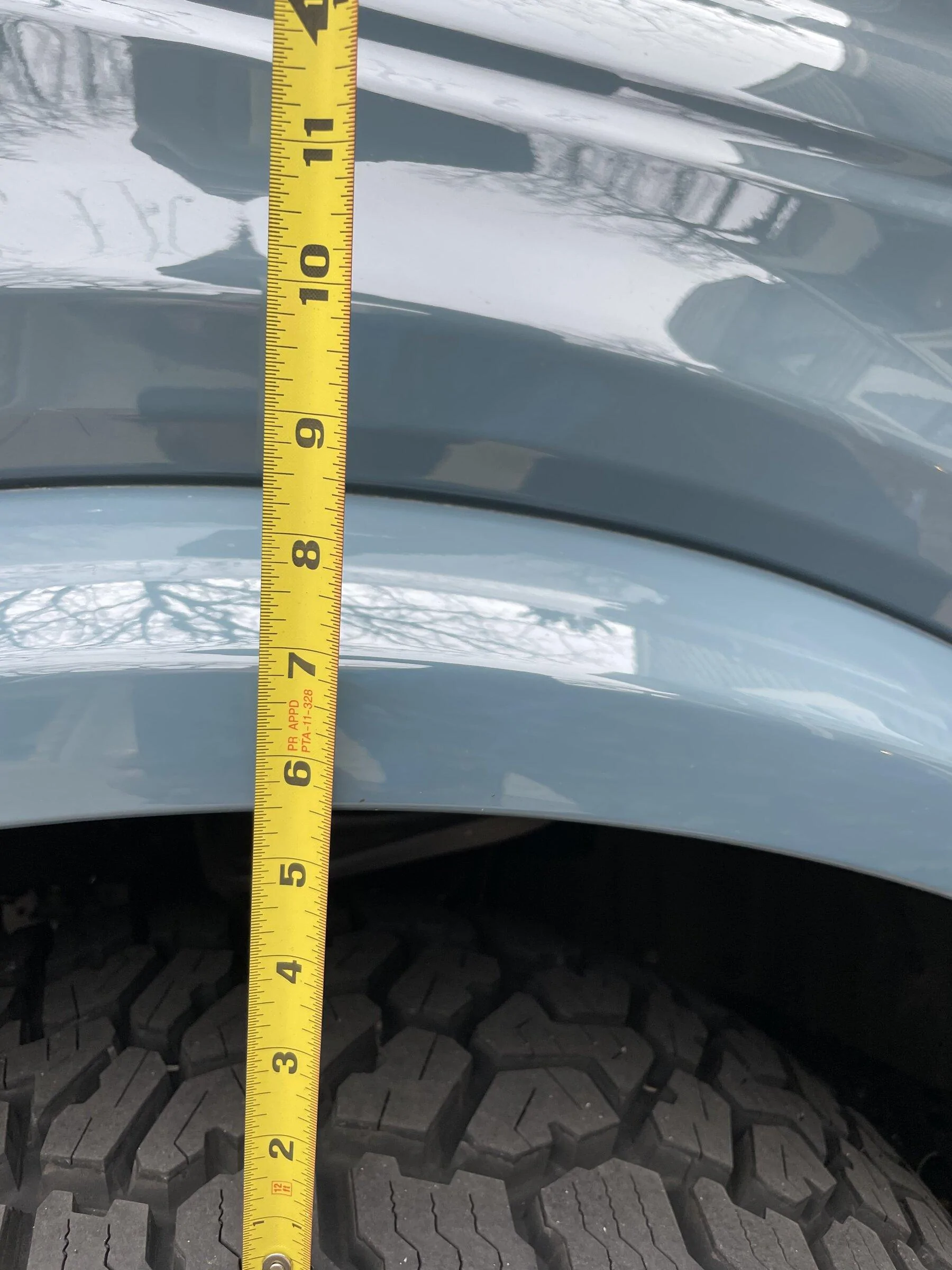

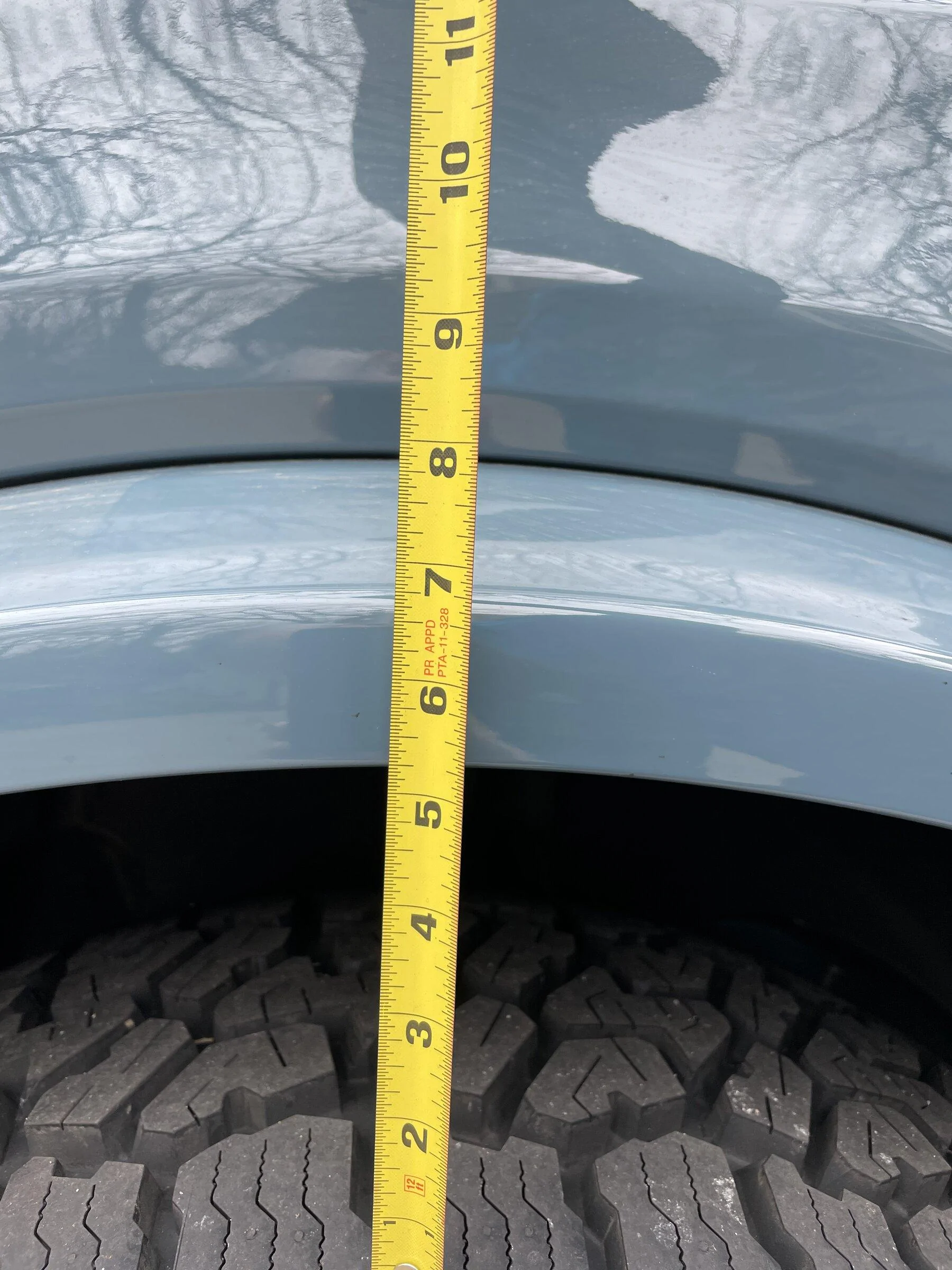

Here’s my non-Sasquatch fitted with Sasquatch wheels and the Ready Lift 1.25” up front. Space between the flare and the tire on the fronts and rears is 5 3/8” with an empty vehicle. When you get two people in the front seats the front drops about 3/8”.

Is it level or higher in the front with the Ready lift 1.25?
Nearly identical. Maybe 1/8” higher in the front empty but it drops the front 1/4” with two people in the front seats. Here are the front(top picture) and rear wheel to flare gaps. I measured with my daughter in the drivers seat, full tank and the flare to tire gaps were identical.

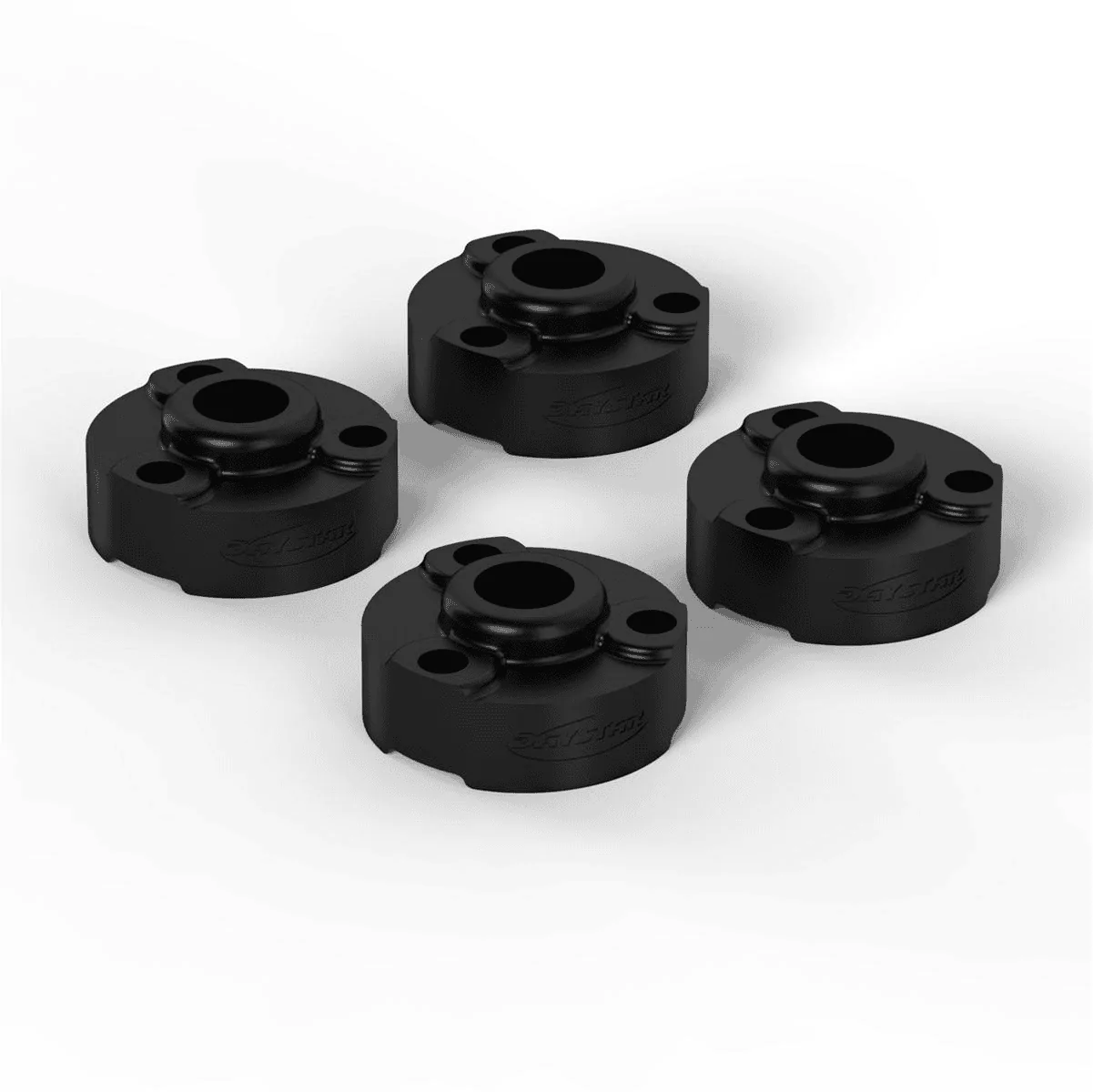

I ended up buying both the Zone 1” spacer kit and the Readylift 1.25” spacer kit to decide which I like better. Here are some pics side by side. The Readylift is a higher quality product with nicely machined edges, but I prefer the hardware on the Zone kit better because of the pinch nuts for the top of the strut instead of flare nuts that will cause rust when they gouge the coating off the frame. The Zone is laser cut and has some flash from the initial pierce under the powder coating. The total height on the 1” Zone kit is .628” (1:1.59 shock ratio), total height in Readylift is .742” (1:68 shock ratio). Using the stated standard on here of 1:1.5 for spacer height to lift for the front the Zone lift should be .942” and the Readylift should be 1.113”. Both top and bottom spacers on the Readylift kit are thicker than Zone. I can measure each individually if someone wants. The instructions for the Zone call for removing the spindle and pushing the stub axle out of the hub, the Readylift has you remove the lower control arm bolts keeping the stub axle secured.
My truck measures 1.5” high in the rear unloaded. I need to add some gear and my bike rack and see where it sits. At this point I’m planning on installing the Readylift kit. I don’t hate a little rear squat, very common on prerunner trucks where I came from in AZ.

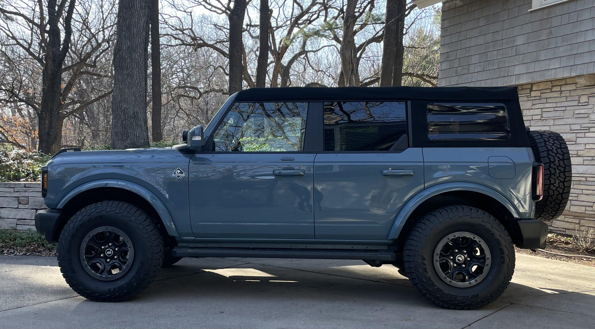

Here is my truck unloaded on the new tires, it was backed in to take this picture, so the toe angle might be pulling the front end down a bit. The front is 1.5” low measured at the fender flares centered on the wheel hub sitting in my garage.
