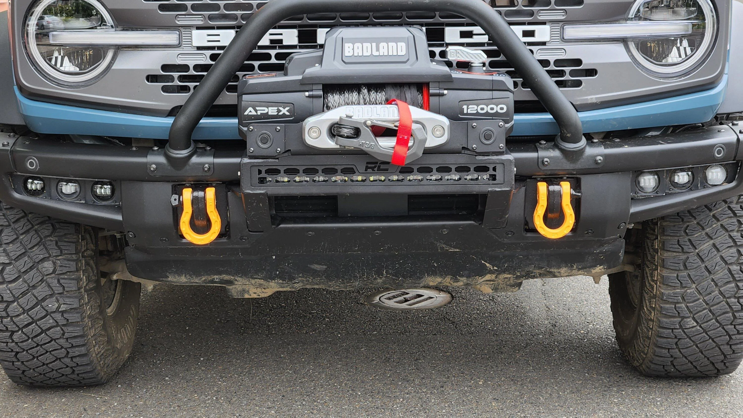

Thanks. I used undercoating. I did the fairlead and the engagement lever. I like the light texture it has, and it adhered well (after Scotchbriting it). It's faded to a lighter gray after about 6 months. I may Raptor line it next time I have the product out.
I really like how the blackout simplifies the look of the install over the bright aluminum.

Sounds good. The stock Badland fairlead does stands out a bit. I like the texture and might give undercoating a try but will probably leave the mouth of the fairlead bare to lessen abrasion to the line. I plan to use the winch a lot for landscaping. Or I may try using gloss paint for the high friction areas. Regardless, thanks again for the ideas!

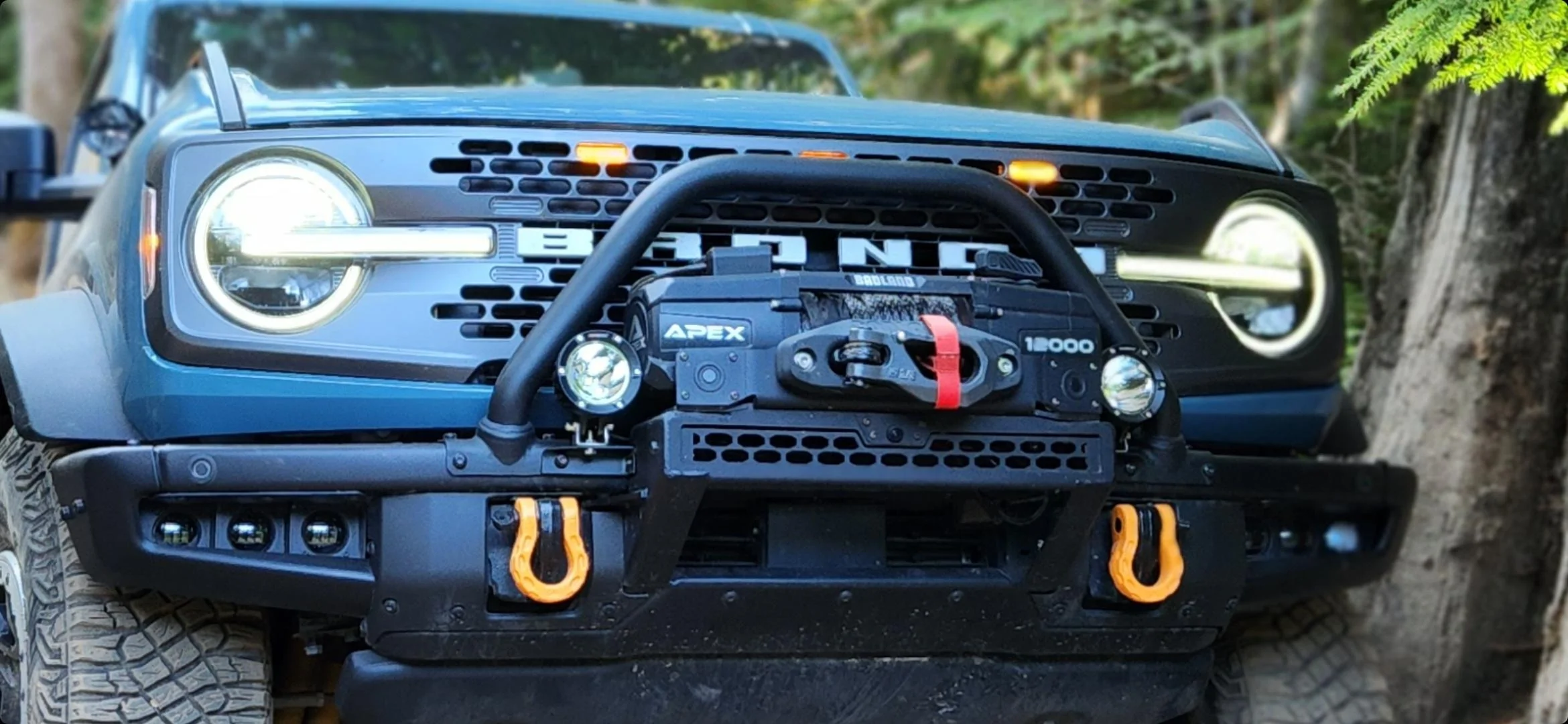

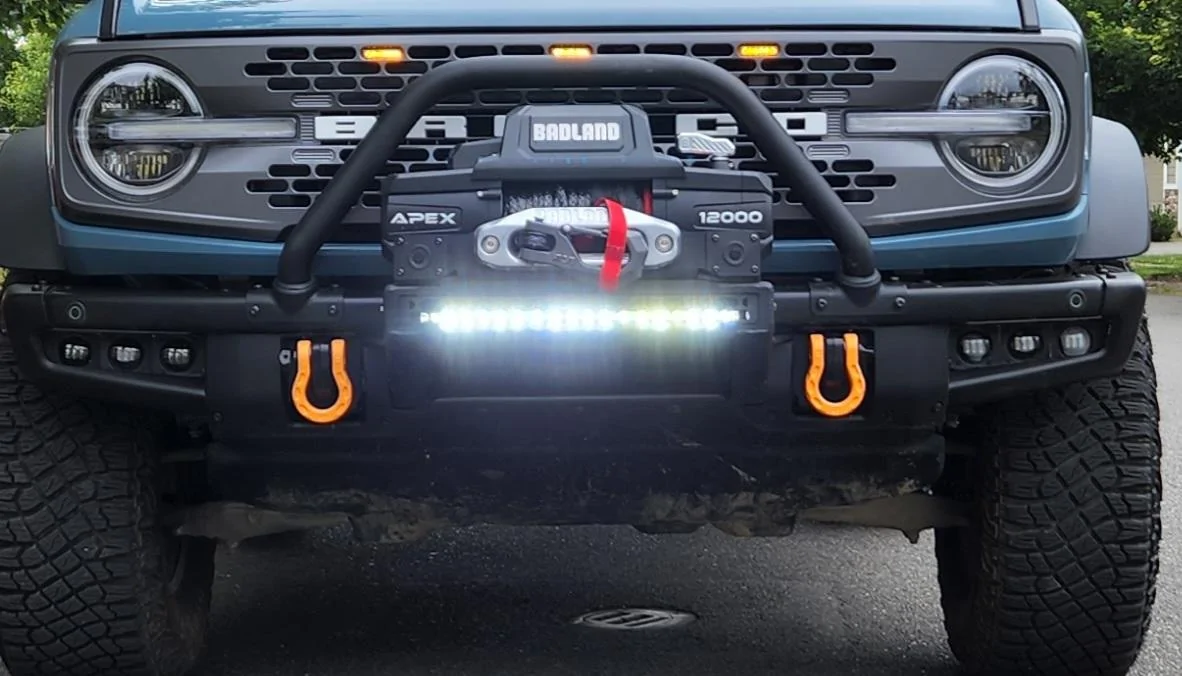

I wasn't a fan of the RC light bar... and I liked the way the RC grille resembled the Badlands grille... so at first I mounted a "stealth" light bar behind the RC grille.
I needed to move the control box (cooling issues)... and I needed to solve the camera issue. I figured I could always put lights elsewhere... but there was only one place I wanted to put that camera. I've got another set of pods for my cowl to replace the light bar from the winch.
After a lot of different configurations, I'm finally satisfied where I'm at.
Looks nice.
You're /were having cooling issues in WA 😲??? Does the winch really block that much air flow?
What temps were you running?

High 220s low 230s on lengthy uphill highway sections... and sometimes on trails with lots of inclines.
I solved most of the airflow issues by relocating the control box for the winch under the hood. Also fabbed up a way to relocate my camera underneath the winch... so I had to remove the "stealth" lightbar behind the grille. Fabbed up some brackets to mount some 4" spots in the space between the brush guard and the winch... that was a tight fit. Also blacked out the fairlead and engagement lever for a cleaner look. Pretty happy with the form and function now.
