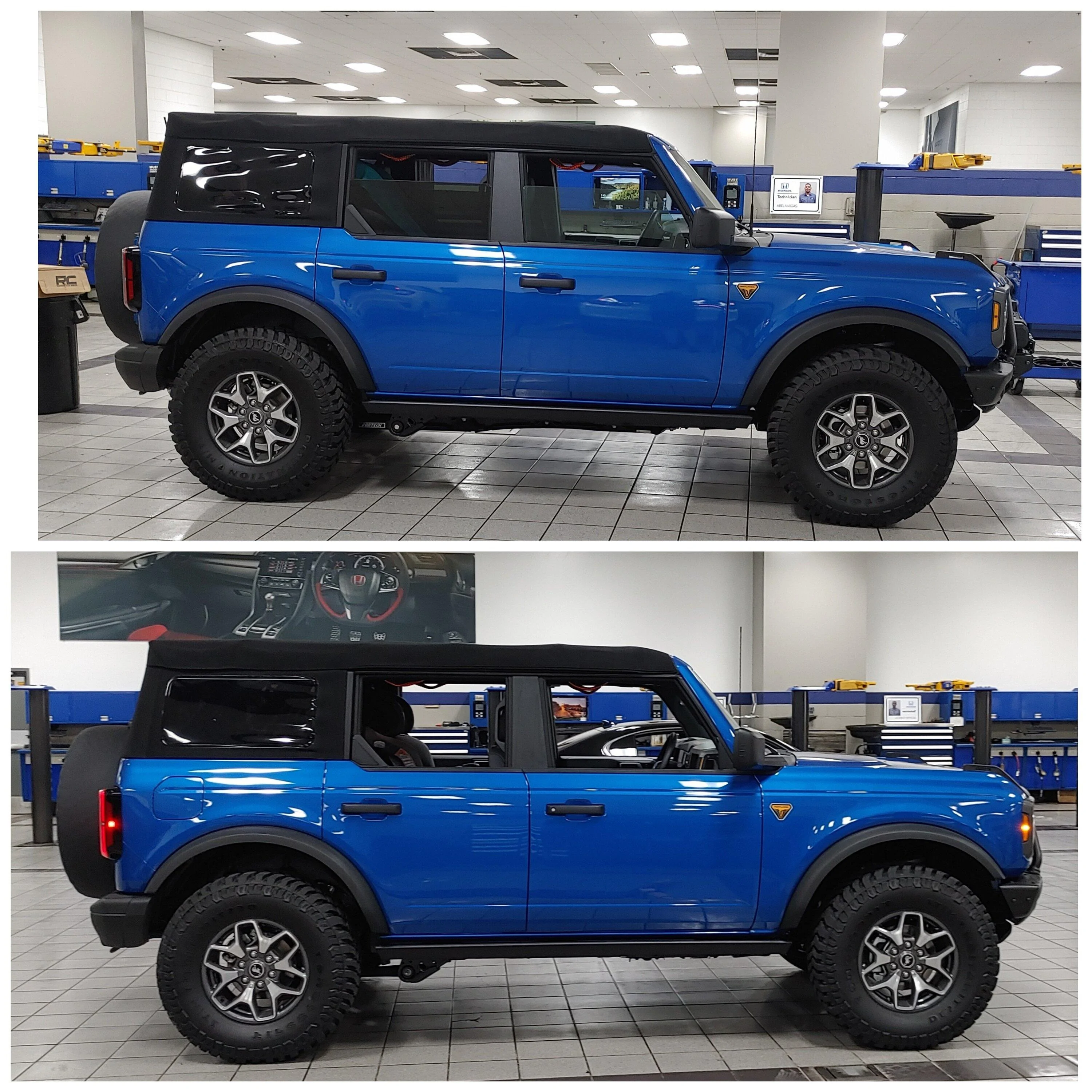

Does anyone feel like they had to do a leveling kit after?

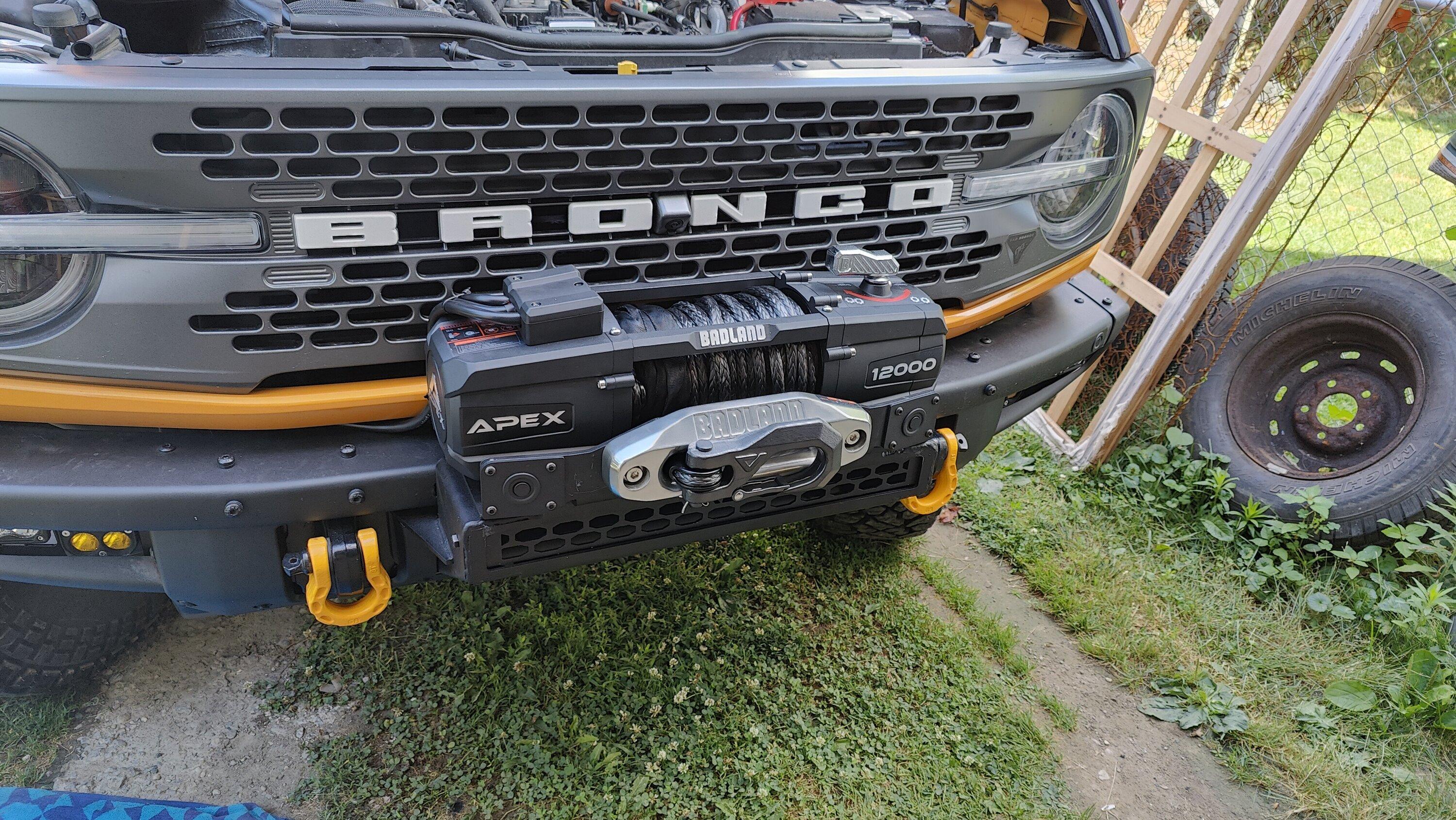

I installed my winch and mount yesterday. I couldnt really tell a difference in ride height. It might sag a little bit. Here's a before/after side shot. Top with winch, bottom without.

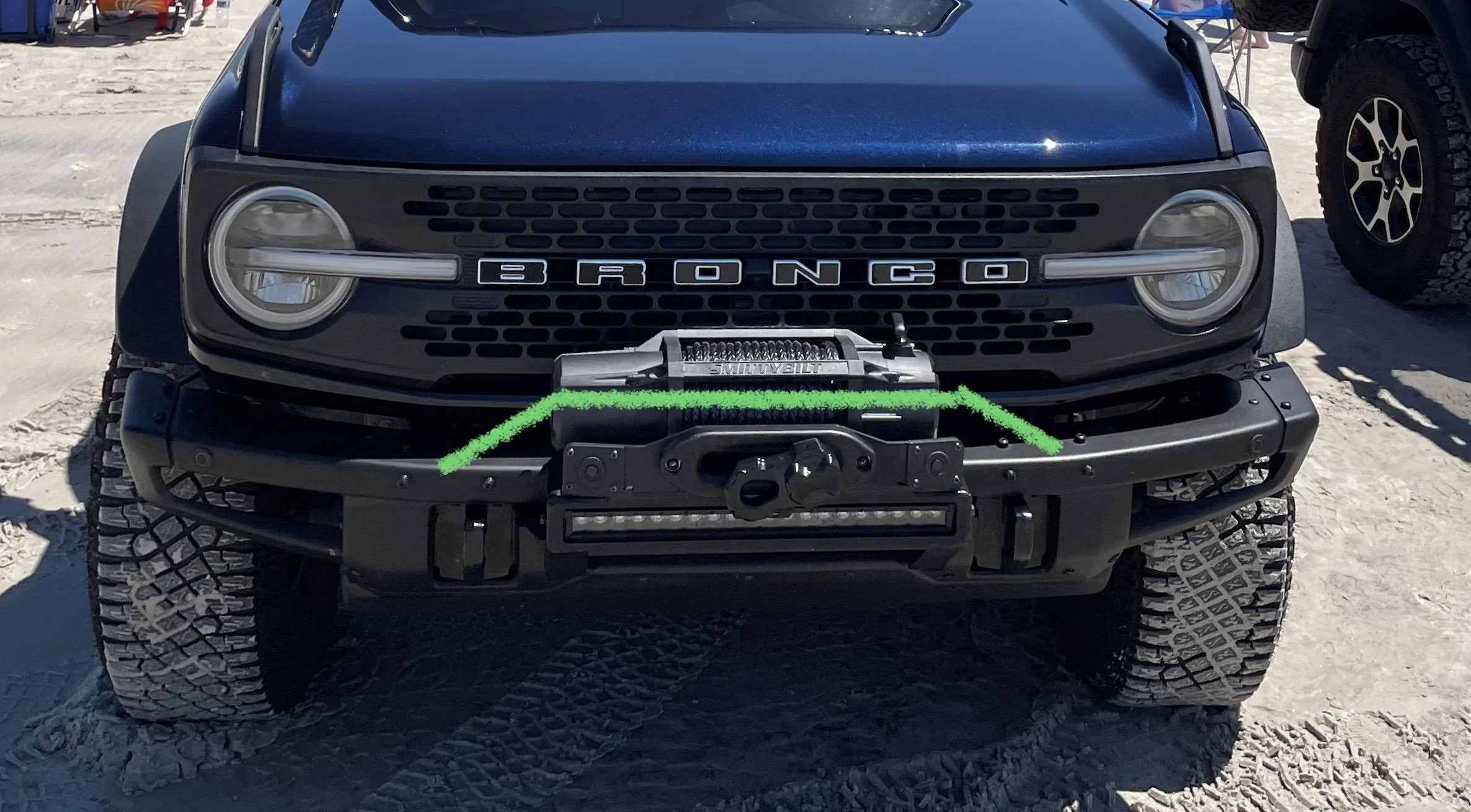

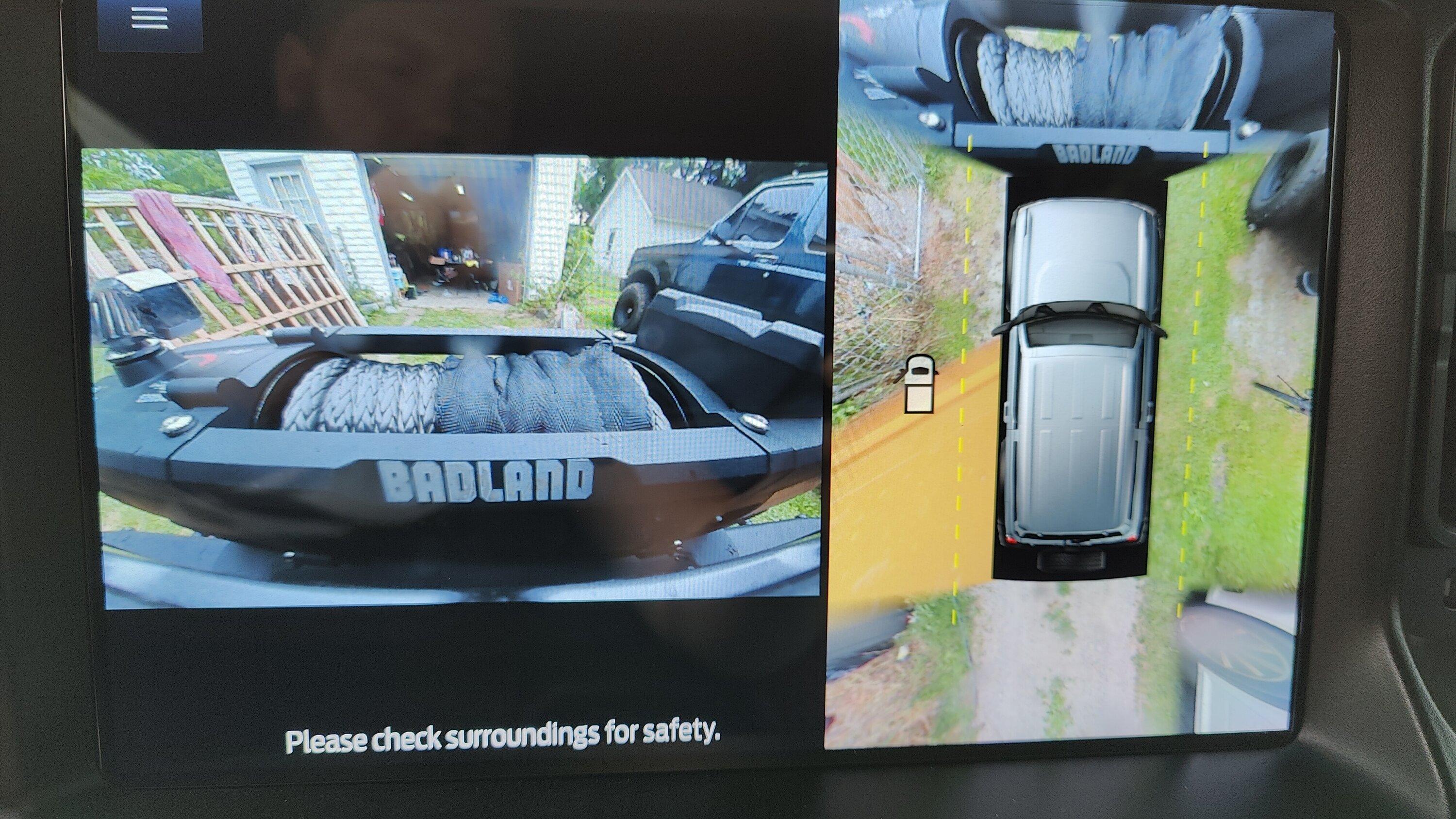

For a bar or brush guard to work for me it needs to be right above the fairlead. So essentially 8 inches from the grill face and above the fairlead plate. Would be right in front of the winch.would have to be as wide as the JCR mount before the bar angles to the bumper mounts.
That's where my JCR camera relocation bracket ended up. But, if the bar incorporated a place to mount the camera, that would work for me, too.
Can you please post a pic from the front?

Very nice setup! Just finished mine up over the weekend, I relocated my control box to the passenger side since I don't plan on running a compressor. I ordered a JCR camera bracket as well, hoping to see that soon.
How hard was it to relocate the control box the way you did for the apex 12000 winch? I'm considering doing the same. Any tips?
