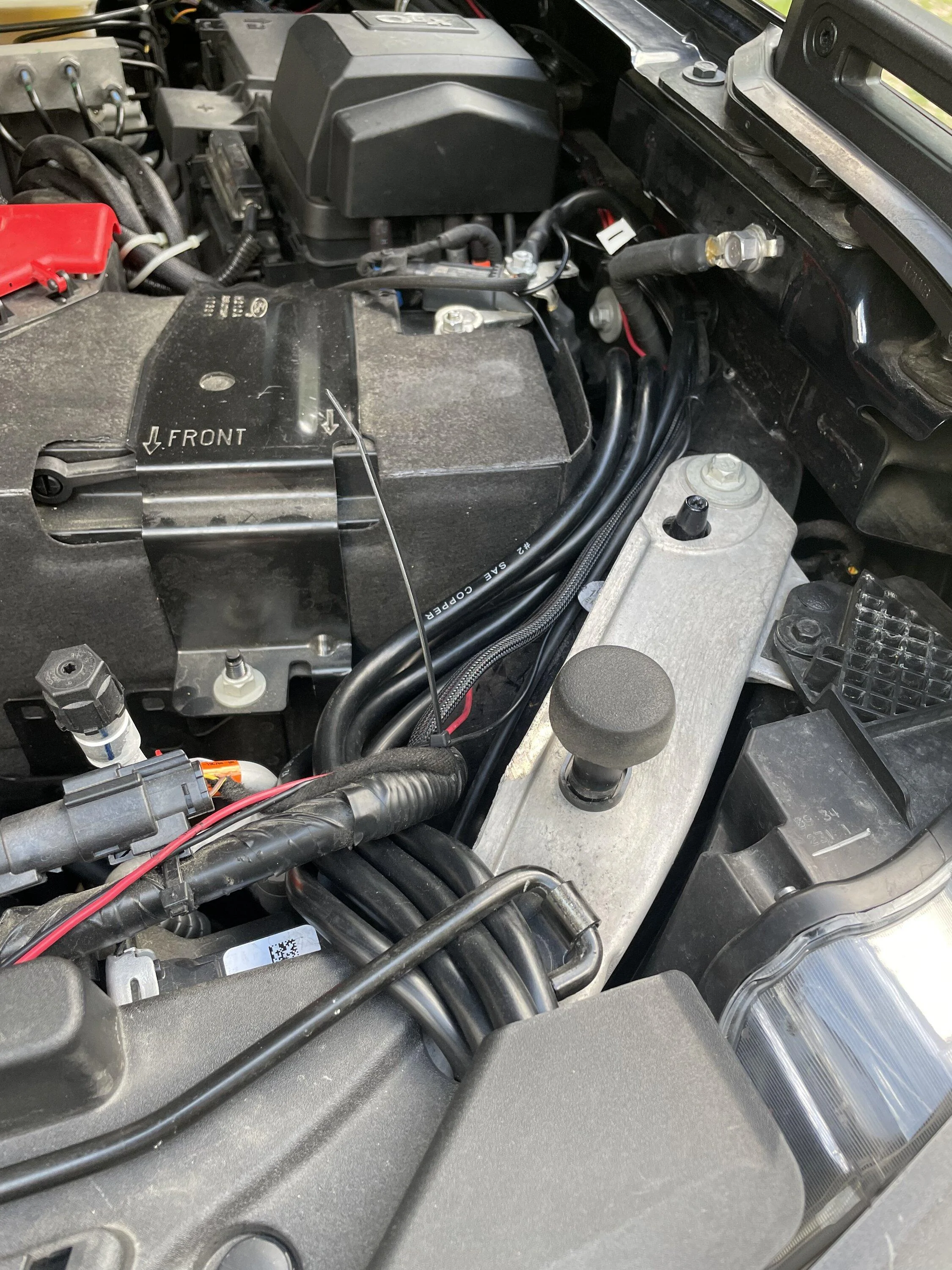

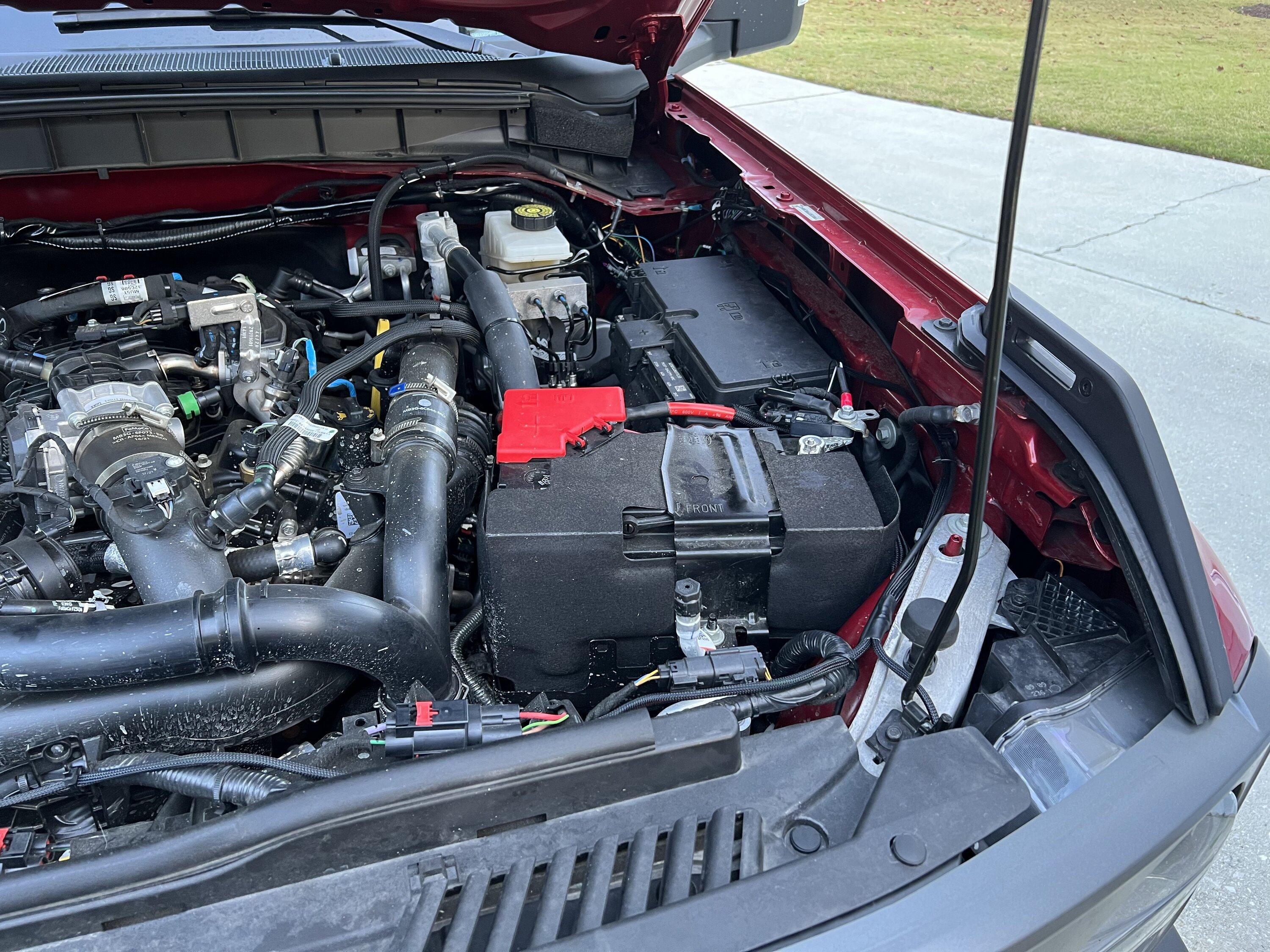

No worries and thanks for getting back to me. I ended up just getting a project box from Amazon. Can you describe how you routed your cables to the battery? I feel like it should be easier than what I’m coming up with.
Same as BroncoSarge, across the top of bumper and up the right hand side of radiator

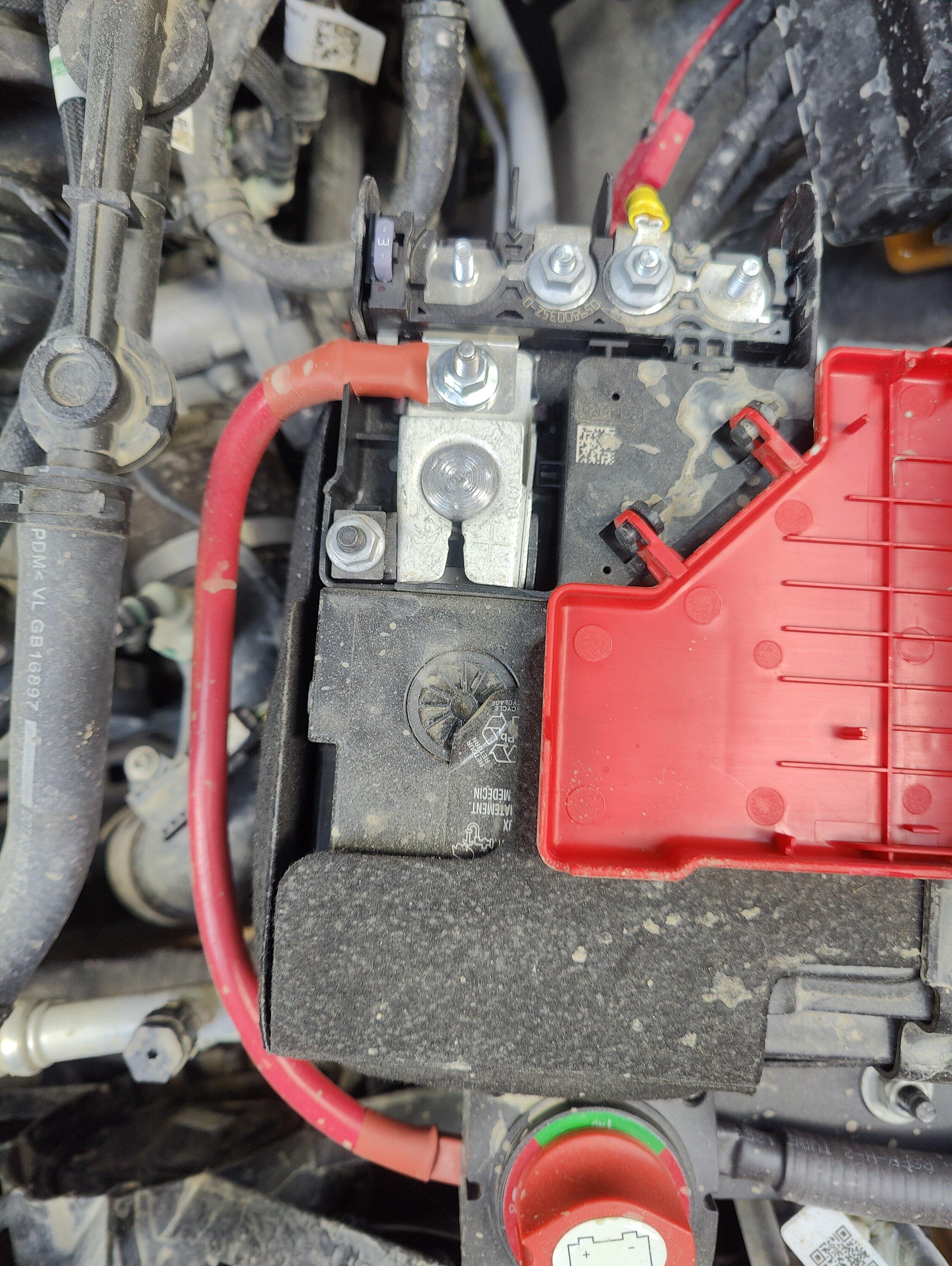

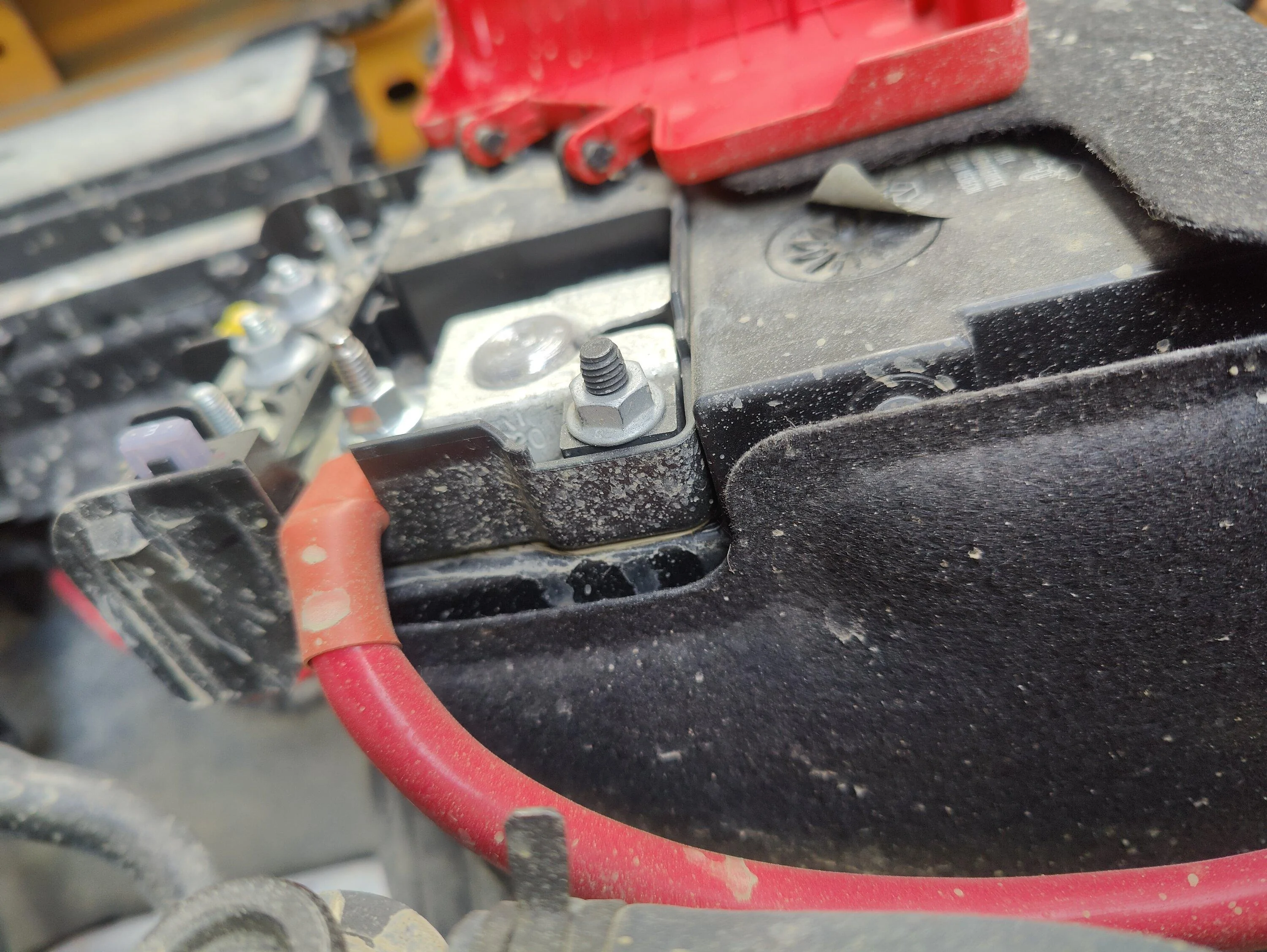

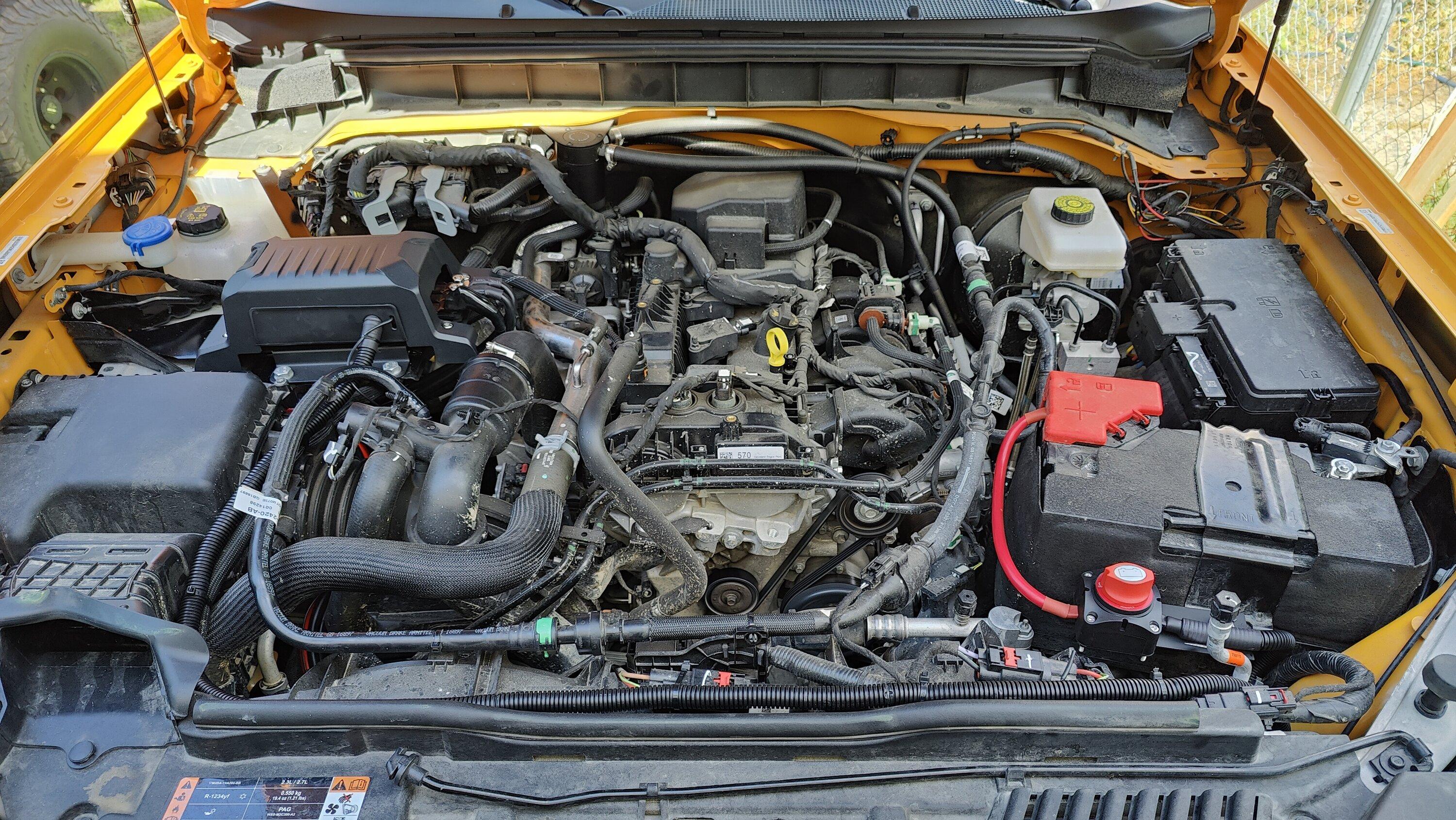

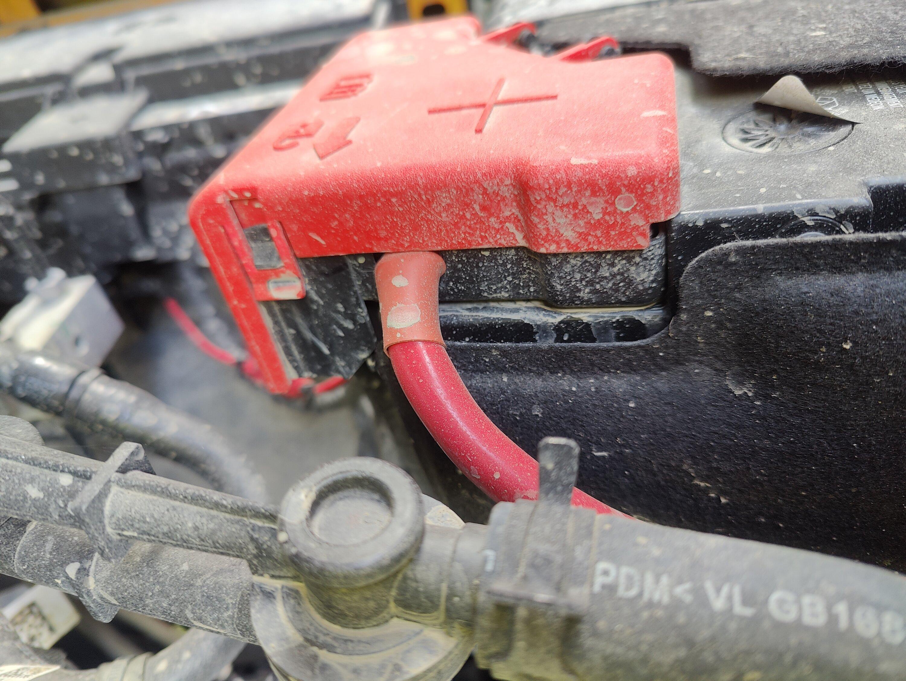

Can you show me your connection to the battery under the red cover and did you need to trim the cover?
Sorry for the late response, just got home from Drummond Island. I did notch the side of the cover (bottom black piece)

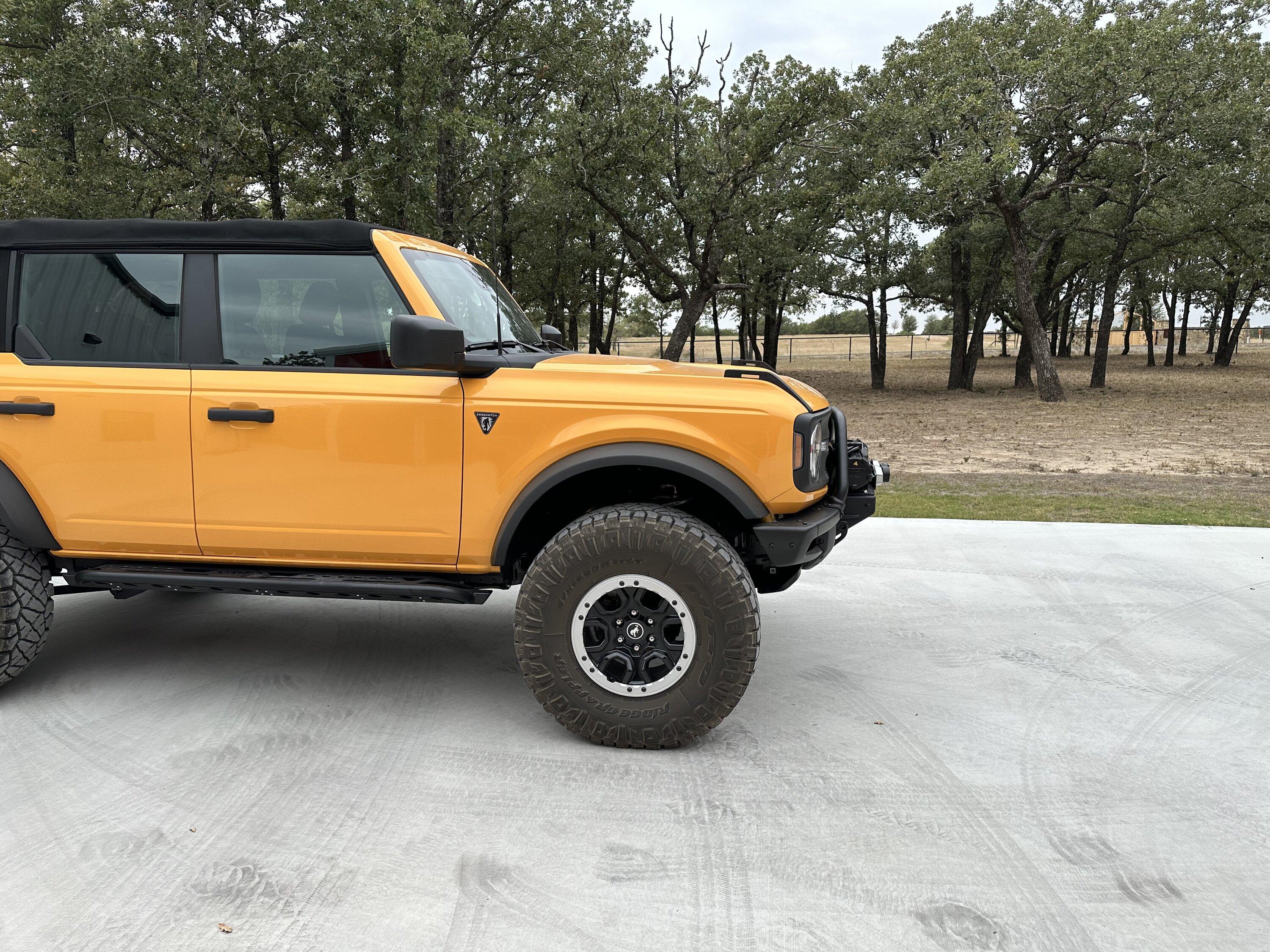

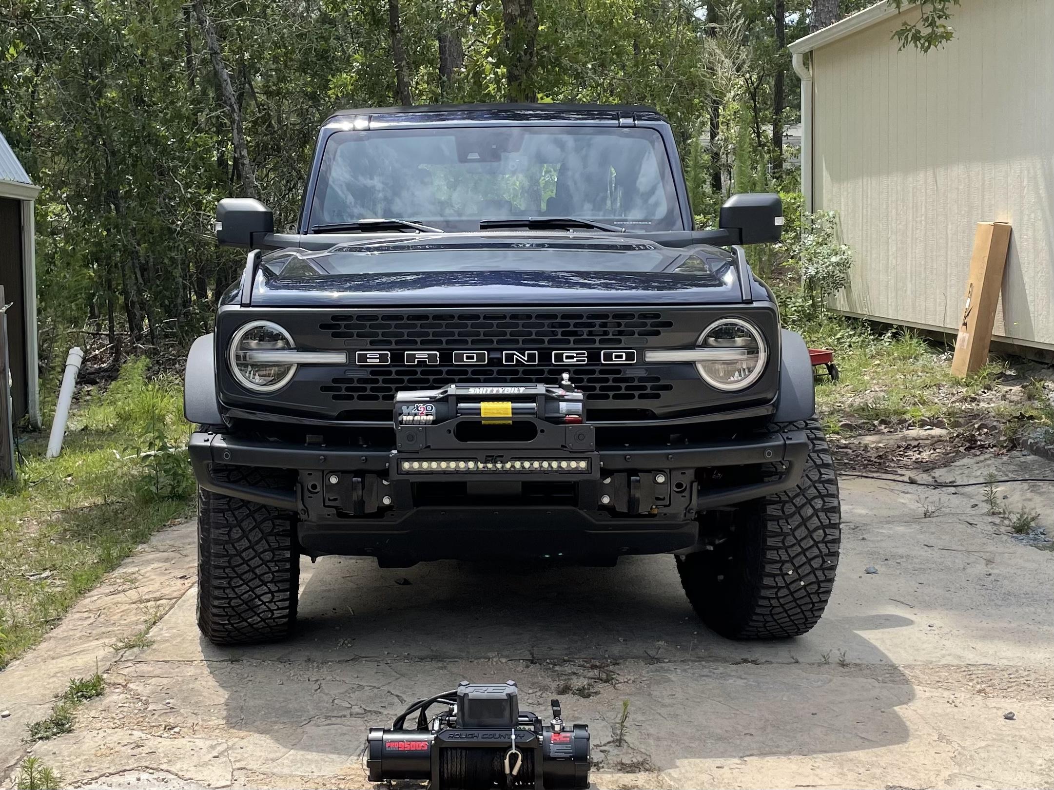

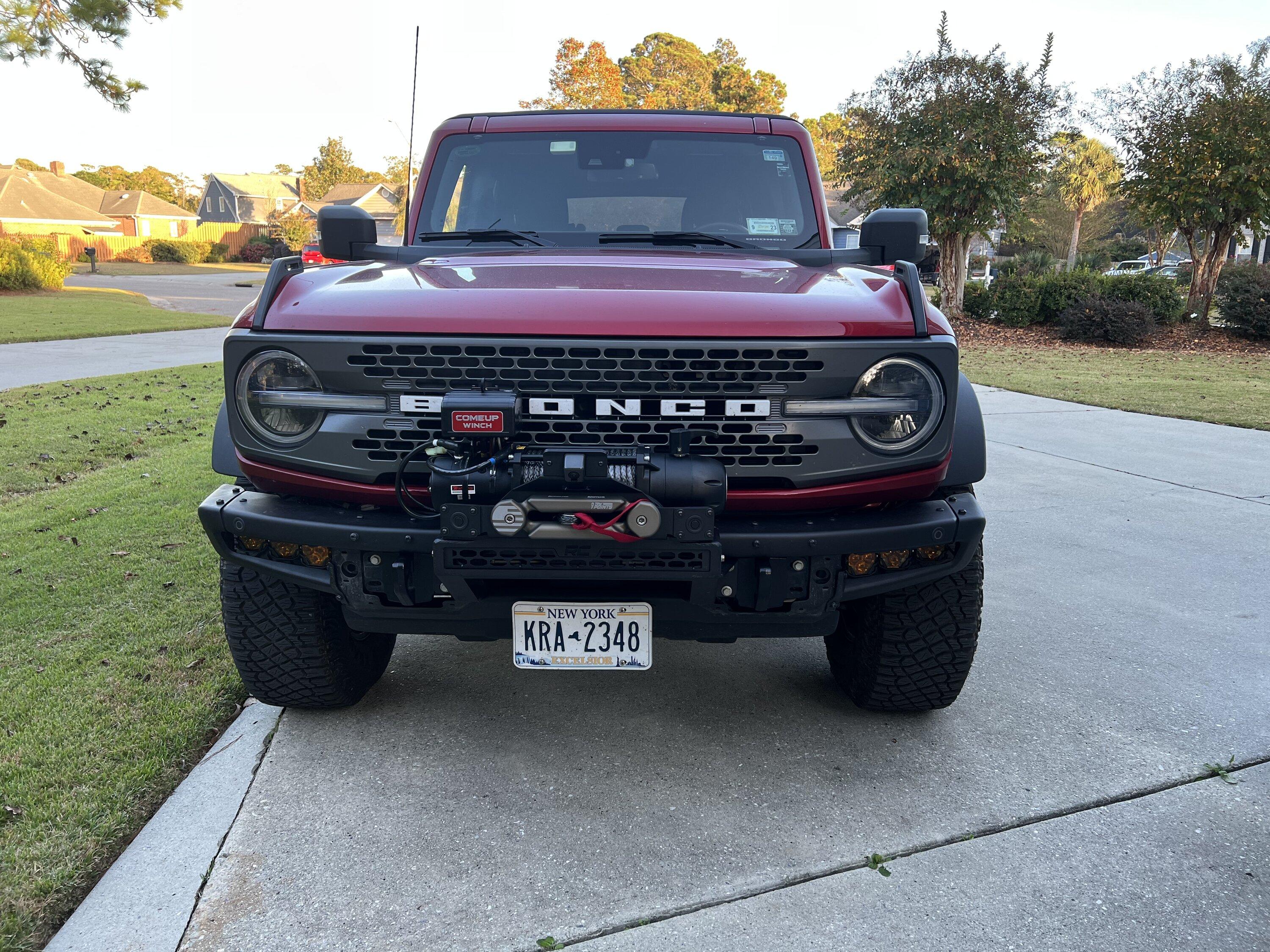

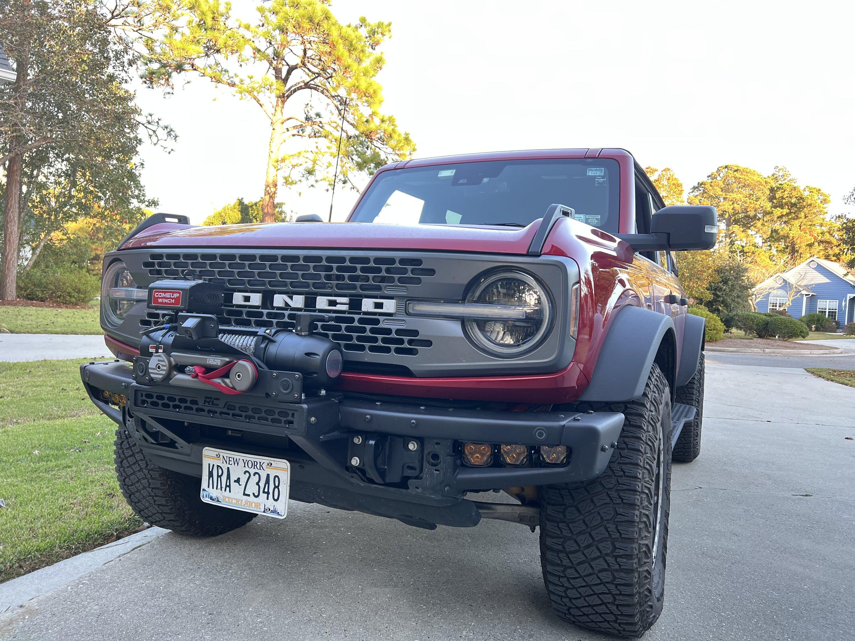

Went back and forth on the subject. Should I remove the modular bumper? Should I go with factory, JCR, Rough Country? Sorry Mabett. Your timeline to manufacturing is too long. I decided price was gonna be the defining factor. How far it sticks out, approach angle and other factors weren’t that different.
Rough Country High Winch Mount:
I will say the instructions aren’t that great. I found it much easier to install the bottom half of the mount first. was having a tough time balancing the weight of the mount and winch to attach it to the bumper. Mounting the bottom half gave me room to get my hands in there as well. Then I mounted the winch to the plate. I followed up by wiring it, then mounting the top plate to the bottom half. The instructions also call for shaving down the back of the sensor they provide. This was not the case with the winch I chose. I think each winch will differ in that step.
Smittybilt Winch:
Pretty cut and dry. I just wired the longer cables before I bolted the plate down. It’s tough to work behind the RC mount, it’s pretty tight to the grill. Removed all the decals and painted the “Smittybilt” and the switch for free spool.
https://www.amazon.com/dp/B00K150VAI?ref_=cm_sw_r_cp_ud_dp_X9K6SBMZCMGCJKQ54PAT

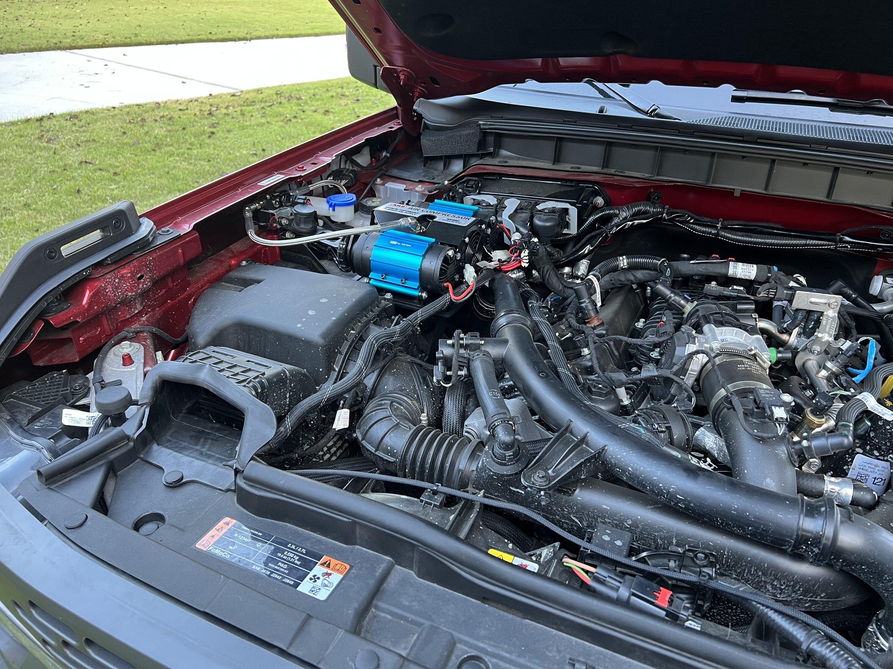

Control Box Relocation:
I decided to mount it to the lid of the fuse box. Was a simple install and it wasn't going to eat up space on the other side of the motor. Saving that for ARB compressor and maybe train horn. I used the Warn kit. Only needed the cables and black rubber boots.
https://www.amazon.com/dp/B00ANYN2G2?_encoding=UTF8&psc=1&ref_=cm_sw_r_ud_dp_R4PZ7CFEPPNMRR261BBV

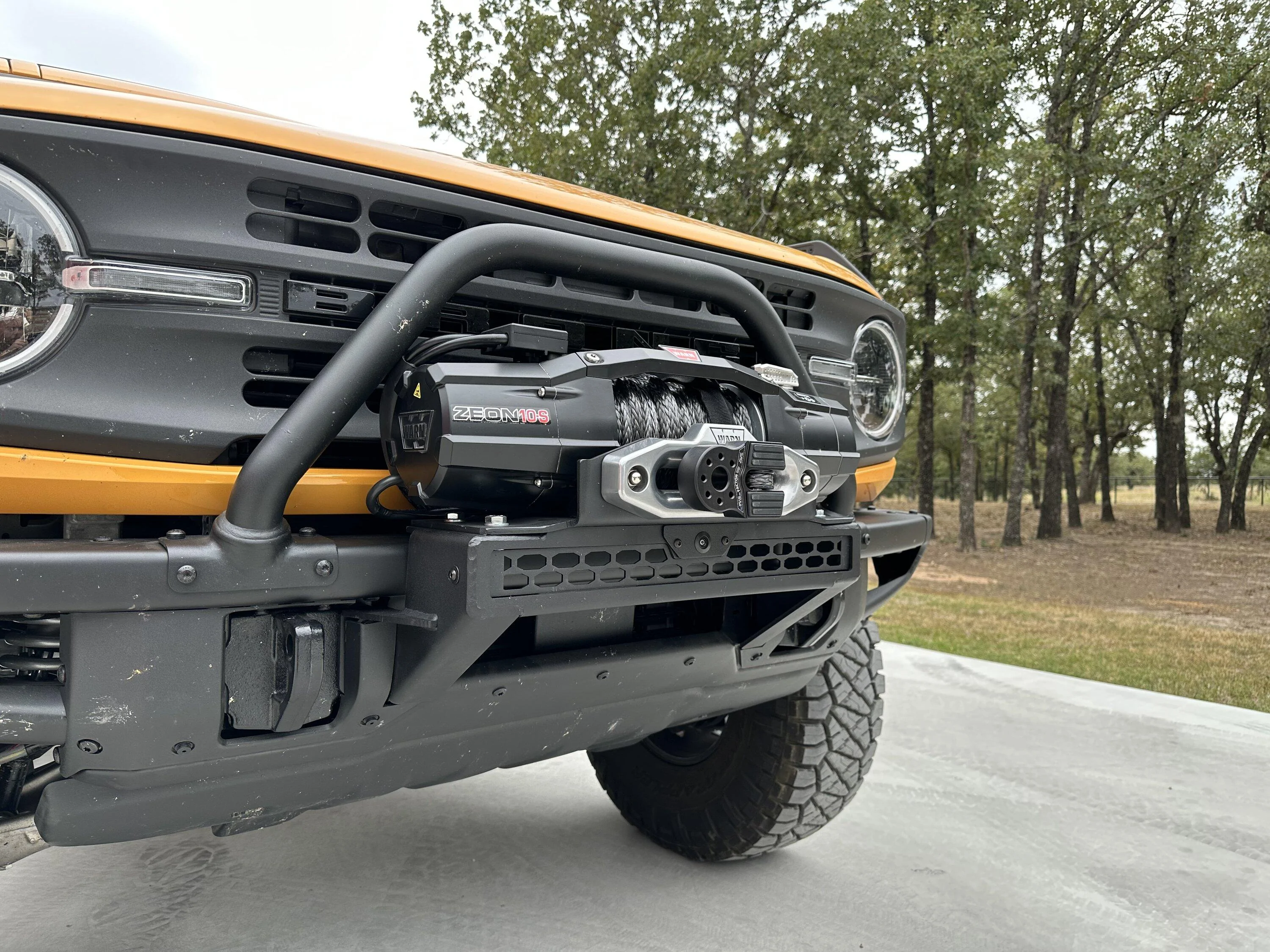

A few modifications on my install….
Removed the sensor brackets, cut out RC logo for front facing camera (Nakita), and installed Naviks box for factory screen integration.
RC really nailed the design on this one. Really works well with the mod bumper for a near OE look.

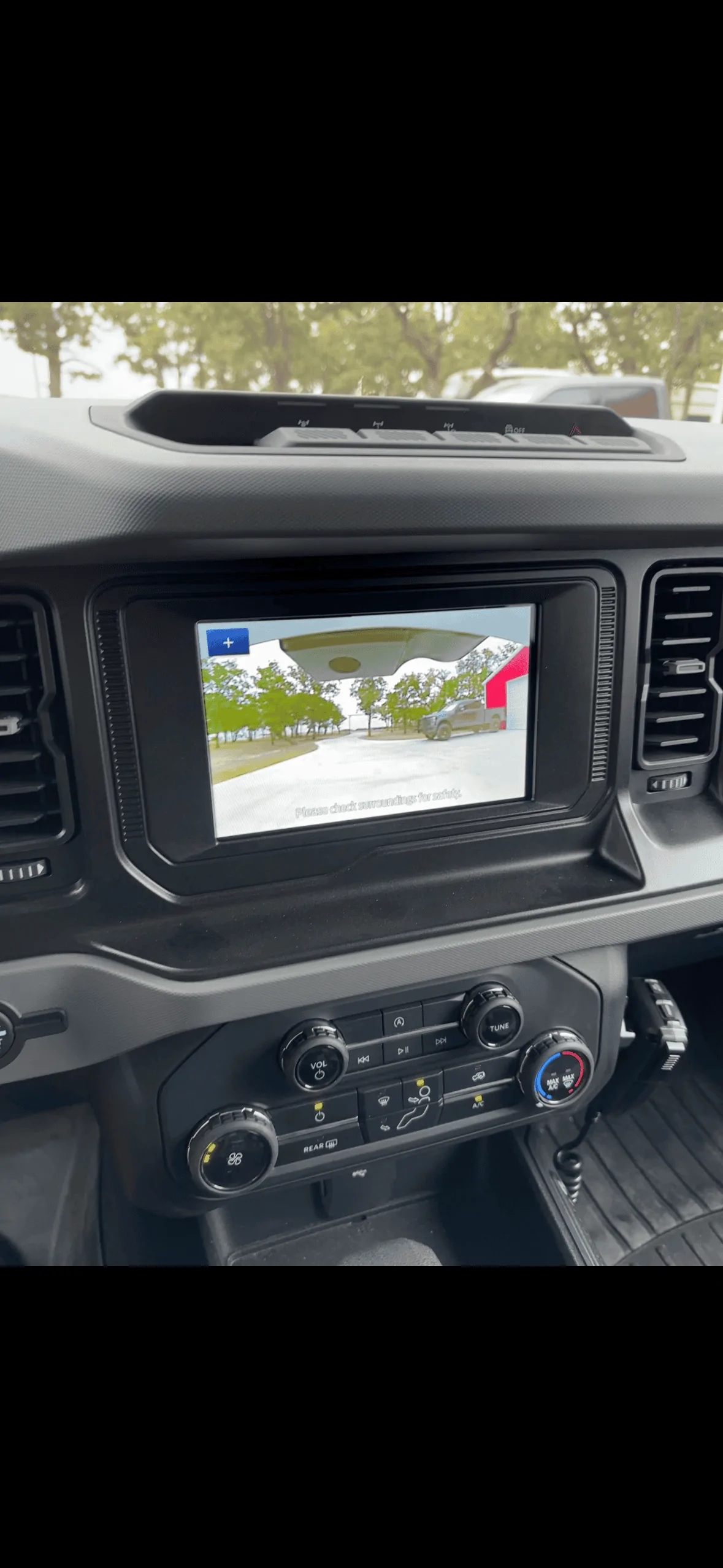

Any pics of what the camera view is? I'm definitely getting this mount and will be doing the camera relocation but was curious if it needs to be angled down or not. Your install looks flat.
cjindna
DC
Feb 21, 2022
76
174
2022 Base Sasquatch 4 door 2.3l 10spd
To be clear, this is an aftermarket camera (Nakita) on a Basesquatch. Using Naviks, I have the camera integrated into the factory screen.
Ford Bronco RC High Winch Mount & Winch Install w/ Control Box Relocation 859EE073-A845-4E27-8AD5-5DA9DBA54980
kevin.gt
Kevin
Oct 25, 2021
1,217
2,354
Canton, GA
Alright I need to hear more about the naviks. I saw the YouTube and I wasn’t sure they actually had the device working. Any glitches? What activates it? Does the head unit natively switch to the video stream when you power up the front camera?
cjindna
DC
Feb 21, 2022
76
174
I should probably start another thread there but…
So far the Naviks box has worked flawlessly. The supplied harness has the trigger wire for the camera built in. The front camera is activated by holding the instrument cluster menu button for 7 sec. There is an audible beep when engaging and the camera pops up on screen, stays on at all speeds and gears (less reverse), until you hold the menu button again to disable.
Pain to install given the dash has to be disassembled quite far to access the interface plug, otherwise very happy with the Naviks box and Nakita camera.

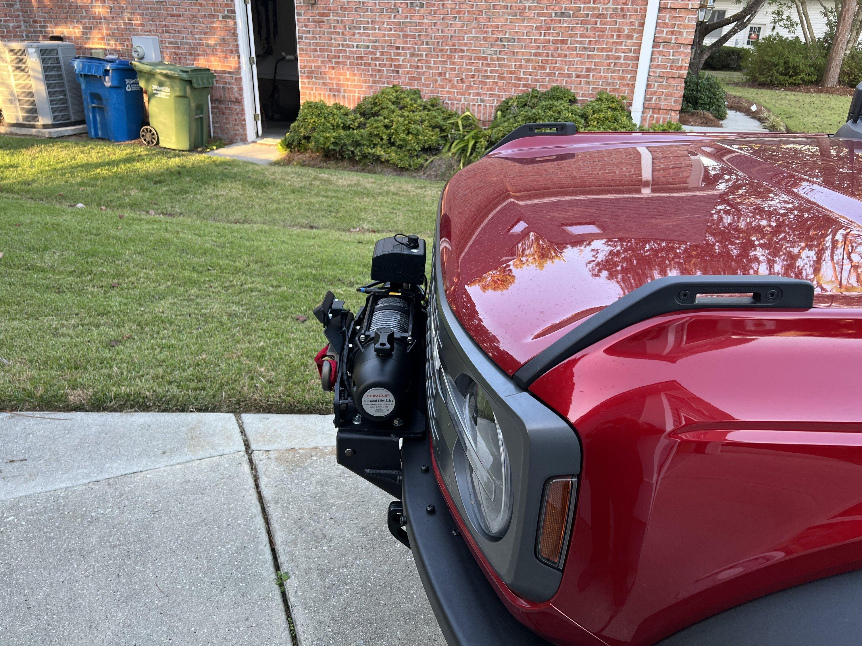

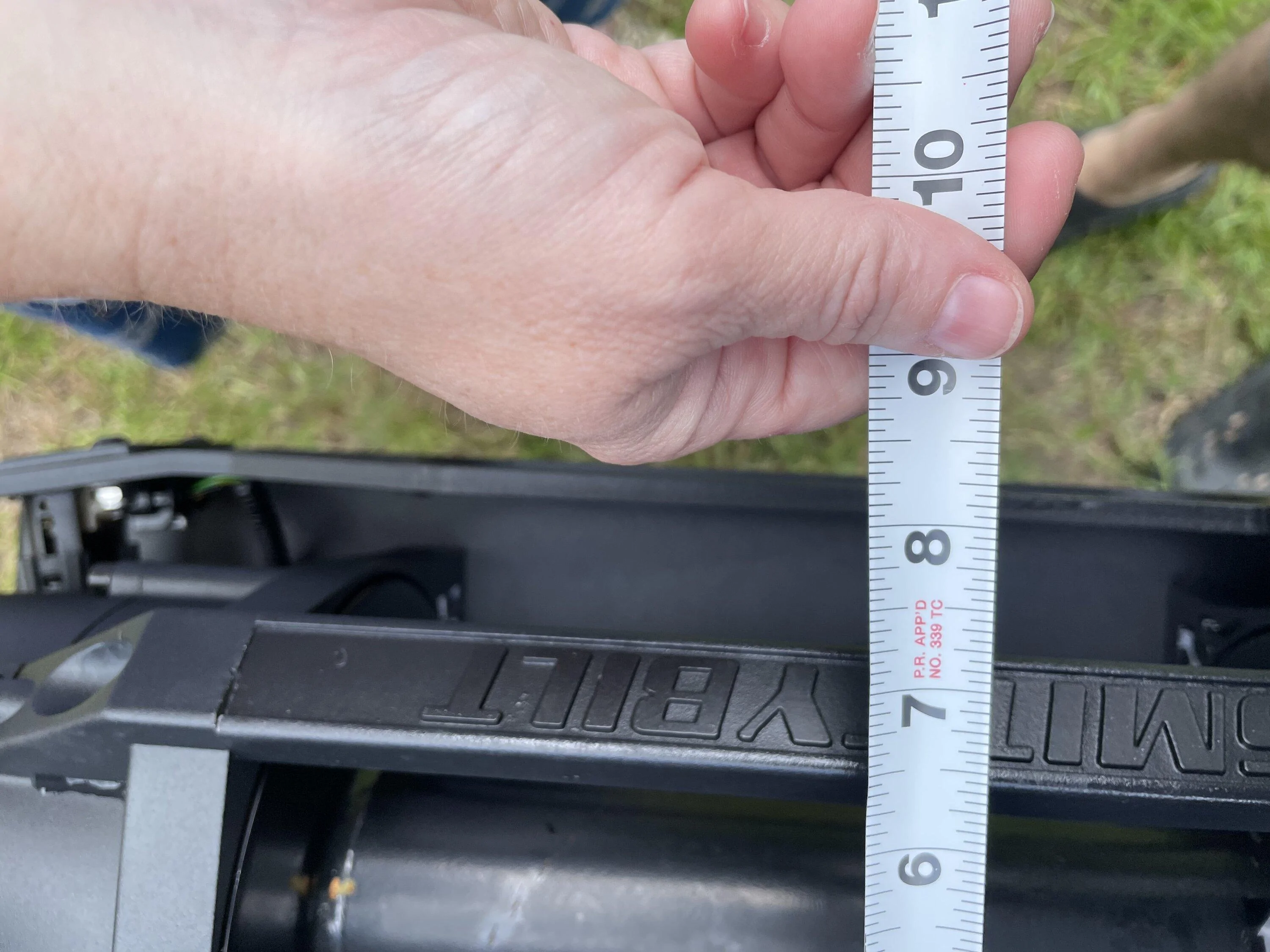

Not sure why you would know this but worth a shot. Do you think your set up would work with the pre runner from TC Bronco? I can not find out how much space is between the bottom of the crossbar and top of the bumper but feels like it would be close to working.

I can’t be 100% sure, but i have a few shots with a tape measure. It for sure has to be 7.5” from the grill TL the back of the bar. Check my photos for the other measurements.

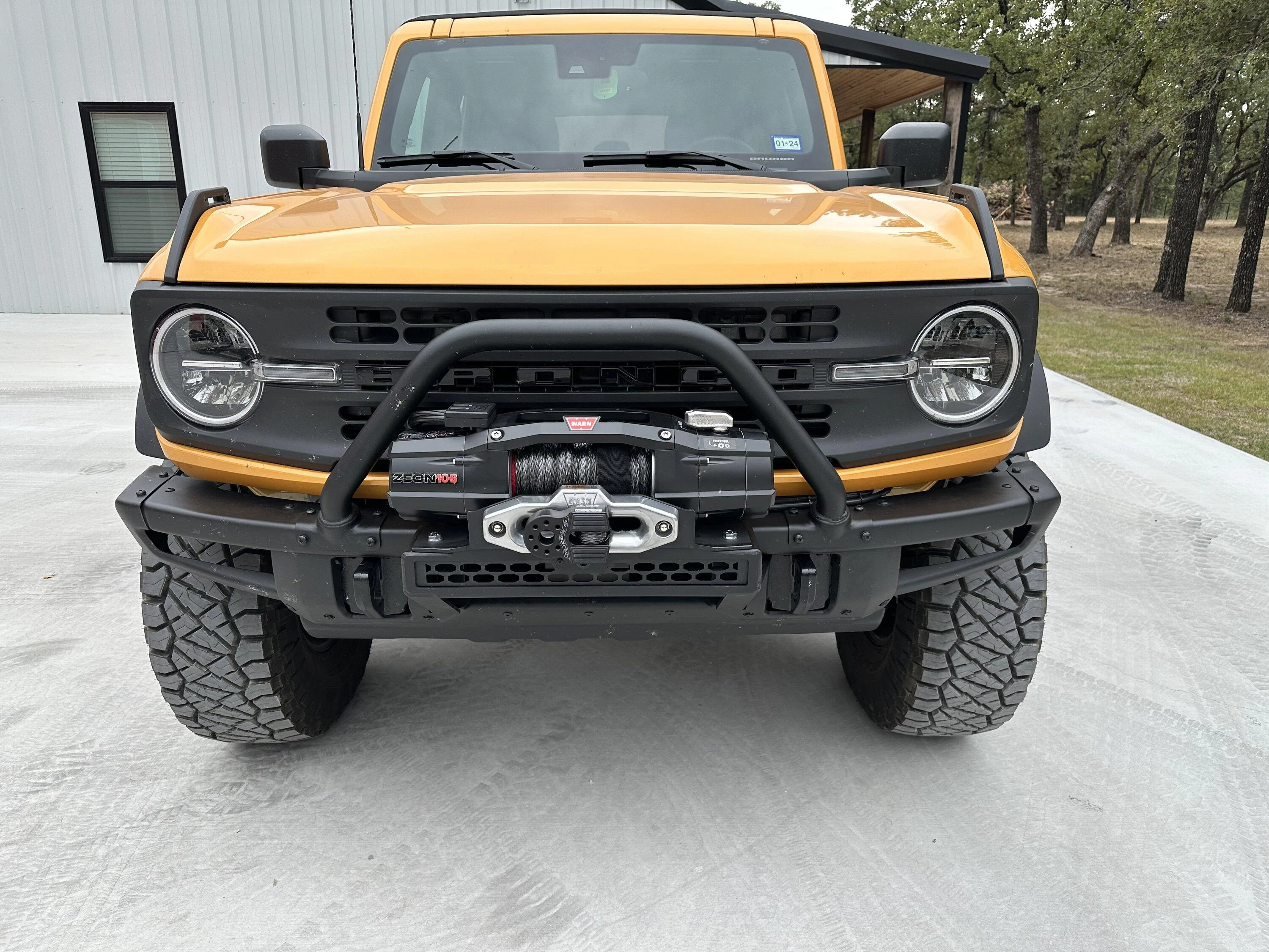

I installed the RC high mount last weekend . I went with the comeup seal slim 9.5. It fit great without having to trim down the sensor holders.
I didn’t have time to trim the plastic bumper trim caps. That will have to wait until my next visit.
i used the JCR camera relocation and yankum ropes fairlead. I removed all the metal and carry a couple soft shackles.
Oh, I need to pretension the line, too.
Edit: Badlands Sasquatch LUX. Parking, ACC, lane keep, and all other sensors work.
