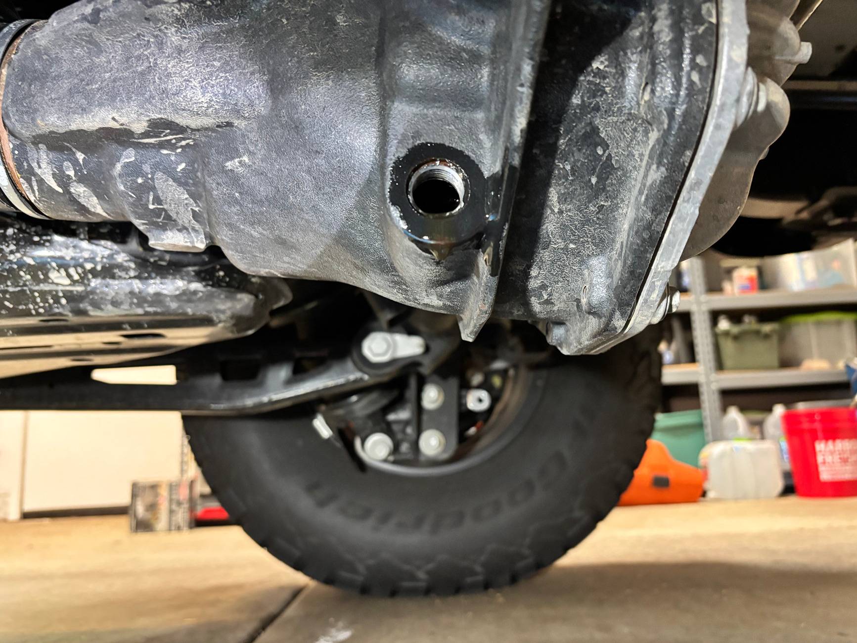

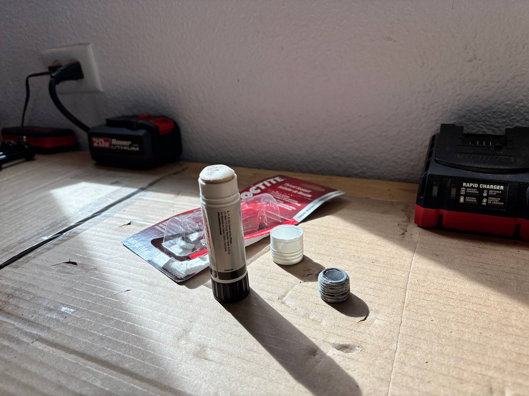

Did my first rear axle gear oil change today, super easy with drain plug on the Raptors Thanks to @Finbox

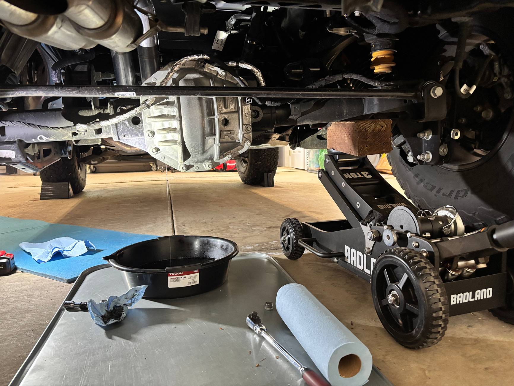

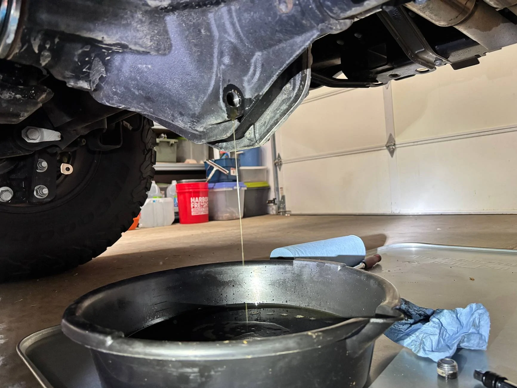

To get all the gear oil out I jacked up the passenger side a bit so fluid would drain what remained...make sure and put on parking brake and chock your tires when doing this..
I used Loctite thread sealant on both plugs....go easy on tightening the plugs especially the fill plug that goes into the aluminum fill cover, dont torque em, u will feel when they are just snug.

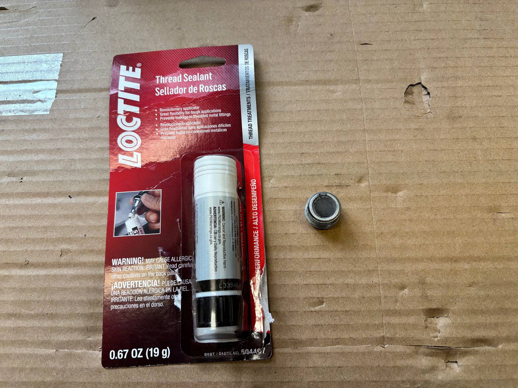

Loctite thread sealant in stick form....easy to use less messy
