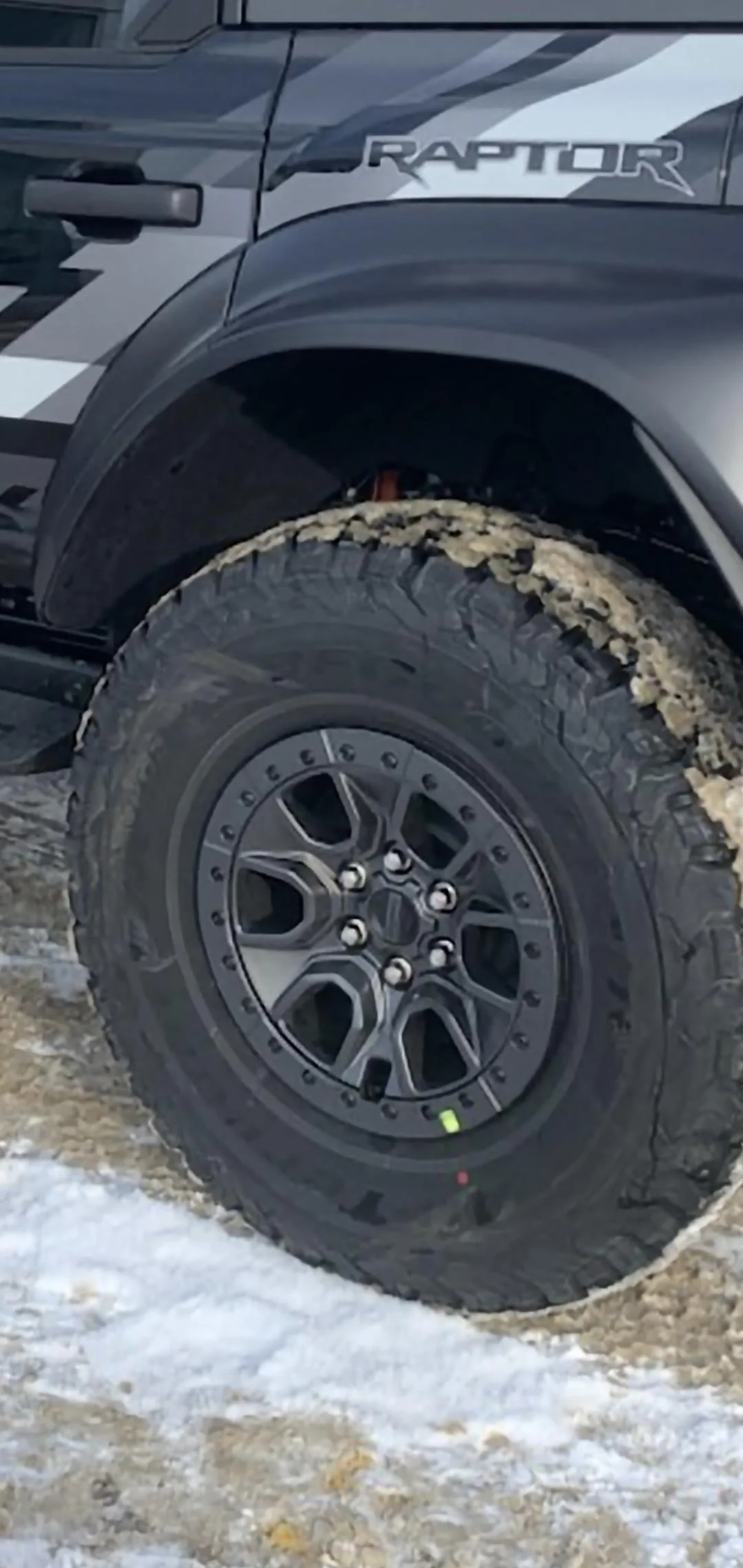

My 2022 Braptor has the beadlock capable aluminum wheels. 2023 Braptor no longer has these particular wheels as an option. The 2023 has the regular and Beadlock capable forged wheels. Wondering if the wheels i have on the 2022 have been discontinued or constrained.

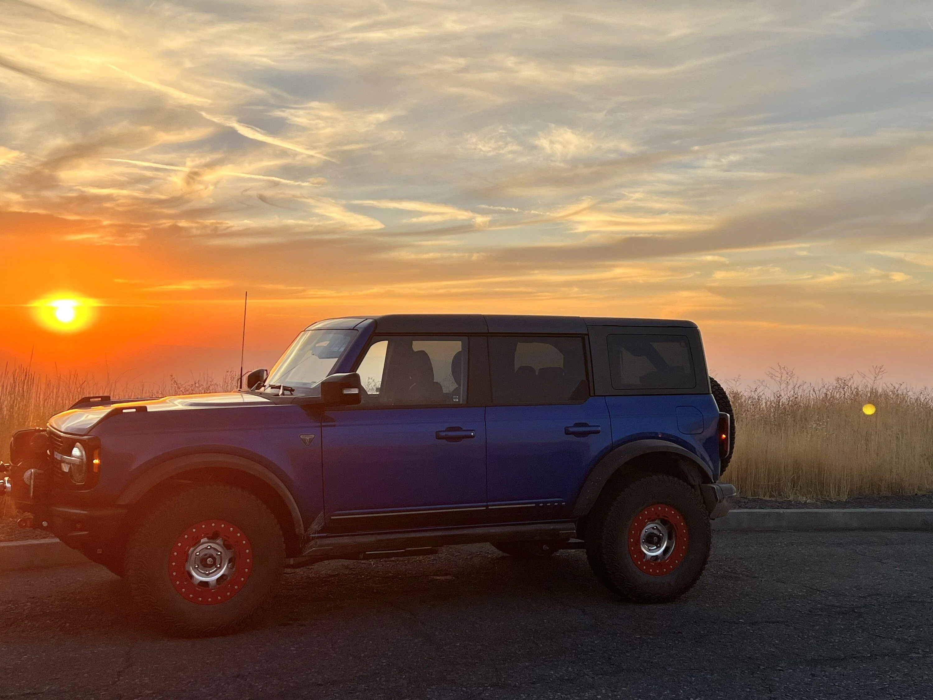

Over a year running real beadlocks no air lost and nothing needing to be torqued (although I do check every few months) I was met out with a digital torque wrench and Ted-Gel
Some reasonably hard wheeling I assume?
Can you clarify the bold part (typo maybe)?
chtucker
Nov 24, 2019
184
2,153
4,070
Kirkland, WA
FJ Cruiser
Darn tiny keyboards on the phone
I was meticulous with a digital torque wrench and Tef-Gel
Digital torque wrench that read down low https://www.acdelco-tools.com/index.php?route=product/product&path=61_87&product_id=131
And Tef-Gel anti seize
https://www.tefgel.com/contain.php?param=tefgel_infor
I did 4 rounds of torquing 5lb, 10lb, 15lb and 20lb in a star pattern.
Mind you my wheels are aftermarket.
Did I need them, Nope, was a I scared of doing them Yep. Would I do it again, Yep. I hate "faux beadlocks" just for the looks. It was either nothing or beadlocks. I looked into Hutchinson Rock Monsters, but at the time they wanted $7500 for a custom set.
I was able to get a very specific offset and hub centric wheels without hub bore adapters. I have about 18mm of offset. I didn't want poke.
