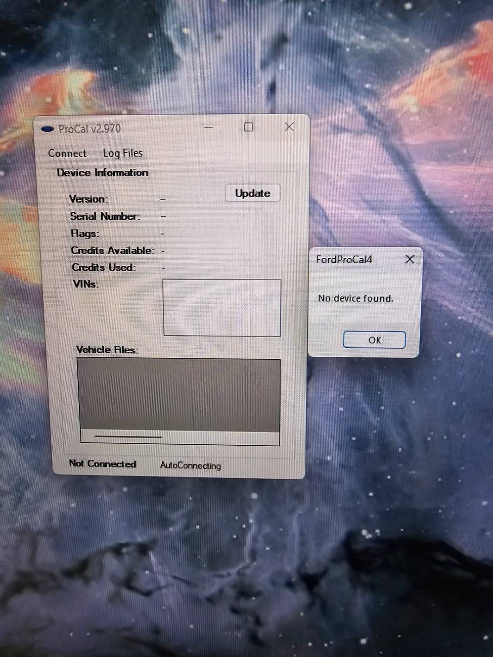

Yeah it doesn't seem to do anything. Hitting connect gives you the three options, and when you hit auto it just says device not found

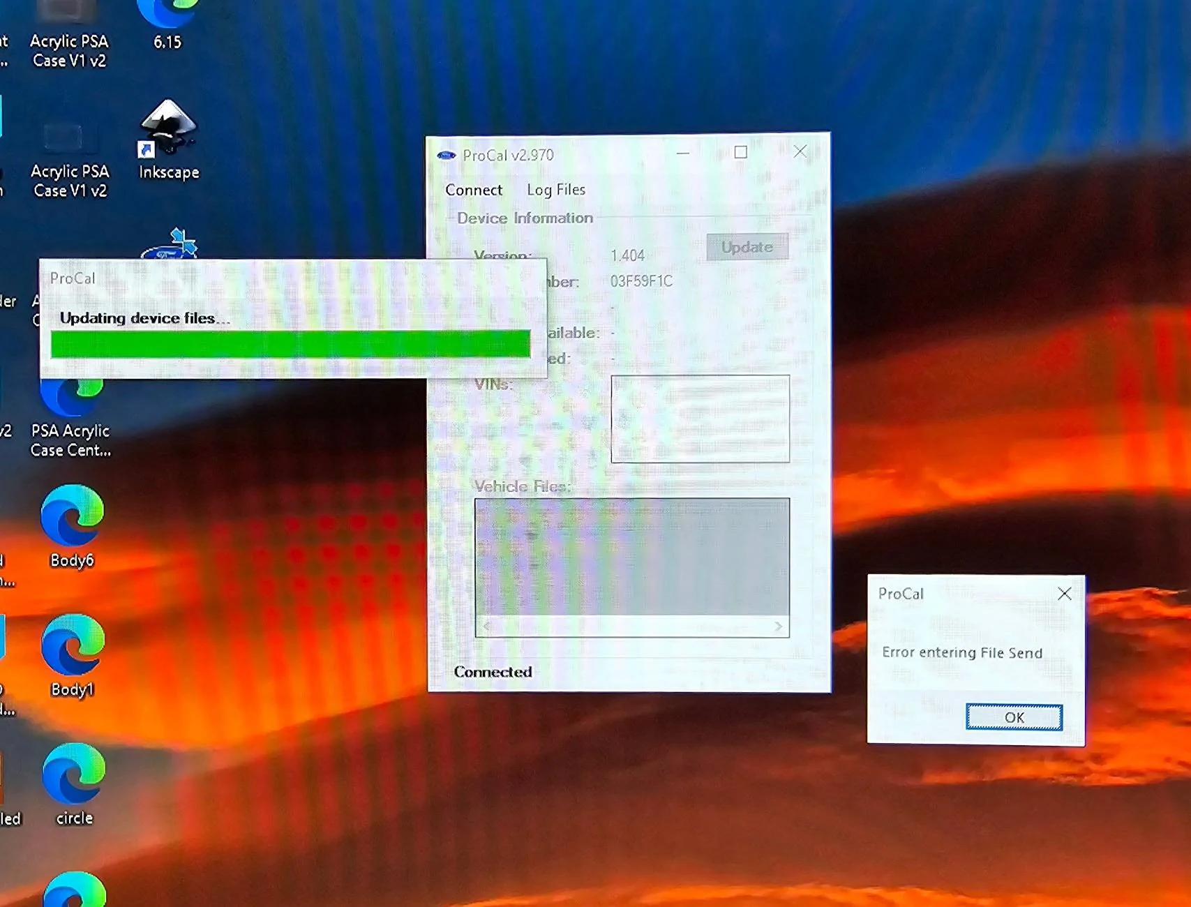

Got a little bit closer on a work computer, it atleast pulled some info from the device.
Says "Error getting registry" now though

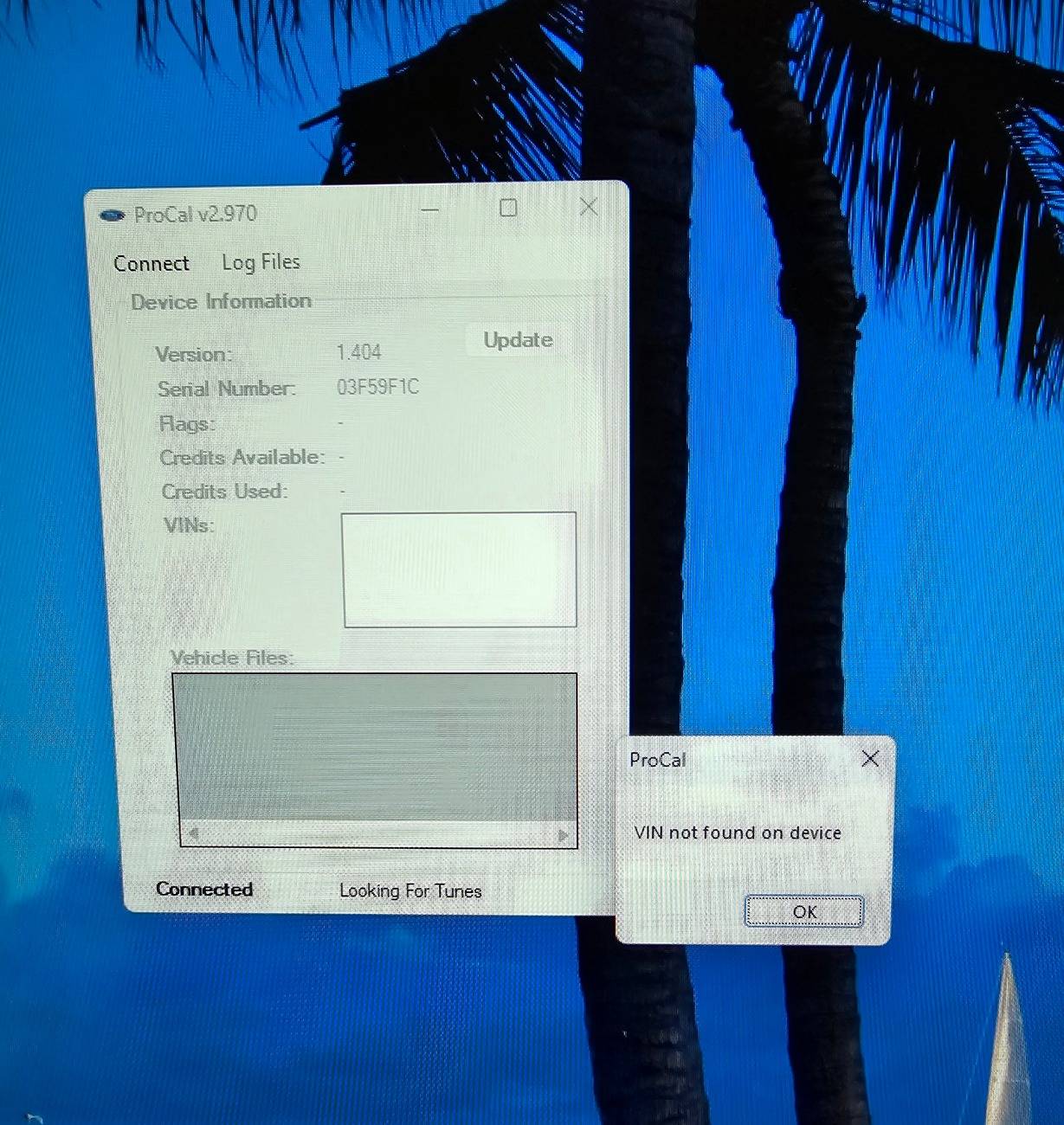

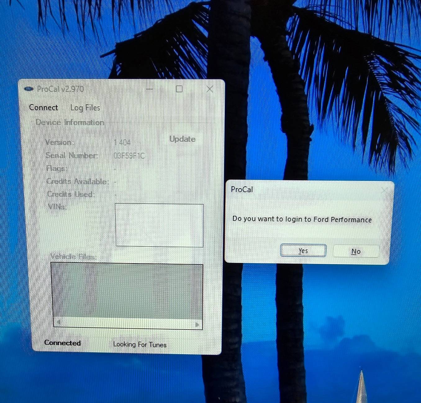

I called Ford Performance around lunch earlier and of course they've never seen the errors I'm getting. He asked for some screenshots so I sent a few, but haven't heard back yet.
At this point I've tried 3 different computers, 6 or so USB cables, and nearly anything I can think of.
I'll randomly get it to connect, but it won't do anything from there that doesn't lead to another error.
Here are all that I've gotten so far.
