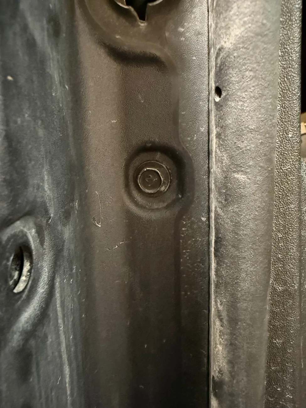

Hello, I finally just got my new tail lamps in the mail and I’m trying to remove the weatherstripping for my bronco. I use a trim tool with the Philips screwdriver to remove the weatherstripping and it does not budge at all and it’s stripped the bolts and now I don’t know what to do and I’m getting extremely angry when it was supposed to be an extremely easy install please help me. THE SCREWS STRIPPED IMMEDIATELY WTF
i spent 2 hours on it and cant even remove a single one of these screws. Are these fking screws plastic?! Who designed this?! All the online guides make it look like it comes off easy but it doesnt even move! Im EXTREMELY MAD

Get a pry tool behind and put a little pressure on it then lightly loosen the philips screw. Once you get it out you'll see how stupid those are and why they don't screw out. If you can get the head of the screw out, just pry it out then the other part.

Then get a razor blade and try to get the screw head out enough to get your pry tool behind it. Pry it out then the other part.

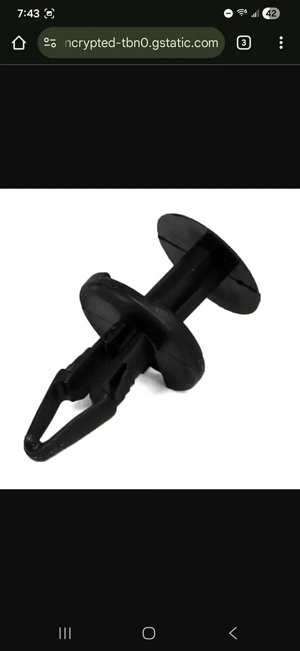

Are you using a forked prying device like this?

Don't push into the Philips head hard at all. Just lightly put pressure on screw. There's not enough thread engagement on the screw part. Thats why I said to pry on the part the screw goes into to put more pressure on the threads so it threads out, but you can't put a lot of pressure on screw or it just spins...

Like this? Trust me man ive been doing this for literally 2 hours now. WTF

Take her easy. It's basically just a push pin like this...
Ford Bronco Problems with installing tail lamps Screenshot_20251219_194314_Chrom
...but threaded. Get a razor blade and pull the head out enough to get your pry tool behind the Philips head and pry it out. The screw part of them is a joke, just pry the center out, then pry the other peice out.
