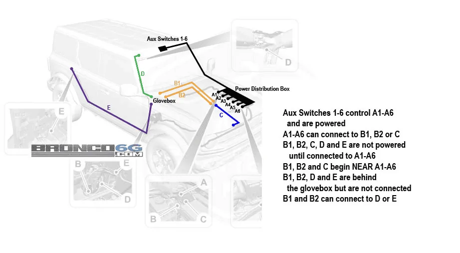

Regarding wiring - you will not have the wiring up to the top of the dash where the sunglasses holder is. And you won't have the upfitter panel under the hood - those are part of what you would need to buy ~if~ you wanted to go OEM. All the black wires in the diagram - you won't have.
But there are 5 wires that are pre-run that you will have -- B1/B2/C/D/E. They don't go to anything at all - just pre-run wires in some convenient locations.
