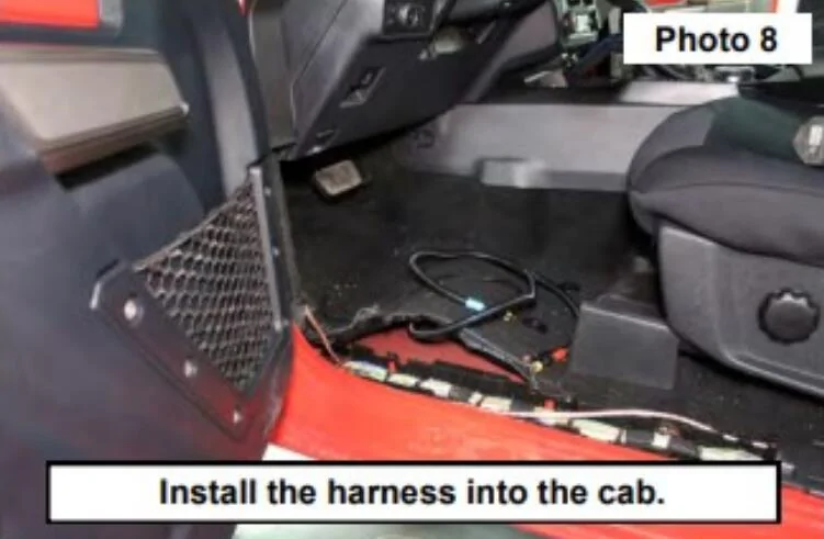

I'm *was* installing these today but hit a snag.
I don't see how to run the wiring harness in to the cab. It says through the rubber grommet in the floor of the driver's seat area. It looks like in the photo they mean the drain plug.
The problem is, there's a heat shield immediately on the other side of the body there on my Bronco. And 1" from that heat shield is the catalytic converter.
I think I can fish the wires between the body and the heat shield, but the only way to come out is towards the center line of the bronco. I then have to get those wires towards the pinch weld by going over or under the catalytic converter/exhaust to plug in to the controller mounted to the inside of the pinch weld.

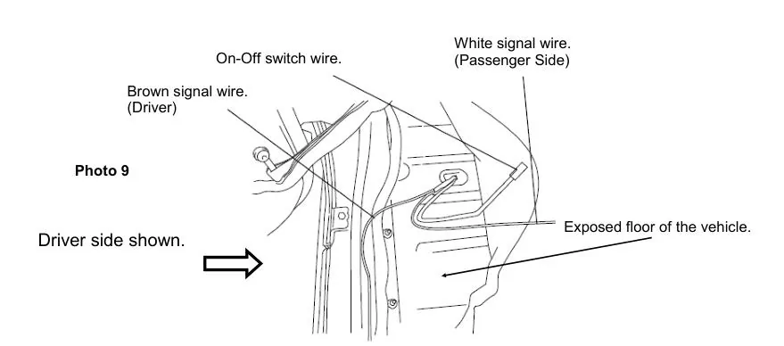

I know at some point the instructions changed...
This is what I got with mine:
https://s3.amazonaws.com/roughcountry/install/Ford Bronco Eboards.pdf
But I also found this online:
https://s3.amazonaws.com/roughcountry/install/PRS51330.pdf
That second one is very vague. "Insert the wiring harness through the access hole in the floor on each side of the vehicle"
In mine it says "
11. Lift the carpet to expose the rubber grommet on the driver side. Feed the brown signal wire,
white signal wire, and On/Off switch wires through the rubber grommet."
Both use the same photo:
Which sure looks to my like it's coming from the drain plug.
Ford Bronco Power steps - anyone install? 1743897206370-rg
And the next step specifically says drain plug.
"Install the supplied wiring harness’ Brown, White and On-Off switch wire through the grommet in
the drain plug under the floor of the vehicle to the inside of the cab. See Photo 9"
Problem is that photo 9, is not a Bronco.

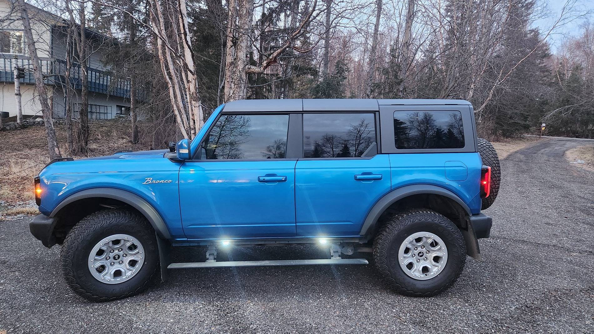

I'm over 2 years with the GoRhino power step boards, one of the best mods yet for me.
