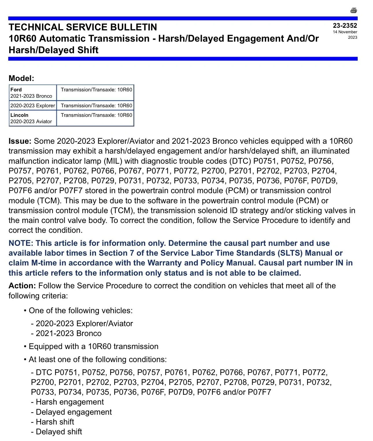

When I intentionally press it, it is quite noticable, this has randomly happened twice. I'll have to pay much closer attention, but there are a few examples of what I am experiencing. There seems to be a bulletin about it to reprogram the trans.
@flip or @Ducati1098 - ring any bells?

Ford Bronco Potential Transmission Issue? IMG_2751
This is the common TSB for generic 10R60 shifting concerns. Iā€™ve never seen any of the issues outlined in this cause the gear indicator to illuminate, but It certainly couldnā€™t hurt having your dealership look into it or to have them update the PCM to the latest calibration.
