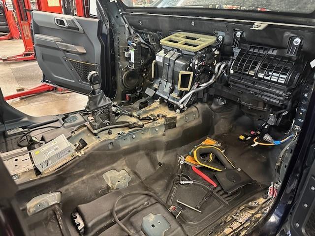

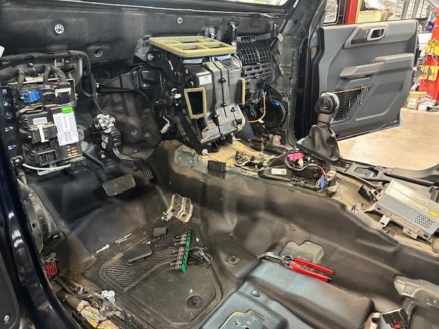

There are specific environmental conditions where you might see some water vapor coming from the vents. Humidity, evaporator temp, blower speed align and the result can be a vapory discharge from the vents. Doesn't hurt anything but makes you wonder if the evaporator or heater core is going bad.
Since you're also getting a smell, there is the possibility of a leak. If it's a slow leak (heater core) you likely won't see much in the way of coolant loss in the bottle or drips from the exterior drain tube or on the floor. If it's from the evaporator, you'll likely notice the air coming from the vents is not as cold as it used to be at the same temp setting or may not kick on at all. When it loses too much freon, it may not even kick on due to lack of pressure in the system.
Not sure if either the core or evaporator are visible from the pollen filter, possibly if you have a scope. The a/c may already have a UV dye in it from the factory to help technicians find leaks but don't think the cooling system does. If either are bad, the repair looks like this and is expensive.
Ford Bronco Possible Heater Core issue? heater case1
Ford Bronco Possible Heater Core issue? heater case2
Unless you have an extended warranty, both the heater core and evaporator are no longer covered since you've exceeded the 36,000. That said, Ford does look at situations like this on a case by case basis. There are several factors that go into the decision to assist or not assist which I don't even have a good grasp of so there's no need trying to explain it. The first step is having the vehicle diagnosed by a dealer, verifying there is a failed part. The dealer can open a case with Ford on your behalf asking for assistance but only if they want to. You can also call Ford's customer assistance number, explain the issue, mileage, repair estimate and they will start a case and contact the dealer. This sounds harsh but the dealer can still decide they aren't going to help with assistance since it basically turns the repair into a warranty claim which pays at a much lower rate than customer pay. Each dealer is different but most seem to participate, especially if the dealer sold the vehicle and you do routine service work with them.
