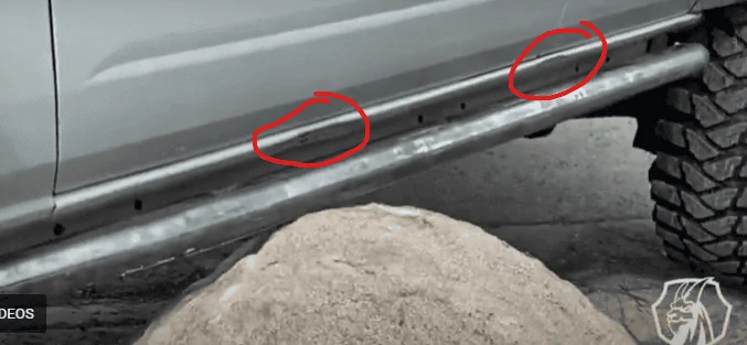

This video actually makes me even more against the body mounted rails. Throughout the whole video you can see the rail is actually bending up making contact with the body. I don't like that at all. I've had some very hard slams coming off ledges and I really think I would have had some body damage with those.
The stock rails are tucked under and there isn't nearly as much of a lever. With these rails coming out, there is a lot more torque being applied to the mounting locations.

Incorrect, watch the vids in slow motion... Where does it make contact? It is not "bending", it is flexing along with the body, and there is NO body contact ever. Watch RCI's vids, theirs flex just as much, but no body contact is ever made.

You can actually see that something has been into the rocker in multiple places on that Bronco

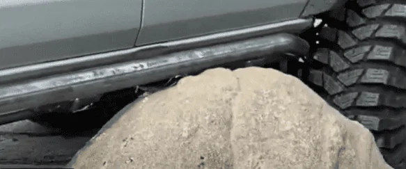

And if it's going from that much gap (above) to this much gap (below) it's hitting something on the body. The pinch weld, the rocker, somewhere it's making contact.
Obviously those dents were already there, they abuse the heck out of their truck on the trail and in testing. You would need an extremely sharp flex to do that from the slider, where it would not return to form. Not possible from physics and the entire unit flexing as a solid piece. The whole rocker would be caved in, not a few inches in 2 different spots... You can inquire from @GoatFab further if you like.
2nd pic, it doesn't touch, you must remember your' viewing from a near completely horizontal view, not overhead. Did you watch the 2nd vid?
https://www.bronco6g.com/forum/threads/goat-rock-sliders-now-with-top-plates.51982/page-2
To each their own, I have no skin in it, but I'm an extremely detail oriented and analytical person and did my research. Up to you to do your own.

Sorry but those dents were done before sliders. Those are actually from forks from a hi-lo There are now 100's of sets in the "field" now. Not a single issue with these deflecting or Bending. We have tested extensively.
We are not going to offer something that hasn't been tested. Why would we offer something that bends deflects or breaks. That is not a business plan that will work.
My goal is to offer the strongest slider/step on the market.
We do also offer a weld on to frame version should you think you need it. (90% of people dont) even those that wheel hardest trails and rocks.
Thanks
Adam

Ya, I didn't really mean to imply that the rails in the video caused those specific dents, more that the rails weren't doing their job if the damage happened with them on. I got sidetracked and I kinda ran the two points I was trying to make together so that's definitely my fault for the misunderstanding.
So I do still have concerns with the amount of flex I see in that video. It's not your rails that are flexing, it's the sheet metal body where they mount. The factory rails are much shorter and I'd be surprised if Ford factored in adding several more inches of a lever in their engineering of that mounting point (for use with steps yes, more than likely not for bouncing sideways off a tree).
I mean the same could be said for a frame mounted set of rails, but at least the frame is structural and not stamped sheet metal.
I hit a tree so hard with my frame mounted rails a few months back that I was concerned that I bent the frame. I have no doubt in my mind that those body mounting points your rails use would have had permanent deformation, no doubt.
For me it all depends on how much protection you want (and want to pay for). Are these better than the stock rock rails, sure, are they going to suit the needs of a more extreme rock-crawler, probably not (which is why you also sell a weld-on frame mount set).
