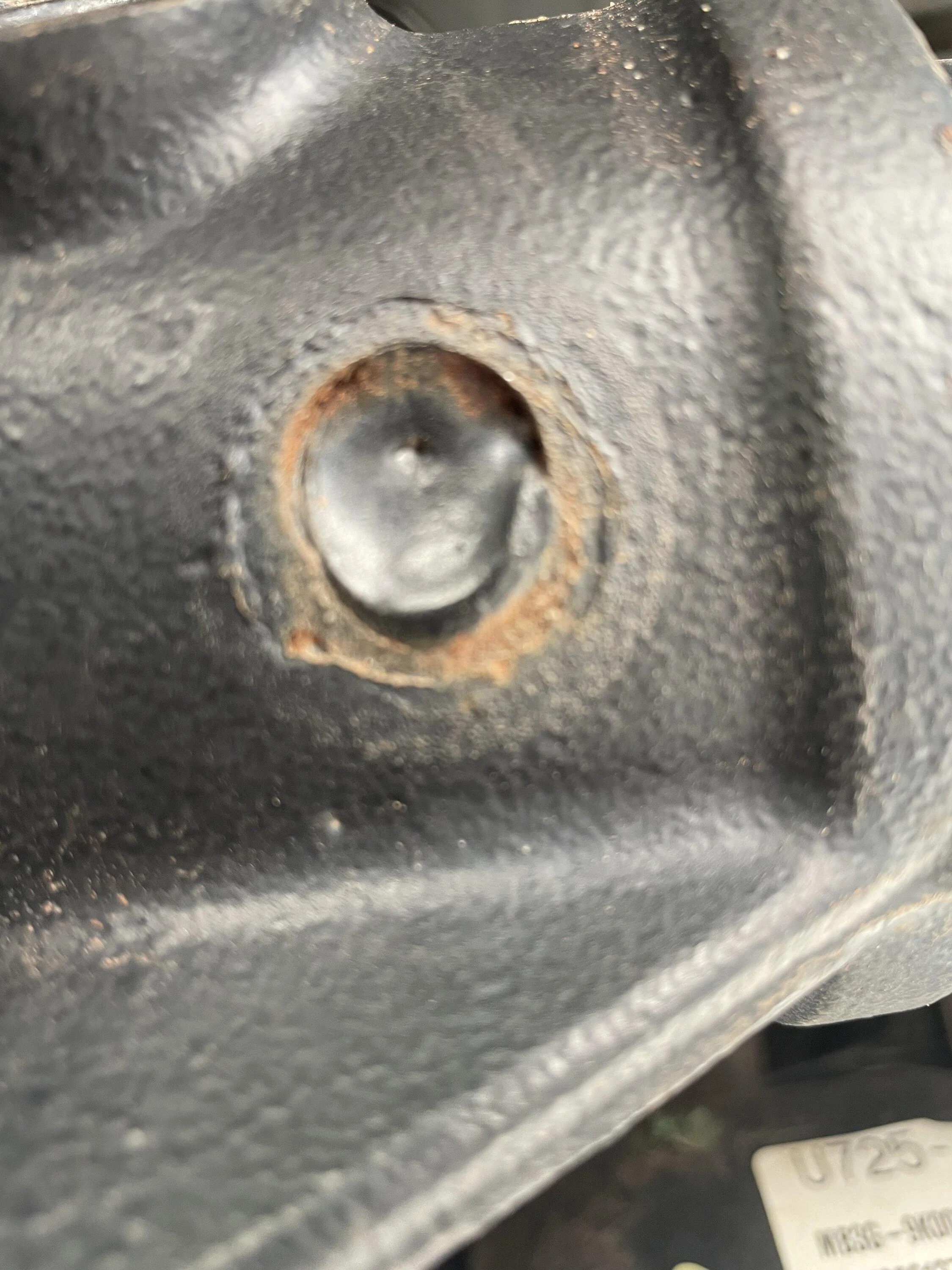

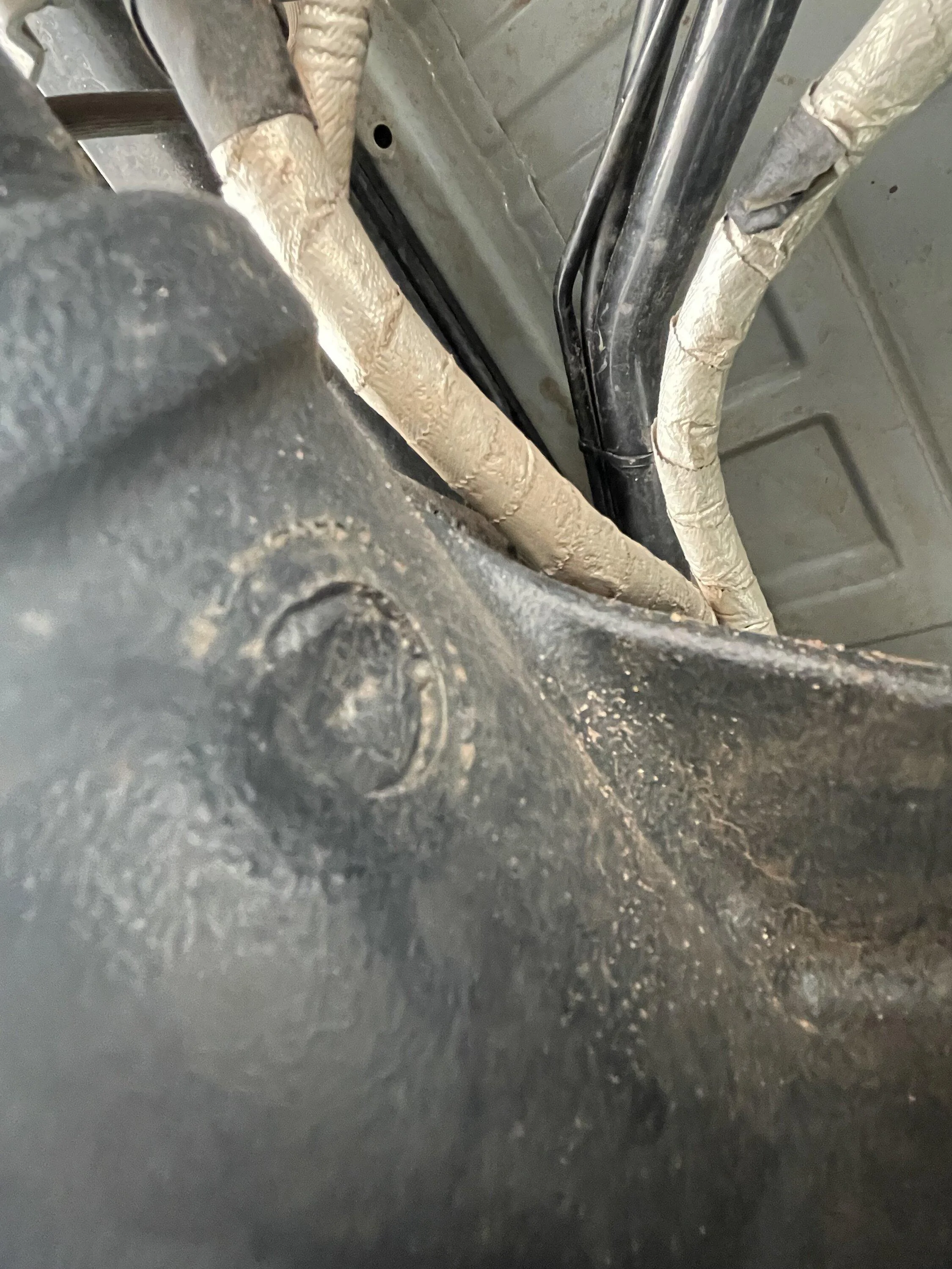

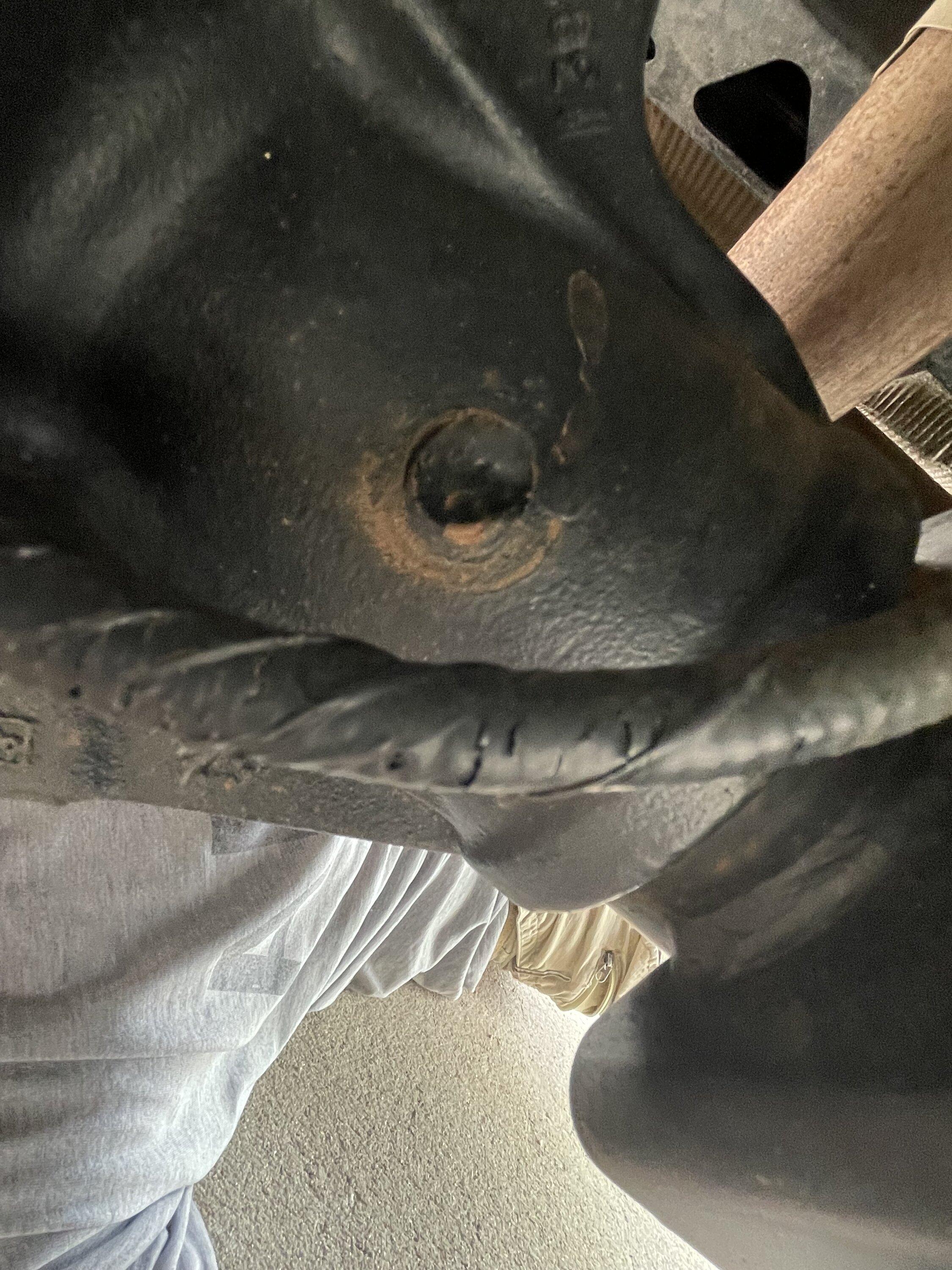

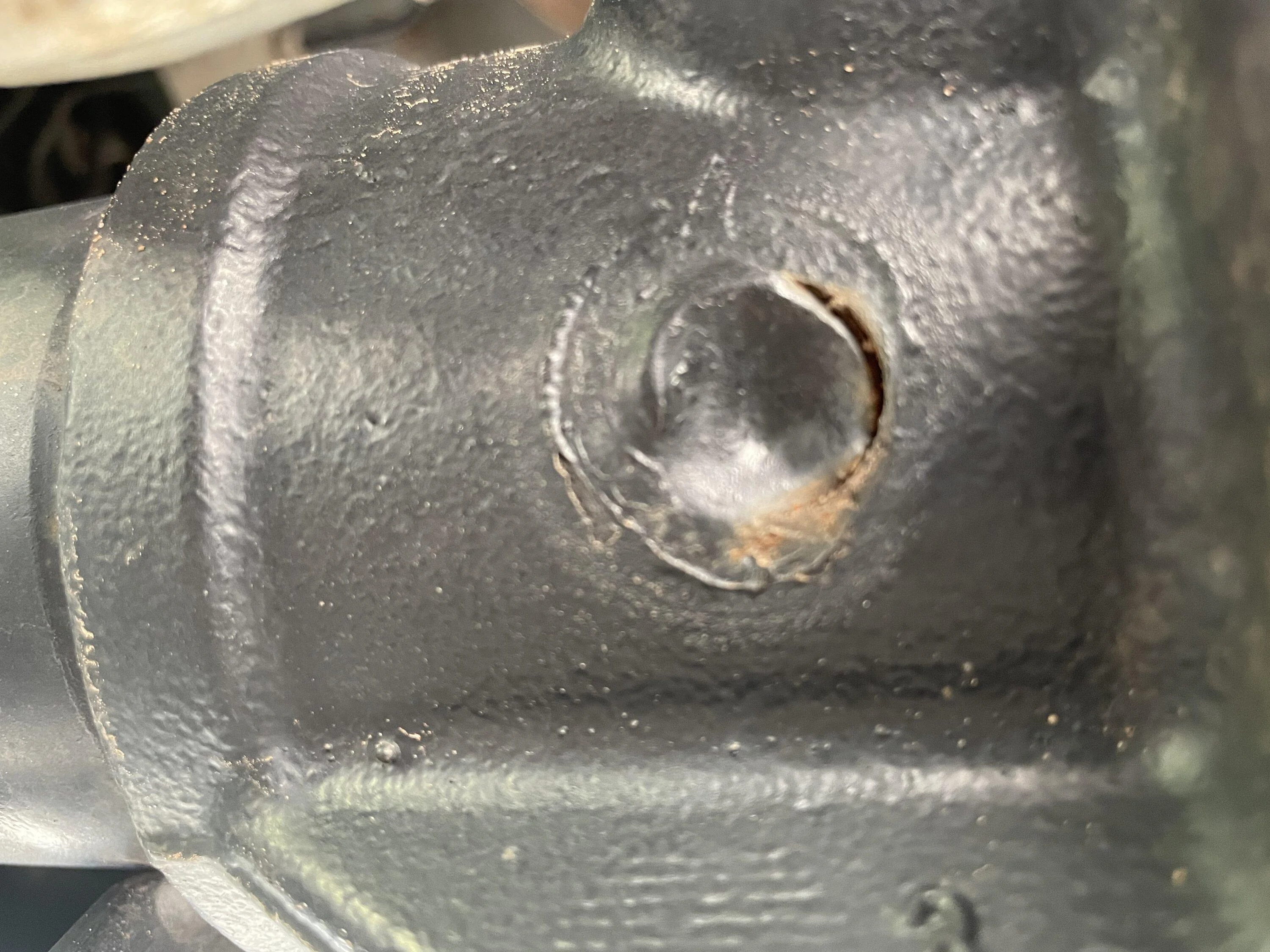

I’ve noticed some posts here for plug welds failing mostly on modded suspension setups so I decided to crawl under my stock suspension Badlands and take a look. My opinion is these welds are about to completely break at any moment looks as if the whole housing was dirty or rusted when they welded these. I’m no expert, but with these cracks I would think water can get in and oil can escape.

I'd have to agree with you...those look like shit. In my mind the rusting indicates a lack of penetration. That first picture doesn't look good at all.

Im curious the ones you actually have issues with or bad looking plug welds are they on your Drivers Side? There has been more and more plug welds more on the drivers side that have been coming up. Another gentleman has the same issue with only 1200 miles on his and was just denied by Ford as well.

Those are some pitiful plug welds. Wonder if it's robotic or human welder because I'd fire myself if I couldn't burn turds in better than those. Damn near makes me want to tear the diff apart and inspect the inside of the tube to see if even bit or just enough to fill up the hole. Guess a guy could always drill most of it out and dump a new glob in there then weld around the center section/tube interface to make sure.

The rust is an indicator that there is an empty void under the weld. Not good at all.
