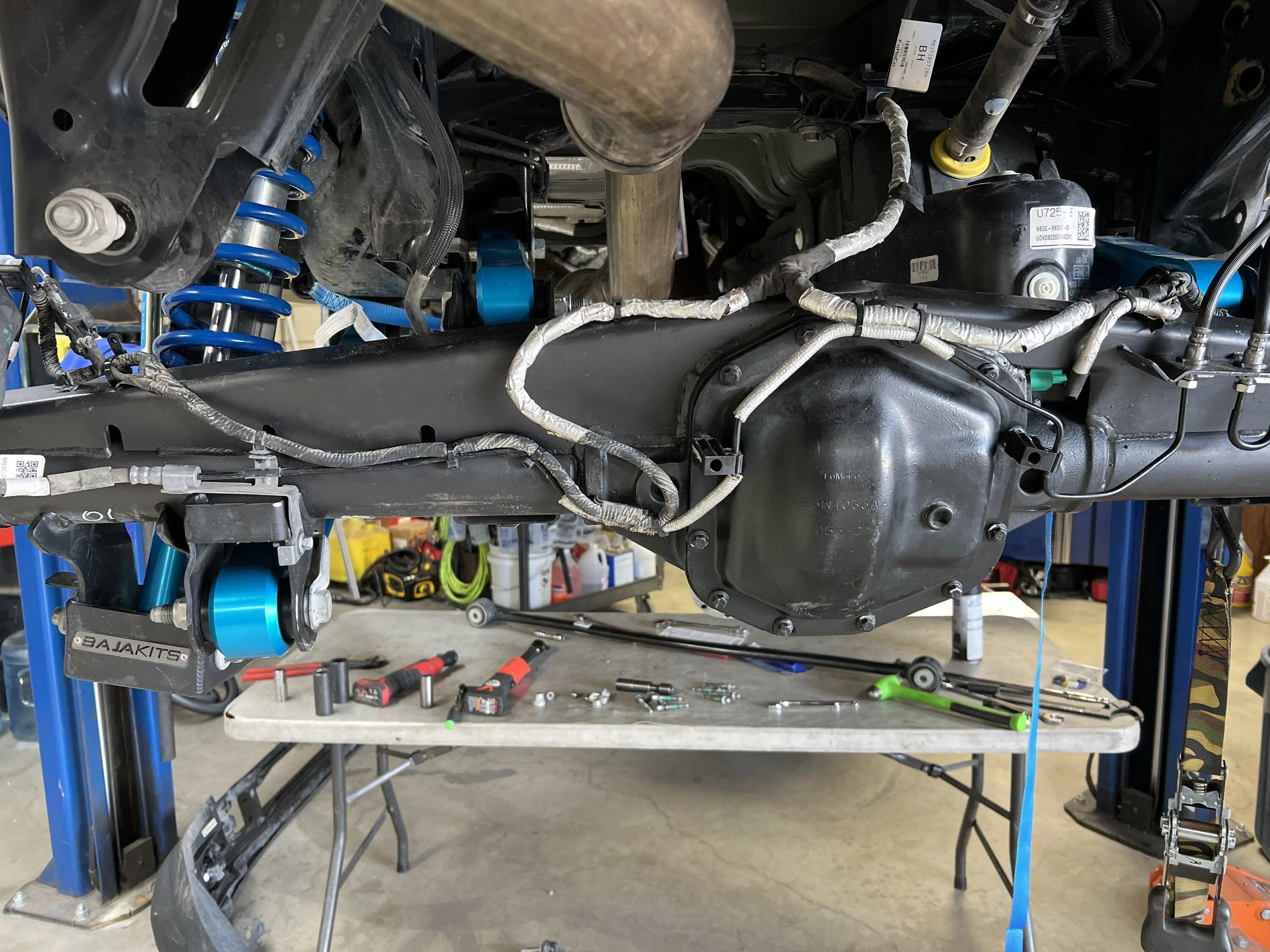

I saw your welds came out, I experienced the same exact issue and on my drivers side. So not sure if we got the same guy welding our rear axle or what. But I would like to know what Top framing support set you back because I would be interested in doing the exact same thing.

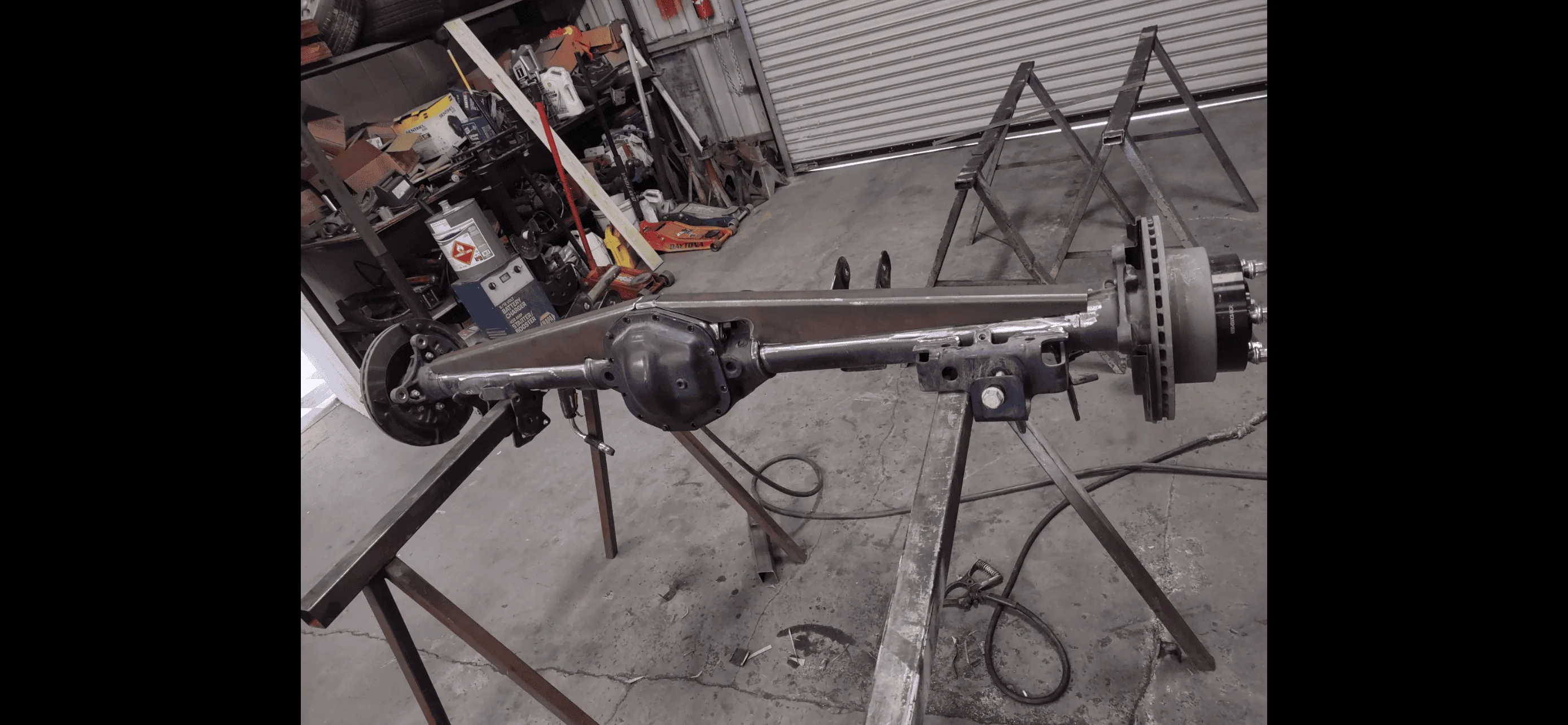

It cost me 1k to have it trussed with me doing the removal, paint and reinstall.

Sounds like to me someone like @Tricky Dick needs to come up with some bolt on support to keep the axles from spinning :)
I mean there has to be something that can bolt onto the brake support that would distribute the rotational shear to say a track bar bolt.
Cough cough I want a discount for my idea :)
IFFF I were to, I gotchu on the discount. But...not really a fan of bolt on for something like this.
If you're building truss that is designed for these rear axles I would get on it soon. Sounds like more and more people are experience the rear plugs coming out on these axles.
