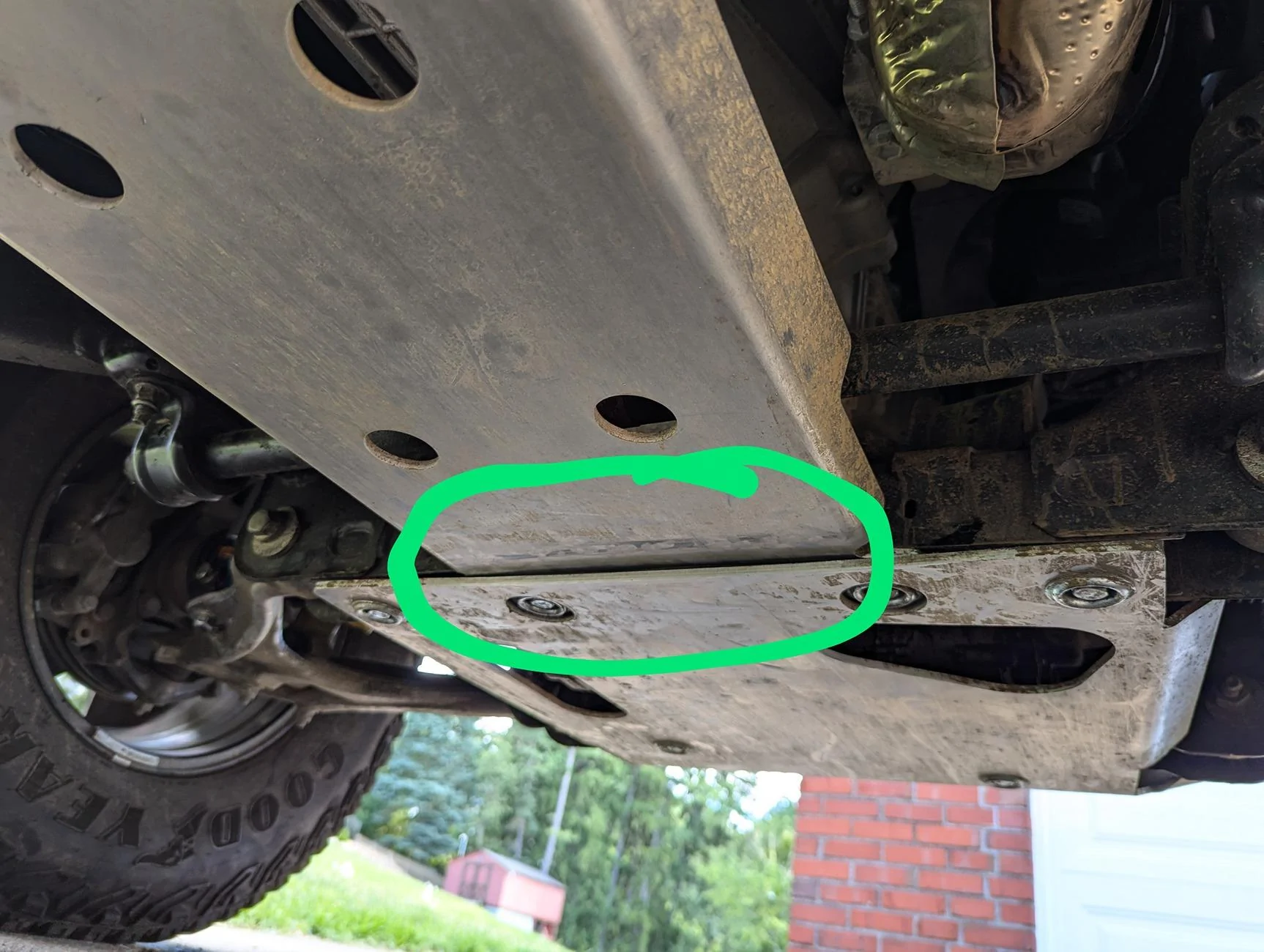

Identified and fixed my issue. Loosened up my skid plates and put some weather stripping in the gap here. The two plates were making contact when I hit bumps or the frame flexed. Noise gone now.
Thank you! I am going to take a look next time I get my oil change, hoping that is just the cause!
