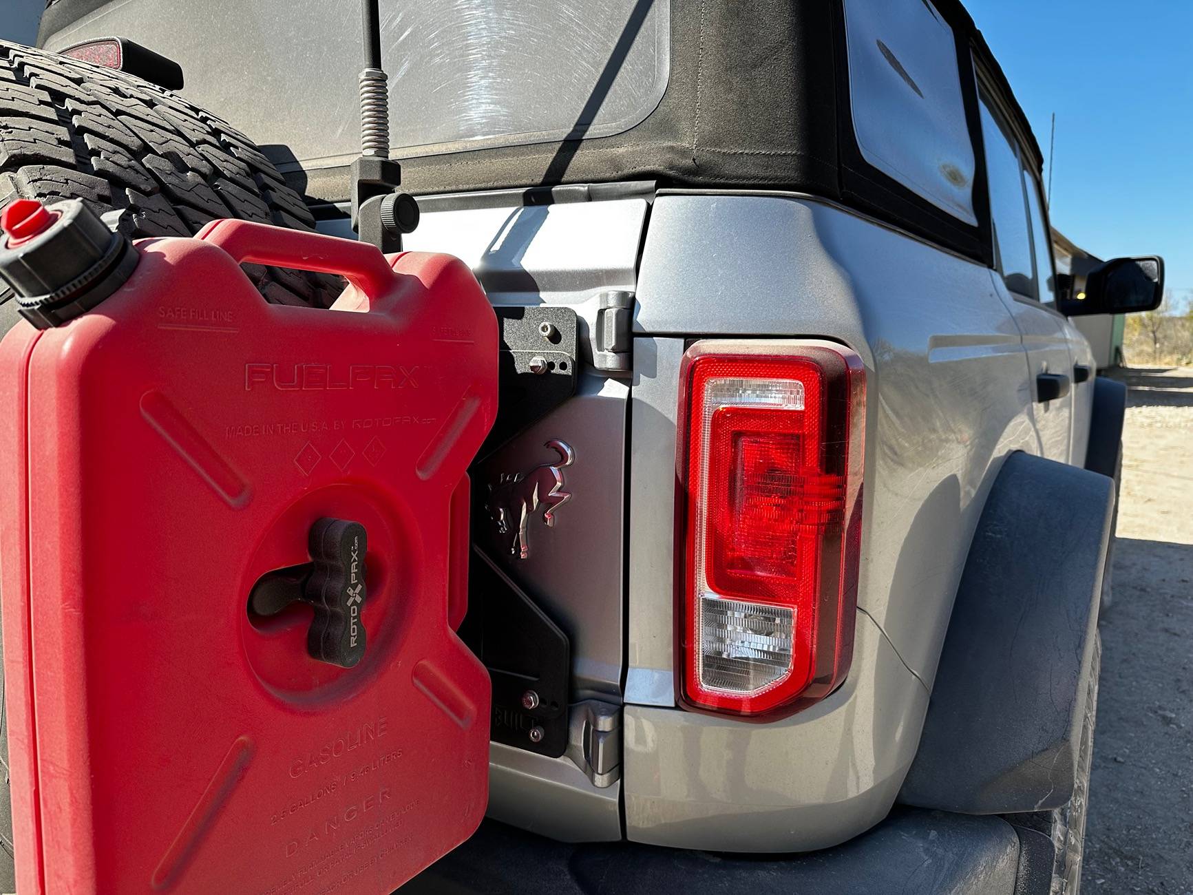

My tailgate starting making a "creaking" noise about a month ago. I installed a Hammerbuilt tailgate reinforcement bracket about a year ago. I'm running 37" Nitto tires, so they are heavier than stock. I've had the Nittos for over 2 years and no issues or sounds. During deer season I run it pretty hard on rough rocky roads in the back country. Last week I was able to get access to the interior hinge bolts and snugged them all up. That eliminated the "creaking" almost 100%. I got down to the deer lease yesterday and hit the back country and the "creaking" came back. Yes, I've checked all of the exterior bolts. All tight.
Question: Should I pull the interior hinge bolts and put LockTite on them? Hoping someone has dealt with this and has a permanent solution for this.

I had the same issue with the HB tailgate reinforcement bracket and extra weight. I decided to get the RTR and haven’t had a problem since. That or the DV8 or Turn Offroad - all replacing the hinges and changing where the weight is carried can help.

I saw that, but I need to understand the difference in your tailgate reinforcement product versus the others on the market. What is the engineering difference?

We use 1/2" steel for the hinge replacements, a fully boxed design for superior stength, brass hinges sleeved with a stainless steel pivot that contacts the bolt so that there is no rubber to flex or degradation of the brass over time. Full line of accessories. Not a single failure in the field and we are the only ones I know of willing to do what is shown in the video below.

Thanks, I've been off grid and was going to watch the video on your site once I got home (about 30 minutes ago). So your solution "replaces" the factory hinges? It would help if there was an exploded parts photo.

Yes we completely replace the factory hinges.

Thanks, that helps a ton. Mine will be a little more complicated since I have the WeBoost antenna wiring to deal with and molle panels on both sides of the cargo area. No biggie, I can't stand the loud creaking that the hinges are making now after this weekend. I know it won't fix itself.
