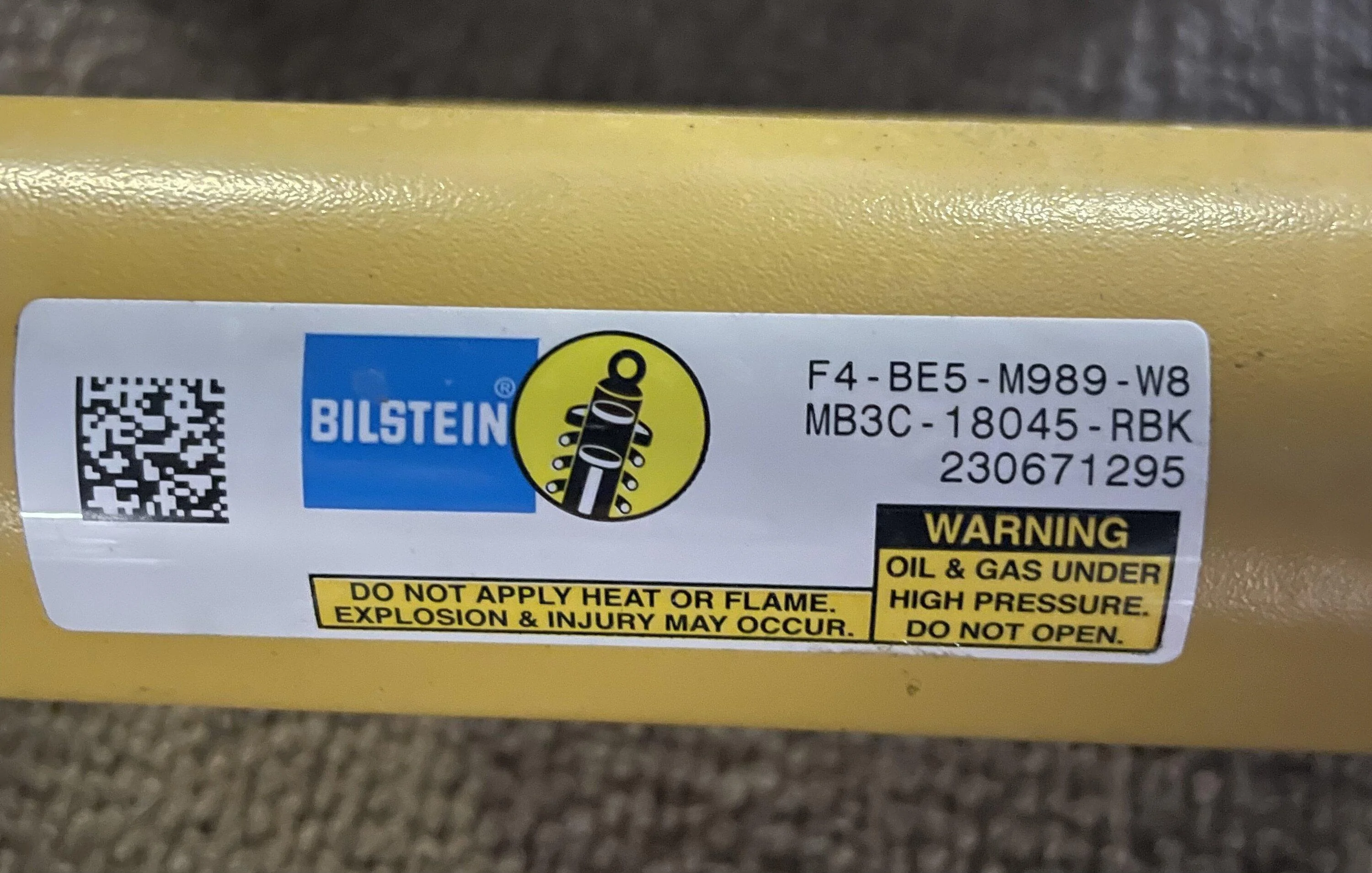

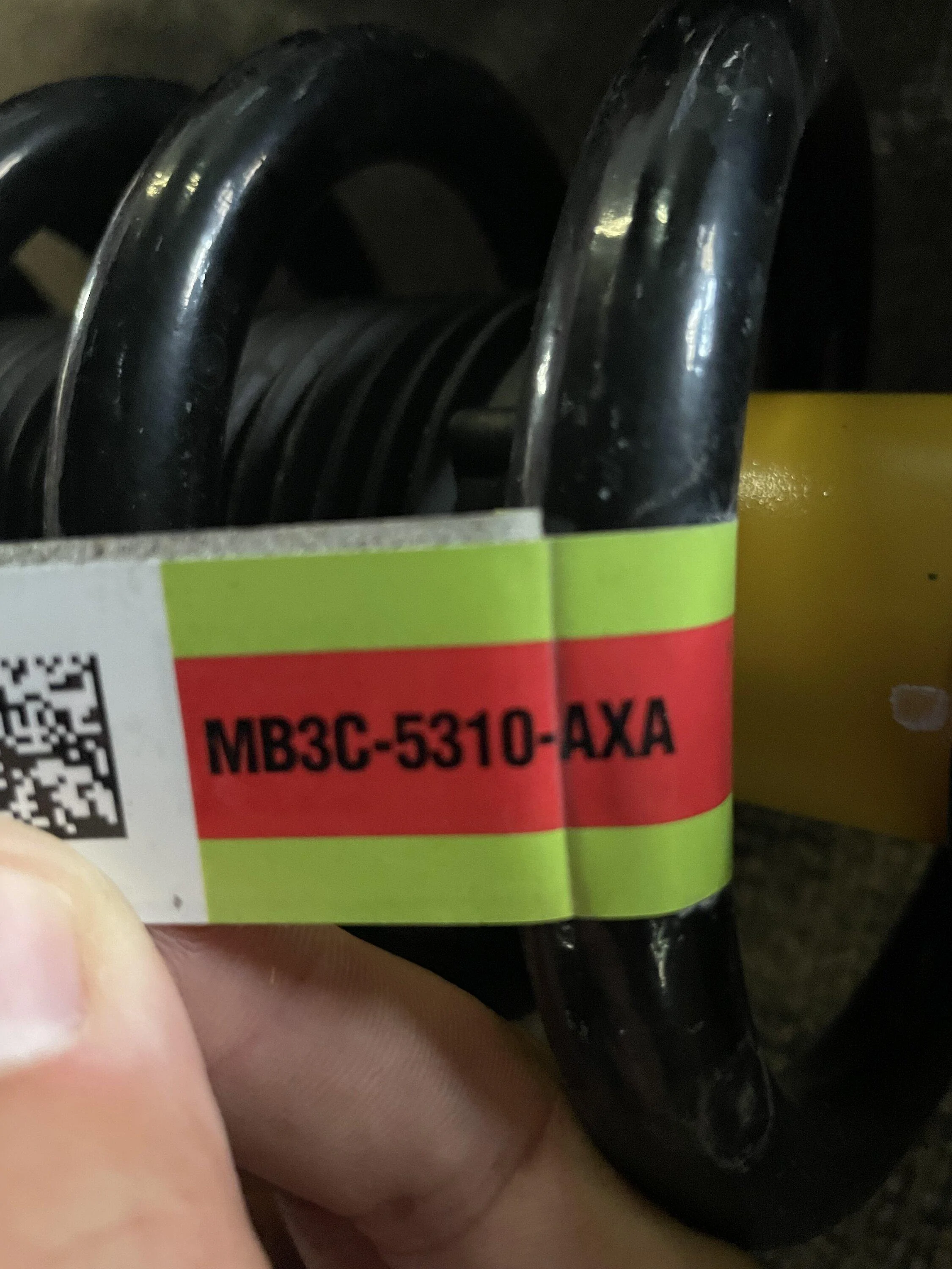

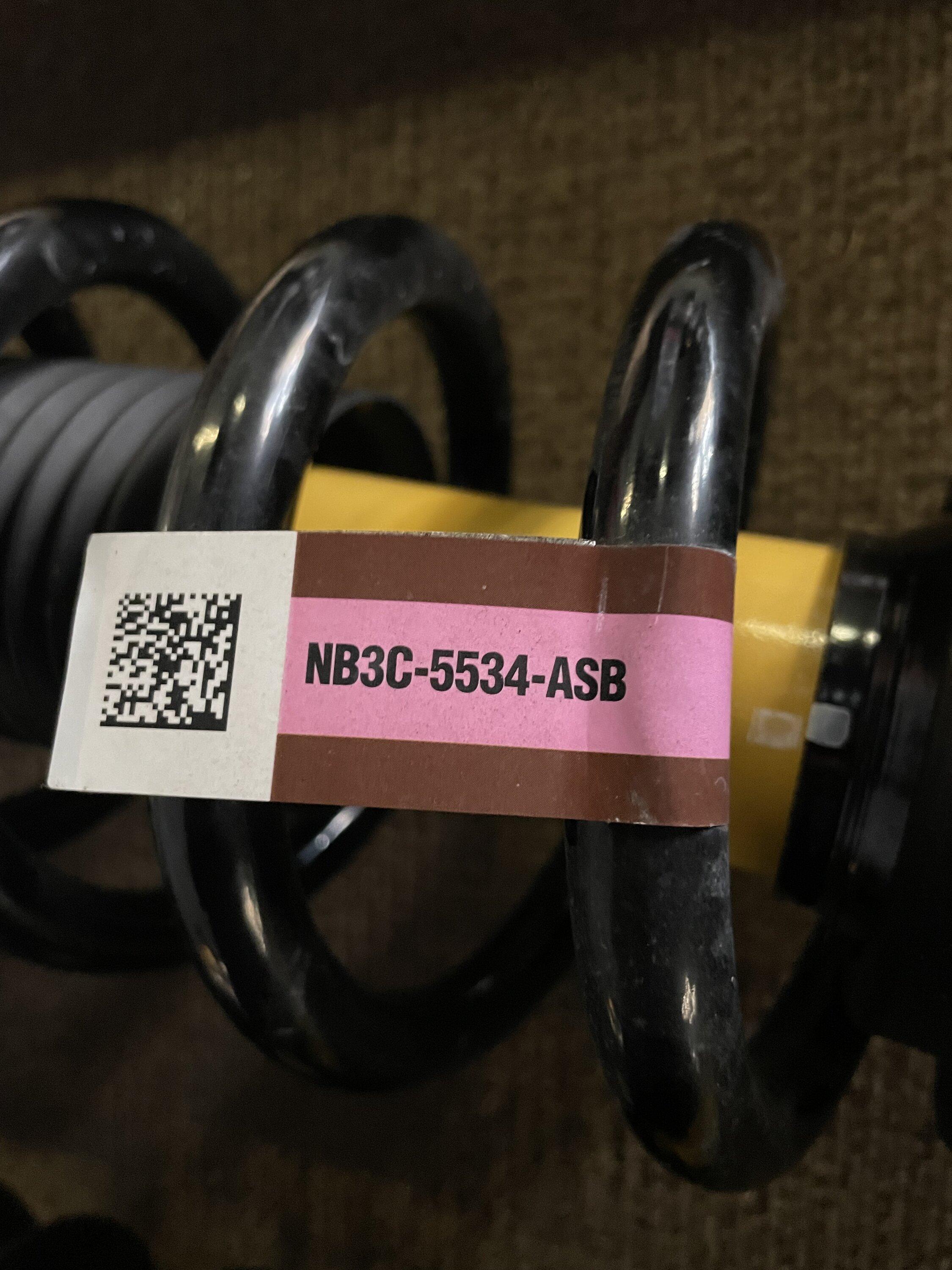

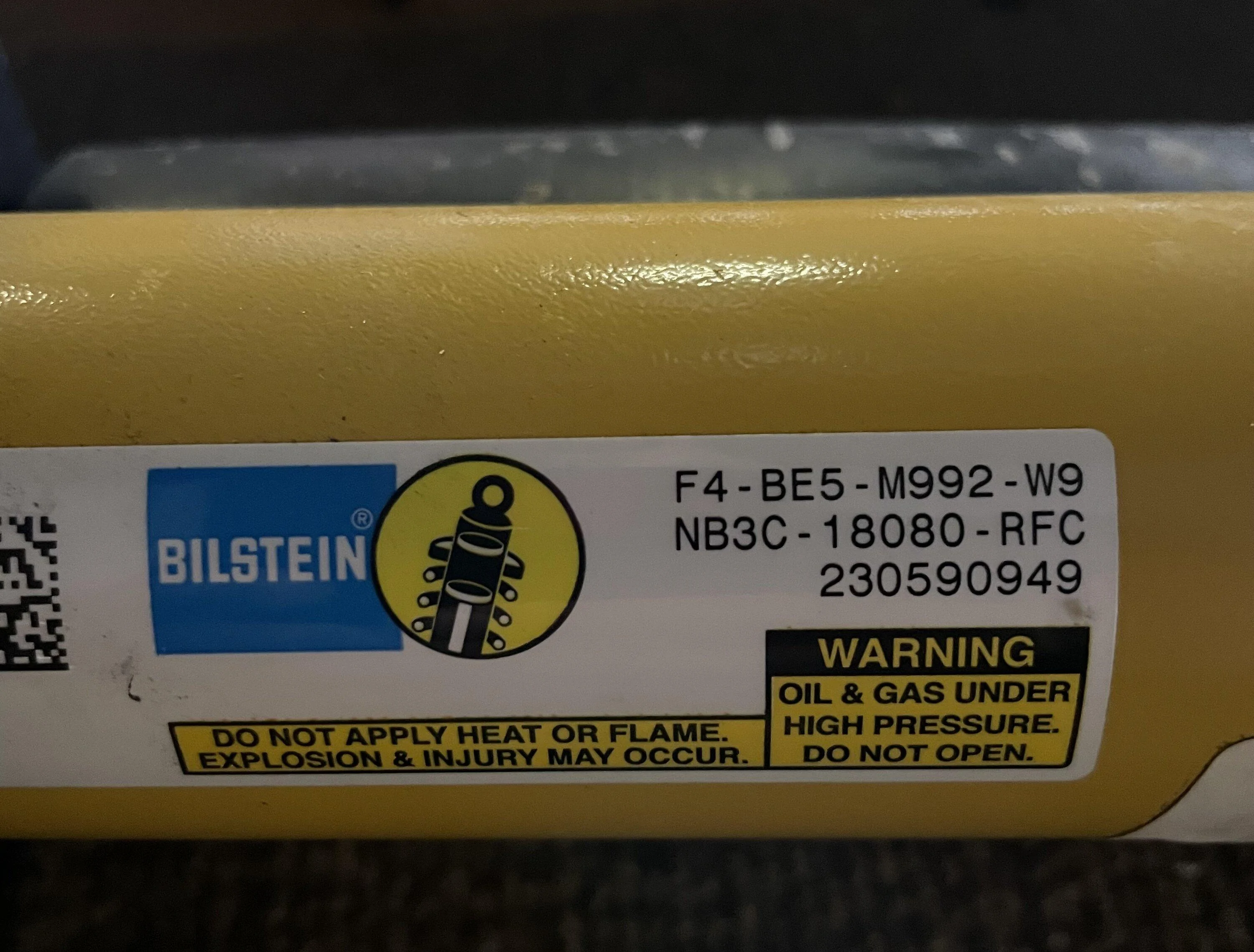

Hi guys,
I got a set of 2023 Badlands SAS takeoff shocks and springs and was curious to match them against the suspension cookbook thread, but I cannot match these part numbers.
Here is what I have:
Shocks:
MB3С-18045-RBK
NB3C-18080-RFC
Springs:
MB3C-5310-AXA
NB3C-5534-ASB
How come these aren't on the thread? Could it be because part numbers changed in 2023 models?
Any help would be truly appreciated.

Hi,
These are what I'm looking at:
Ford Bronco Please help me identify these IMG_6374
Ford Bronco Please help me identify these IMG_6376
Ford Bronco Please help me identify these IMG_6379
Ford Bronco Please help me identify these IMG_6378
Thank you

MB3C-18045-RBK = MB3Z-18124-K
NB3C-18080-RFC = NB3Z-18125-C
MB3C-5310-AXA = MB3Z-5310-N
NB3C-5534-ASB = NB3Z-5560-F
So these appear to be 4 door SAS takeoffs

What you have shown are ENGINEERING numbers NOT part numbers. Ducati has posted the actual part numbers that go with the engineering numbers.
