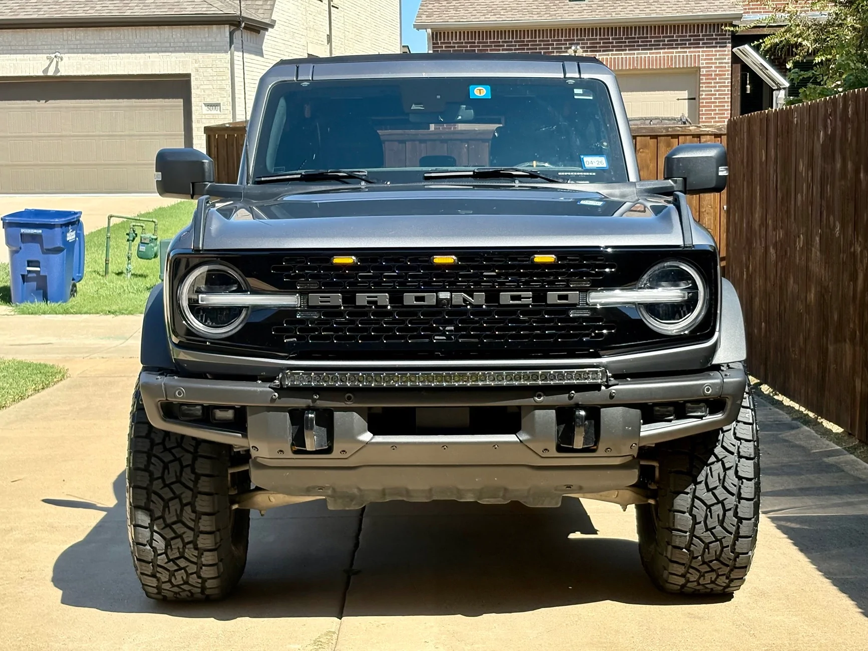

2023 Ford Bronco Badlands
  • 2023 Badlands Non-Sasquatch 2.7
  • 41,000 miles
  • Mostly DFW city miles, some heavier off roading (2-3 times per year)
  • Suspension/Geometry mods - replaced stock BFG KO2 33’s with Toyo Open Country AT3 35’s. Added Eibach Pro Lift Kit Springs to front and back for 1.5 inch lift and to level. Removed crash bars. Kept stock shocks.
Video:
For the life of me, I cannot figure out what is making this popping/knocking sound when I turn the wheels at low speeds.
The dealership told me they couldn’t figure it out either, which is concerning.
Has anyone else had this same issue? What is the diagnosis and how did you fix it? Could it be as simple as Forscan adjustment of the tire size? UCAs or tie rods or alignment? Or it is a bigger issue?
