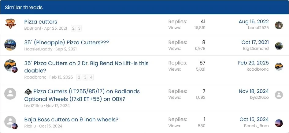

Welcome to the forum. If you scroll to the bottom of your thread, you will find Similar Threads.

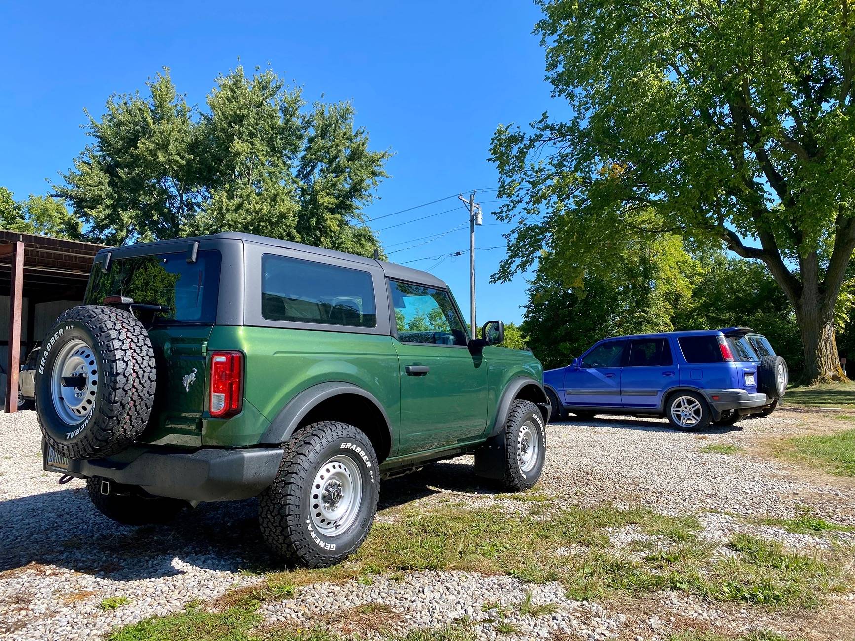

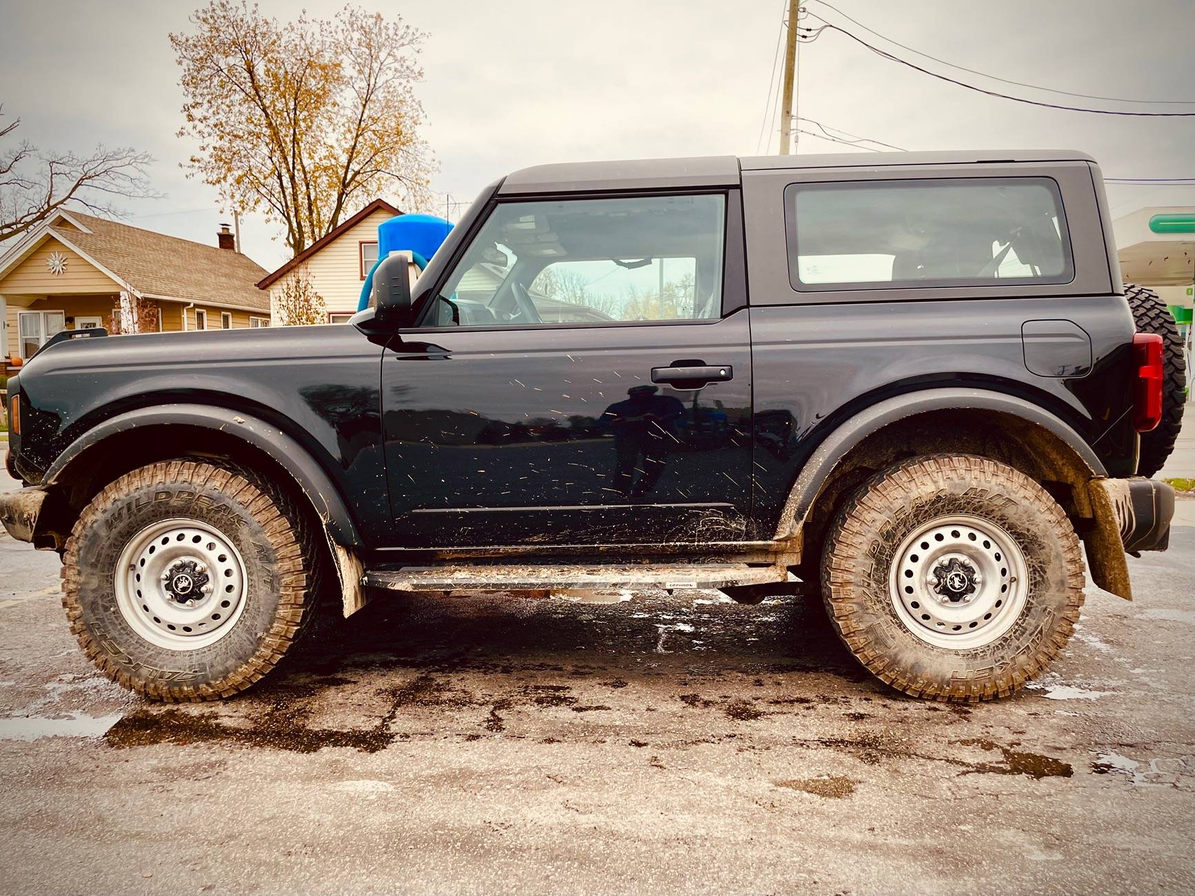

I went with 255/85r16 (33.1”x10”) as they seemed proportionate to the bronco, and even though they aren’t as skinny as the 235’s, they are 1.5” taller so they still give that narrow “pizza cutter” vibe. IMO, on the steelies they give the utilitarian “grandpas reliable bronco” look that I was going for. Even though I’m in my early 40s. 😂
Ford Bronco Pizza Cutters IMG_4823
Ford Bronco Pizza Cutters IMG_5089
Ford Bronco Pizza Cutters IMG_2630

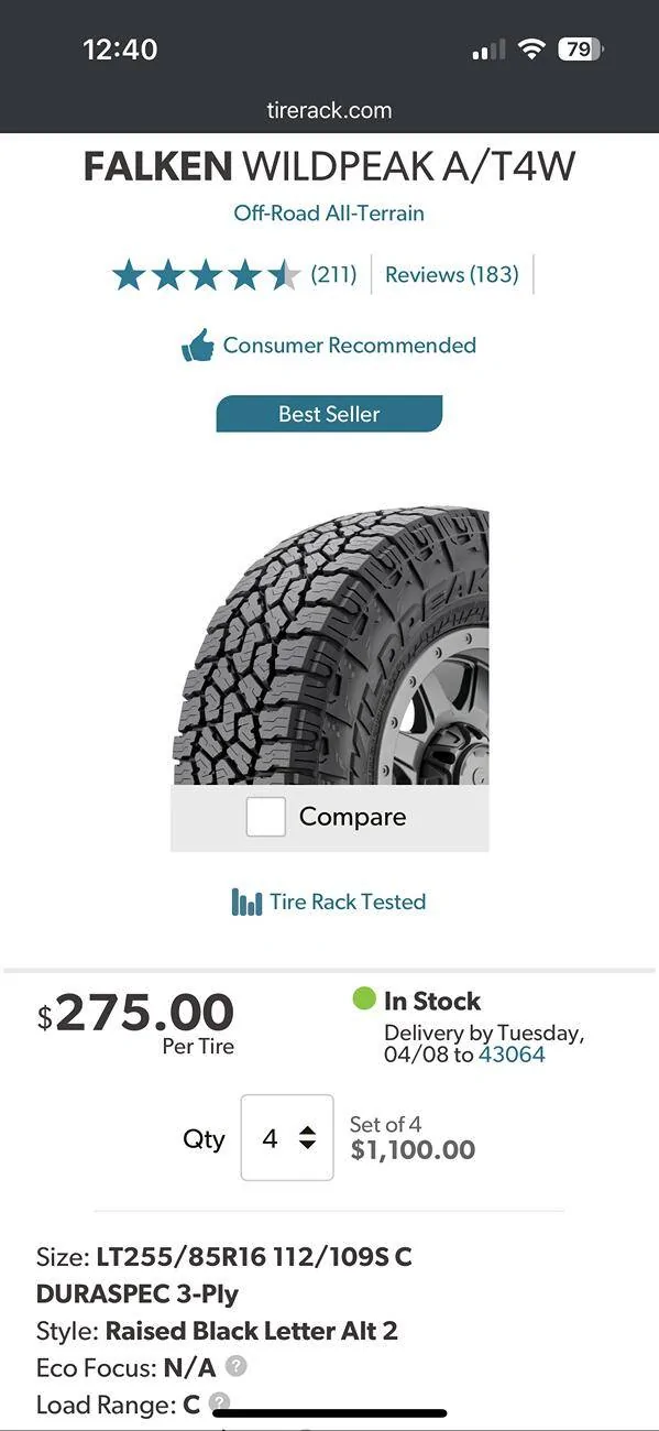

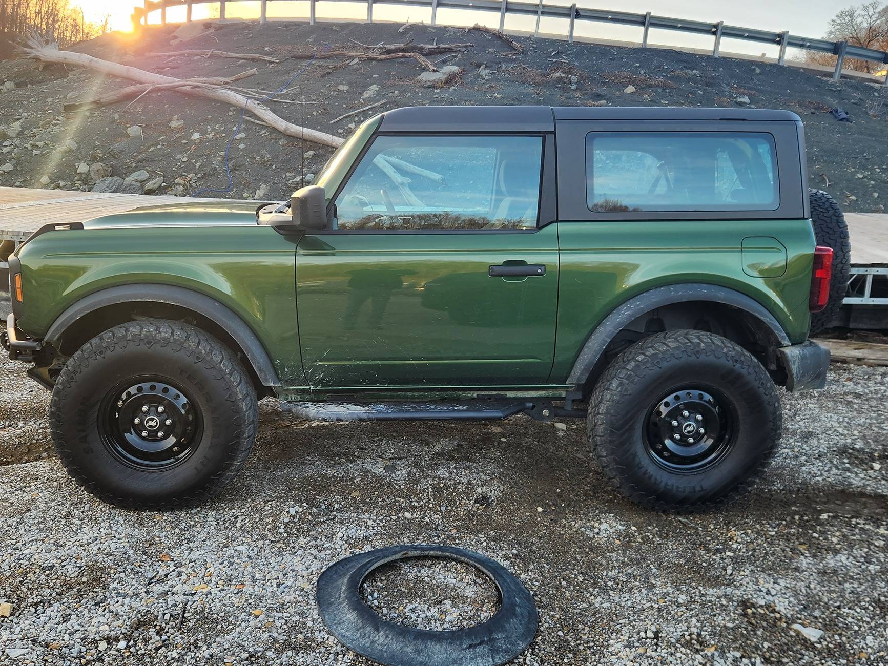

I was looking for this exact same thing for my base 2DR because the proportions are just right. Unfortunately a couple years ago the only options in that size were mud terrains and I didn’t want that with my 50 mile highway commute. It looks like now Falken added that size to the Wildpeak AT4W, I think you’d be very happy with that. I might buy these next when my Grabbers wear out

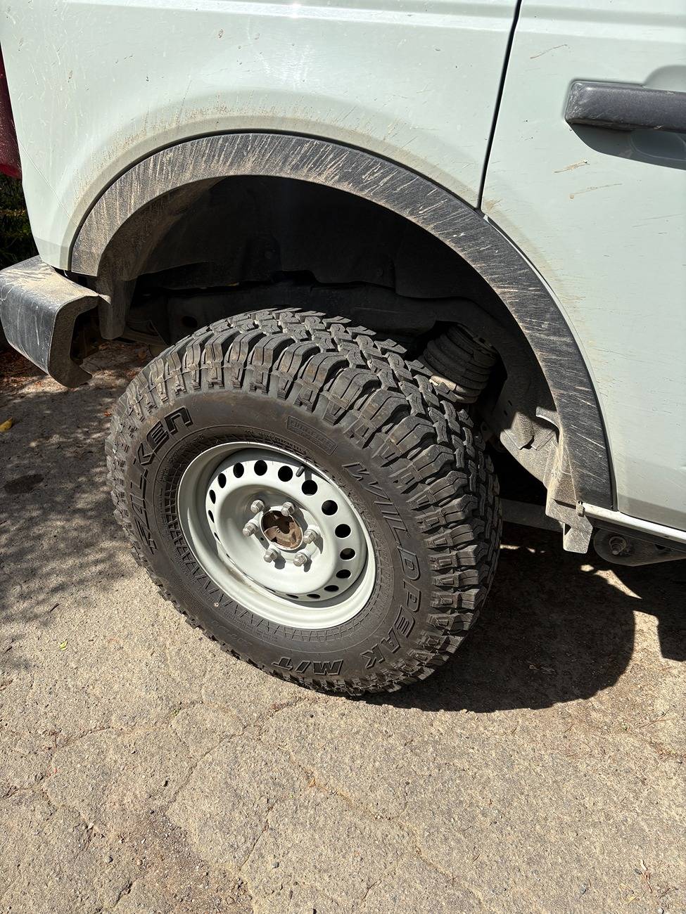

Ford Bronco Pizza Cutters IMG_0587

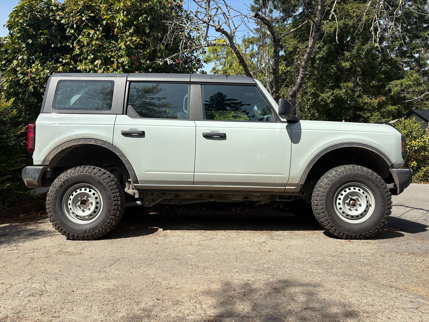

And for reference what I ended up going with is the 265/75R16 General Grabber about 31.5”x10.5” and it’s a great upgrade from the base tire.
Ford Bronco Pizza Cutters IMG_5463

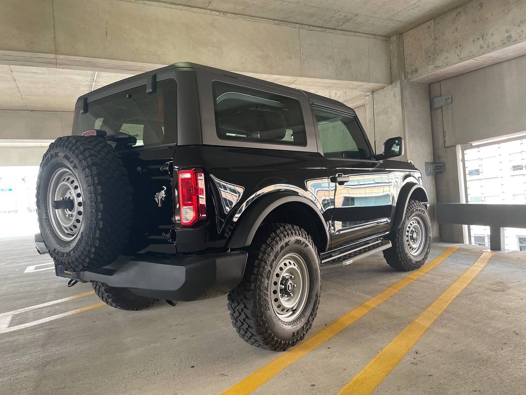

I went with 255/85r16 (33.1”x10”) on the (powder coat color match) steelies - they give the utilitarian “grandpas reliable bronco” look , I’m in my late 50s 😂 .
+ 2.5" Lift & Fender Delete
