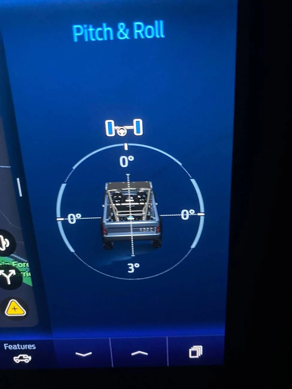

The road signs says 6 degrees. But my bronco says this. Any ideas

Road signs tend to be a bit conservative. There may be one small place where it’s 6, but the rest of the place it’s less.
we have one here that says 8, but my inclinomter says it’s closer to 5. And I’d believe 5 on average - there is one spot where it’s steeper for a couple dozen yards. Out drive is 12 at the steep part and the inclinometer reads 12 on it.

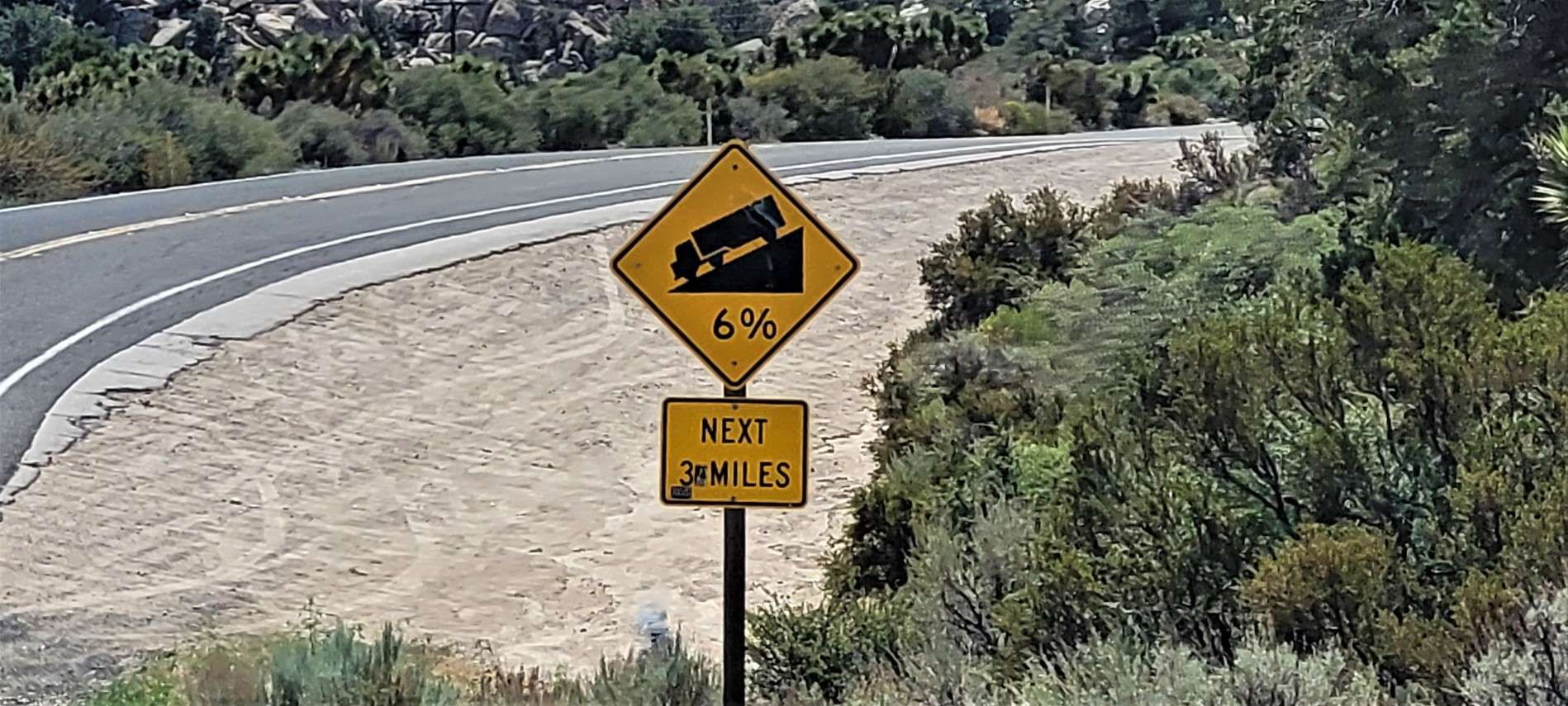

Does the road sign say 6 degrees or 6 percent? Tangent (rise over run) of 3 degrees is just over a 5% grade, or in other direction, 6% grade is 3.4 degrees.
That is a good point. I didn't even think about the difference between % and °

6% on the street sign, 3 degrees in the dash
We went over this earlier in this thread, in which I learned something:
100% = 45 degrees
So your Bronco math is correct - roughly 2% per Degree

I have never seen a road sign that listed degrees for a grade - alway percent, which is easier to measure anyway.
A couple of years ago out of curiosity I made an Excel spreadsheet that converts percent grade to degrees listing from 0 to 100 percent in steps of one.
For 6 percent it shows 3.43 degrees.
