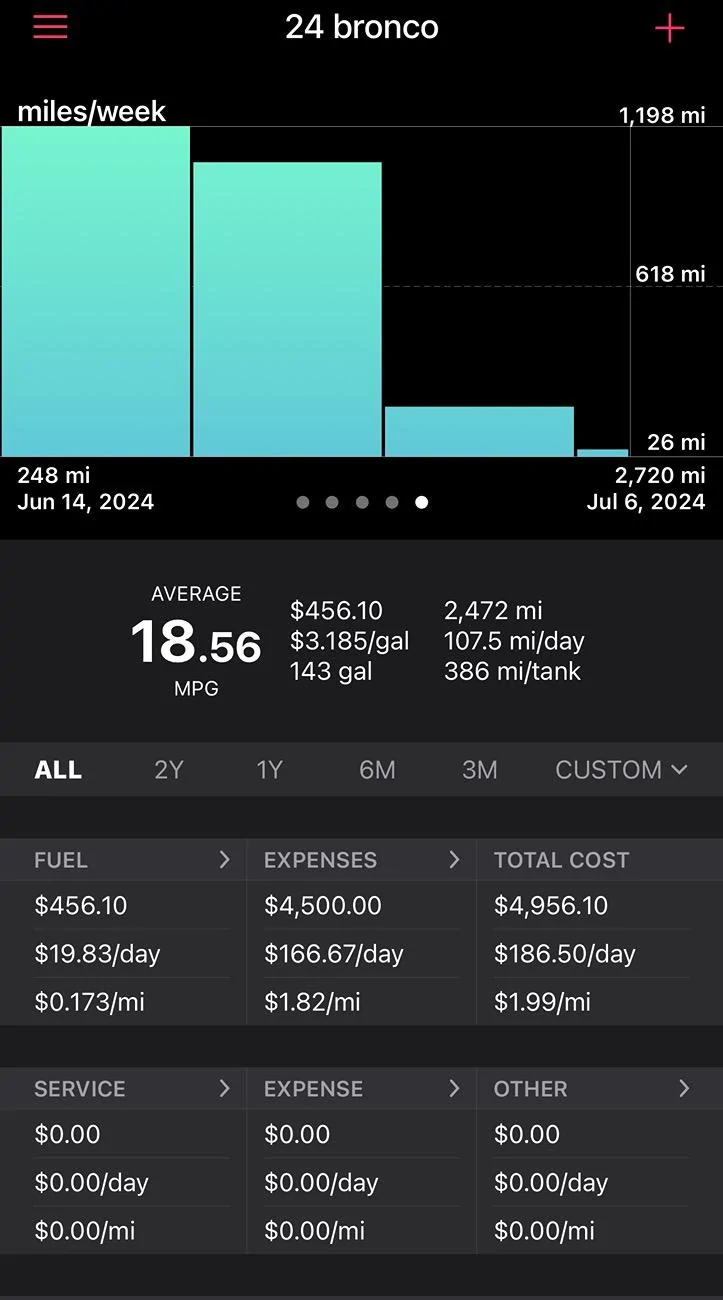

This is my 24 2.7. Keep in mind, I’ve done 2 800 mile round trip drives so the miles per day are skewed
Ford Bronco Parts, mods, hacks for MPG boost? IMG_5829
