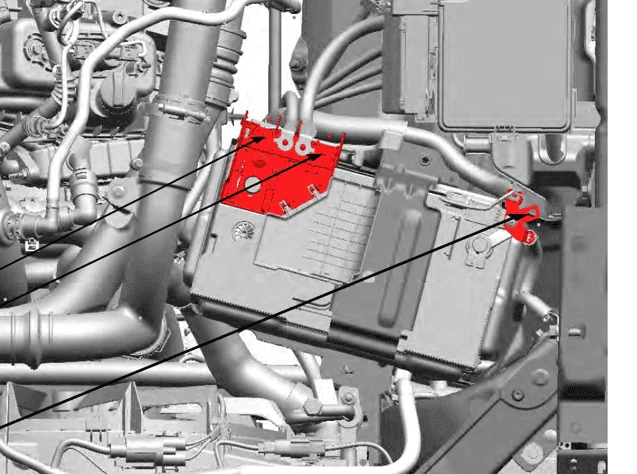

If you can, post a photo of your battery showing B+/GND terminals with red cover open.
