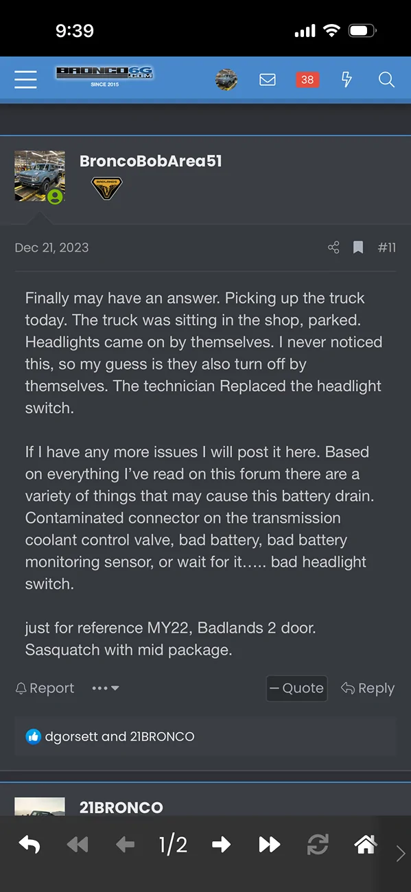

Had this issue also…
Ford Bronco Ford Help Parasitic battery drain IMG_1045
