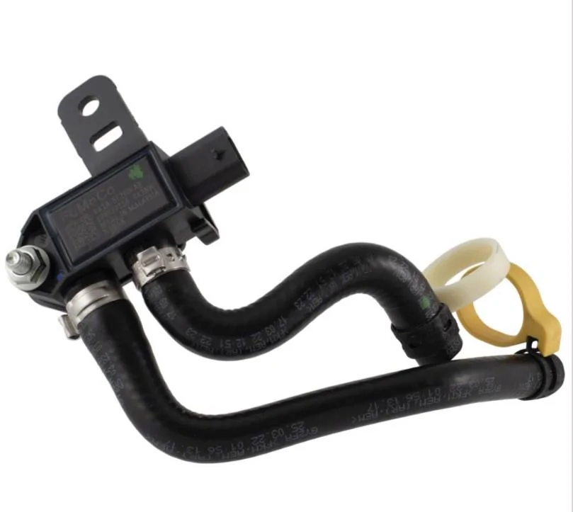

That is definitely not correct.
That picture you posted is the back pressure sensor.
The Ford part number for the DPFE (Differential pressure sensor) is KA1Z-5L200-A (or LB5Z-9J433-B if you want the bracket and hoses to come with it)

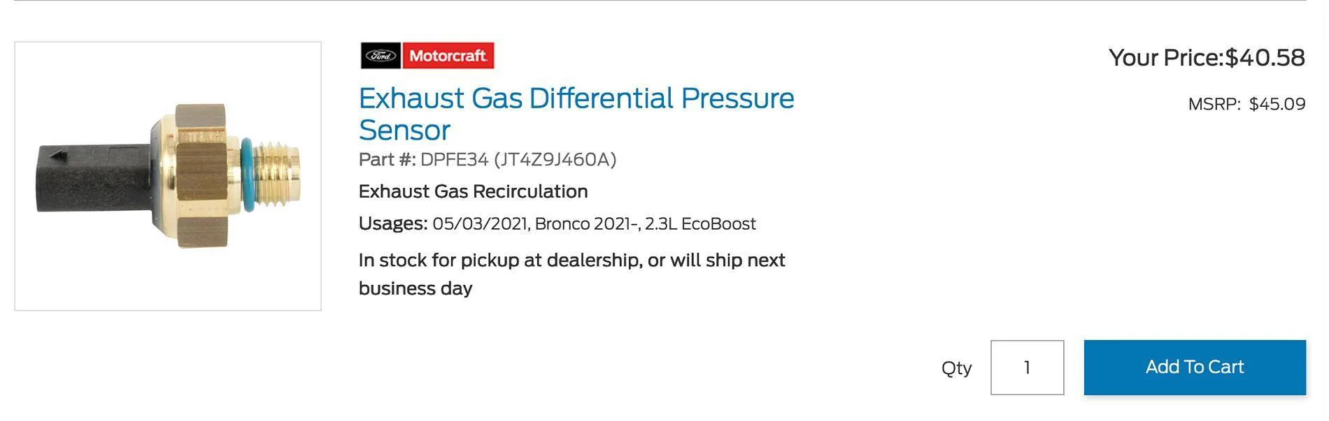

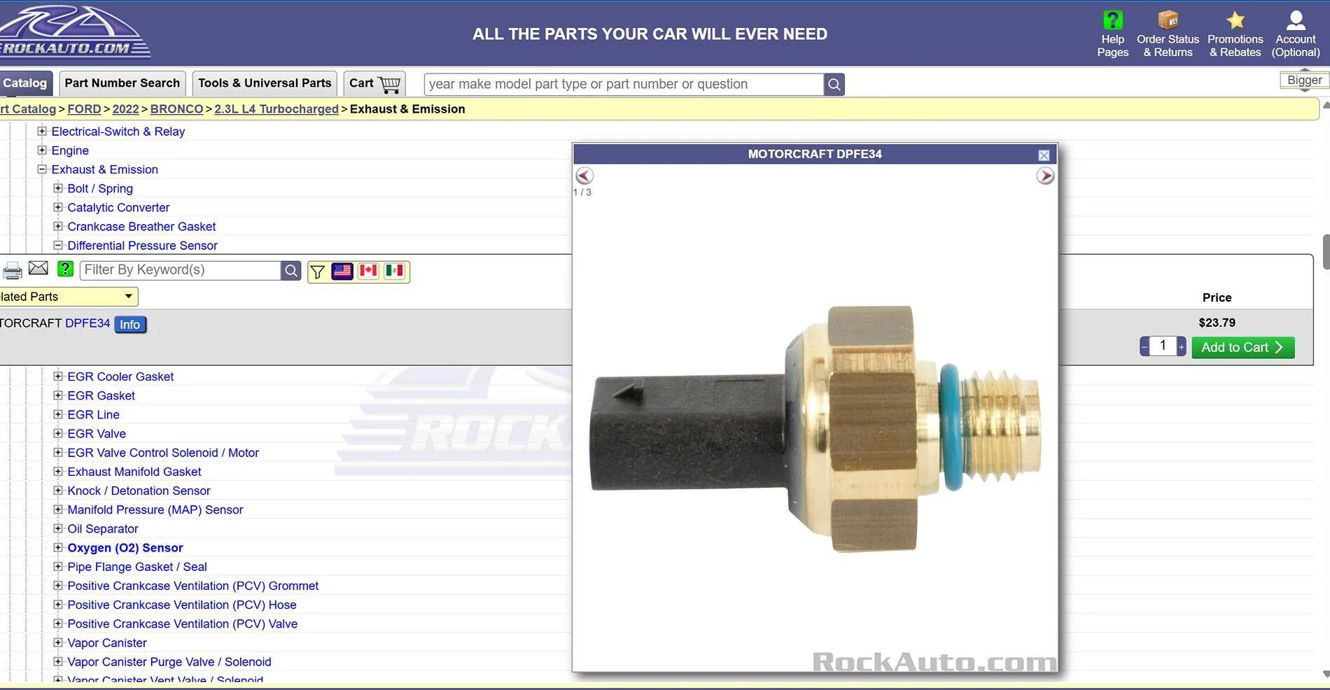

@Ducati1098 - I am cuious about the part you referenced. I am finding a DPFE similar to what @SVT_RS3 found on Ford's website (I purchased a matching part on Rock Auto as well):

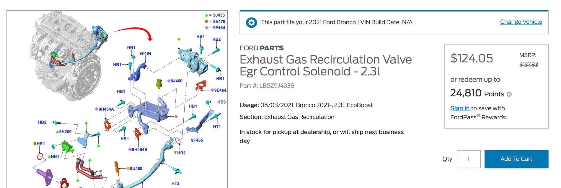

The part you mentioned was listed as the Exhaust Gas Recirculation Valve Control Solenoid:

The problem is you’re expecting some random parts websites to have the verbiage correct, and they’re never accurate.
So I’ll attach the actual Ford workshop manual so you can see what each part is really called:
