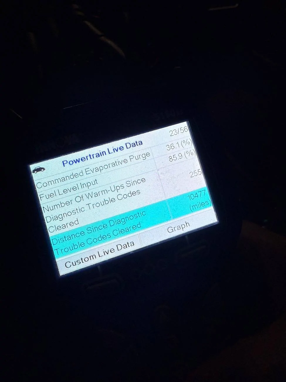

I recently purchased a 2021 Outer Banks (2.3L) on April 1st. On the way home from leaving the dealership it threw a CEL. Code P0402 - Exhaust Gas Recirculation Flow Excessive Detected. I searched the forum but didn’t see anyone else that has posted about this issue.
Truck is at 40,000 miles - cleared the code and drove it approx 200 miles before the code returned.

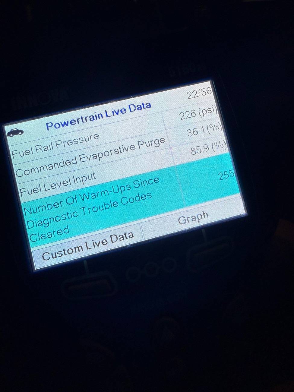

Side notes in case anyone asks: The dealership that I purchased from (not Ford) is about 1.5 hours away from me and do not seem motivated to fix the issue even though it happened same day - that’s okay with me, I just want to fix the problem. This issue won’t be covered by Ford since the truck is out of the 3yr/36k warranty. It also won’t be covered by the extended warranty I purchased since it is an emission component. Also - when we checked the code with a scanner, the truck had been driven around 10,000 miles and warmed up approximately 251 times since the last CEL was cleared (or battery disconnected) so I do not believe the dealership was aware of this issue - it was likely coincidence. They only had the truck for a day before I purchased it.
Attaching a photo of my Bronco here and the code reader data - thanks again for the add and looking forward to learning more about these trucks in this group!

Can you read live DPFE pressure and voltage with that scan tool you took pictures of?
That’s a great question - I’ll have to check on Thursday. It’s a friend’s scan tool - I have a much more basic version. 😂
