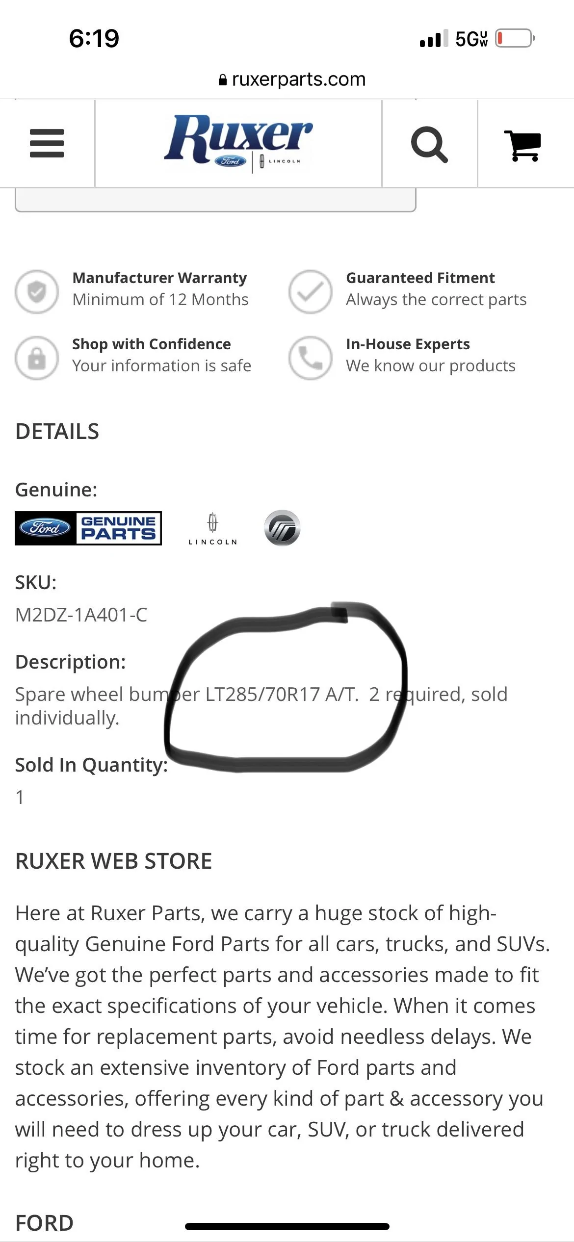

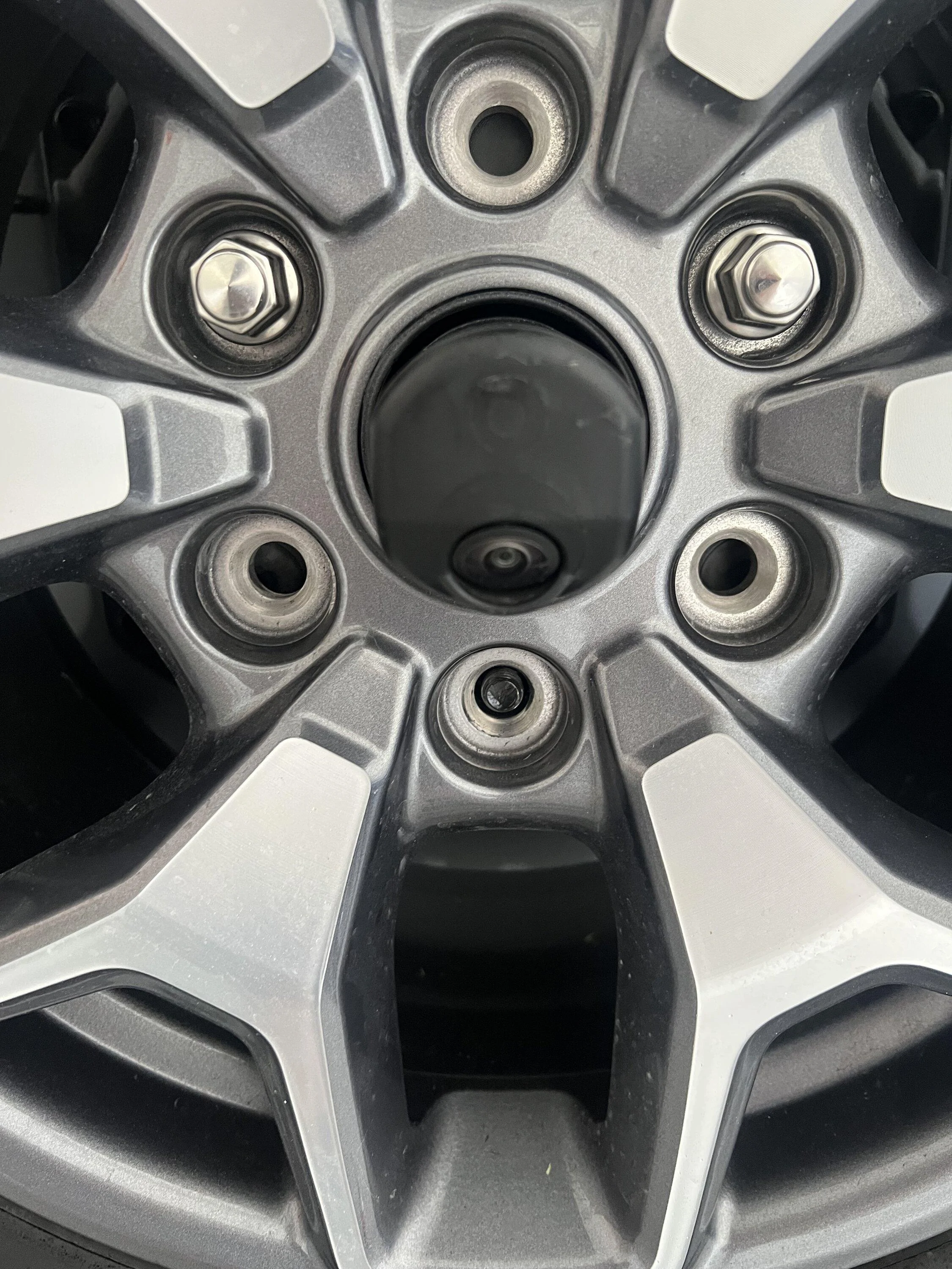

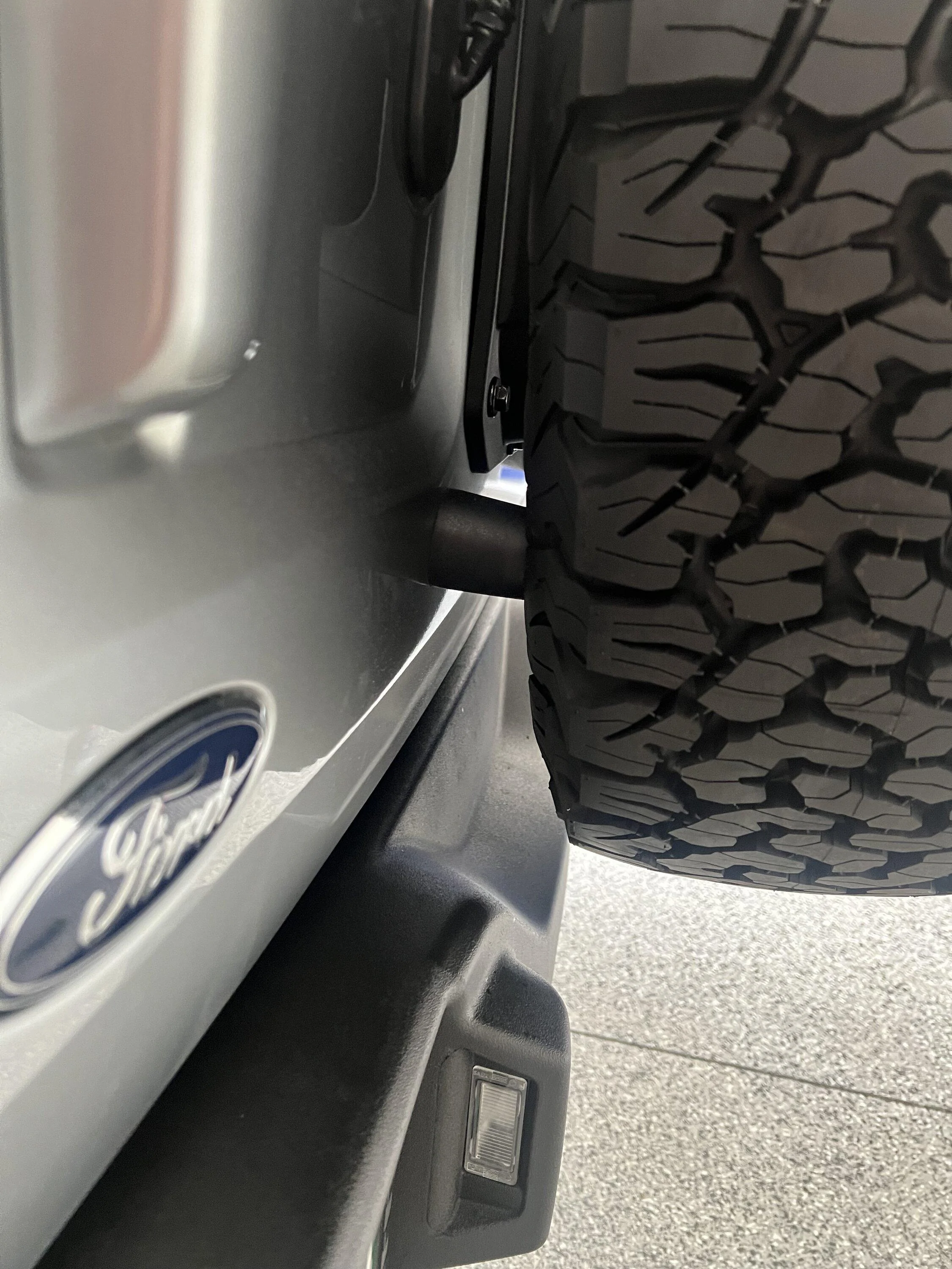

Okay, so I continue to find out more things about this vehicle every day. I recently changed to a set of badlands wheels on my outer banks. I went to finish putting on the spare tire today and it seems like it doesn’t fit, and that the bump stops are too long
are there different size bump stops between the outer banks and badlands? I stuck my finger down in and it looks like there is a bolt down in there, so it is replaceable. Anybody have a part number ?

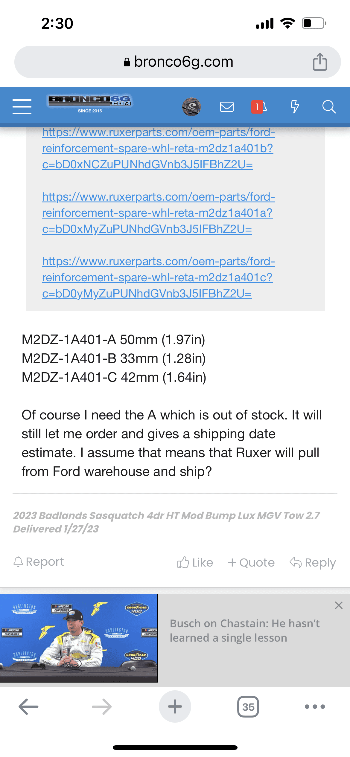

So I’ve been finding more information, I guess I was just hoping for a quicker answer here. Hope this helps out anyone else who runs into this issue. Looks like I do in fact need the “B”, for 33 tires (badlands)
Gosh dang there’s 3 different ones? If you need shorter just chop chop them?
Deleted member 49144
Guest
I hate to do that, if I can just order the ones that are suppose to go on it. I don’t like to hack anything if I don’t need to.

I used a 3/8 wheel spacer from Autozone. I couldn't get the bumpers out and it was a right now solution.
