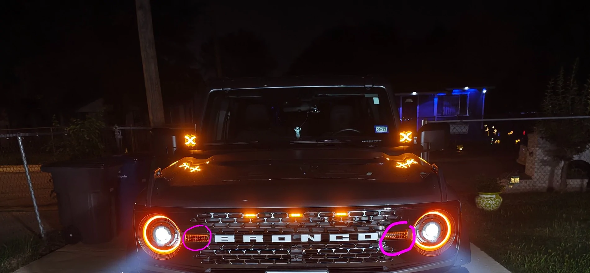

I installed Oracle Bi-led lights on a 2025 Big bend, I bought them because it said plug in play, the headlights and orange halo work. I don't know why the turn signal and side reflectors don't turn on, I guess I need to call Oracle tomorrow, just wondering if it's a Forscan problem, I don't know how to use Forscan, and I don't think the place I bought them will take them back hope there's a fix if anyone here knows I would appreciate some guidance thank you.
I know the side markers have their own plug that needs to be connected since they are attached the the grille it self, not sure if the ones you circled have a plug as well. Perhaps worth checking those connections.

Yes everything is plugged, blinkers and side markers just wanted to see if anyone has ran into this problem when I put the blinker to turn the halo turns off so I'm stuck love the look and the light output but need a front blinker don't know if it's a computer problem but I thought they were plug in play.

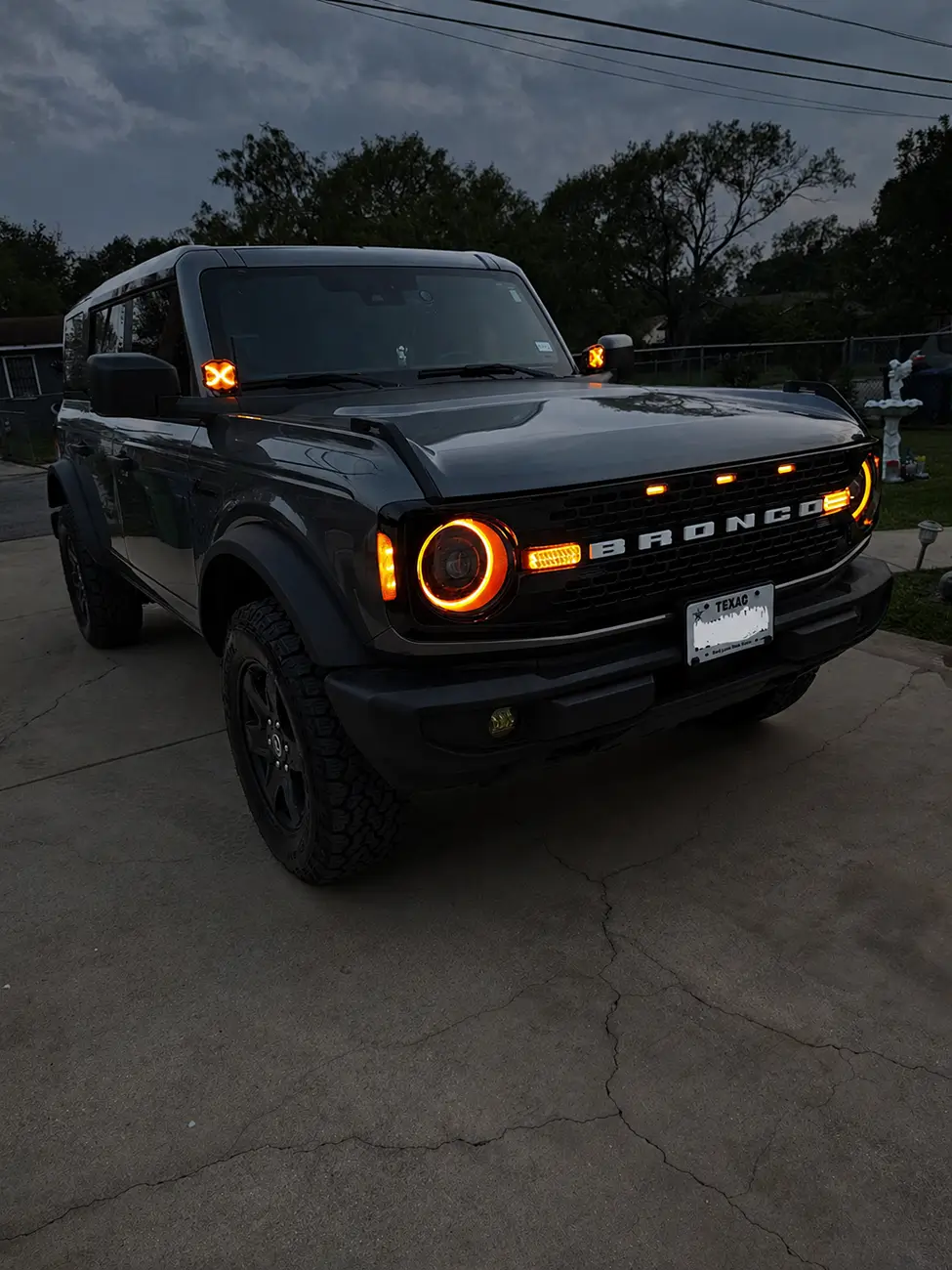

I fixed it, I wired it wrong......thanks to Oracle for guiding me, I called y'all and the guidance you all gave me, I got them to work
