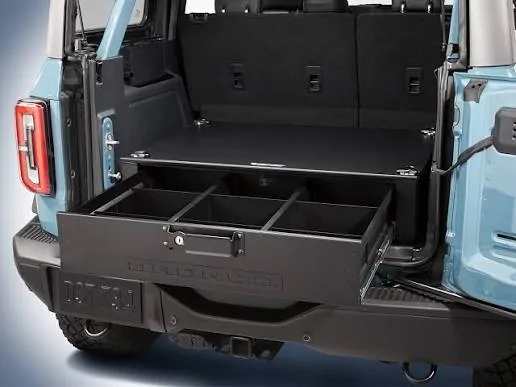

Again.... no options for the "4-drawer" Bronc models? I swear you 2-door folk are trying to take over the world! Blasphemous...
I think Ford makes one like that for the 4 door. I have a friend with one that I think he got from Ford. It even says bronco on it. The Ford one has 4 tiedown loops on the top.
How hard is it to get to the jack under it?

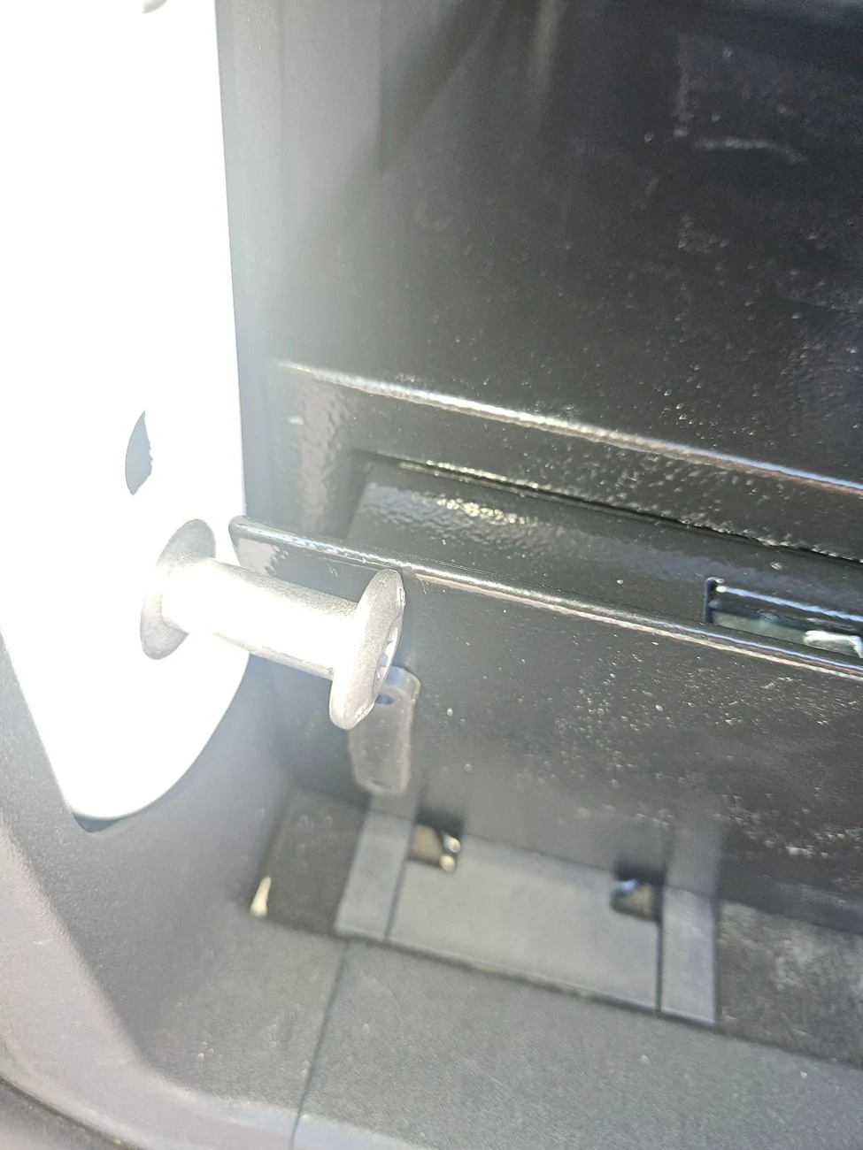

I do not plan to use the cable. It appears that you can slide it all the way to the rear seats and cock it slightly left.
This allows the door to open with out contacting the cargo door pin.
If you do this, you can drill holes corresponding with the cargo tied downs nearest the rear seats.
It you want it forward, you will needs a corner mod to the vault door, or remove some metal from the bottom of the Bronco door pin.

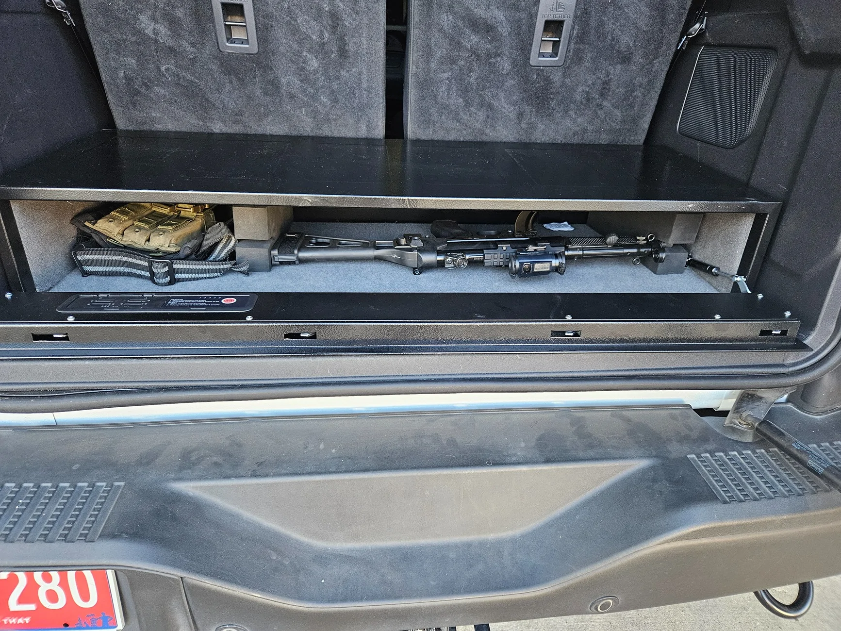

It seems this discussion suspiciously and abruptly ended. In the off chance I'm wrong here is the conclusion.
To make it work you will get two bolts, maybe three of the rear bolts to lock it into the truck.

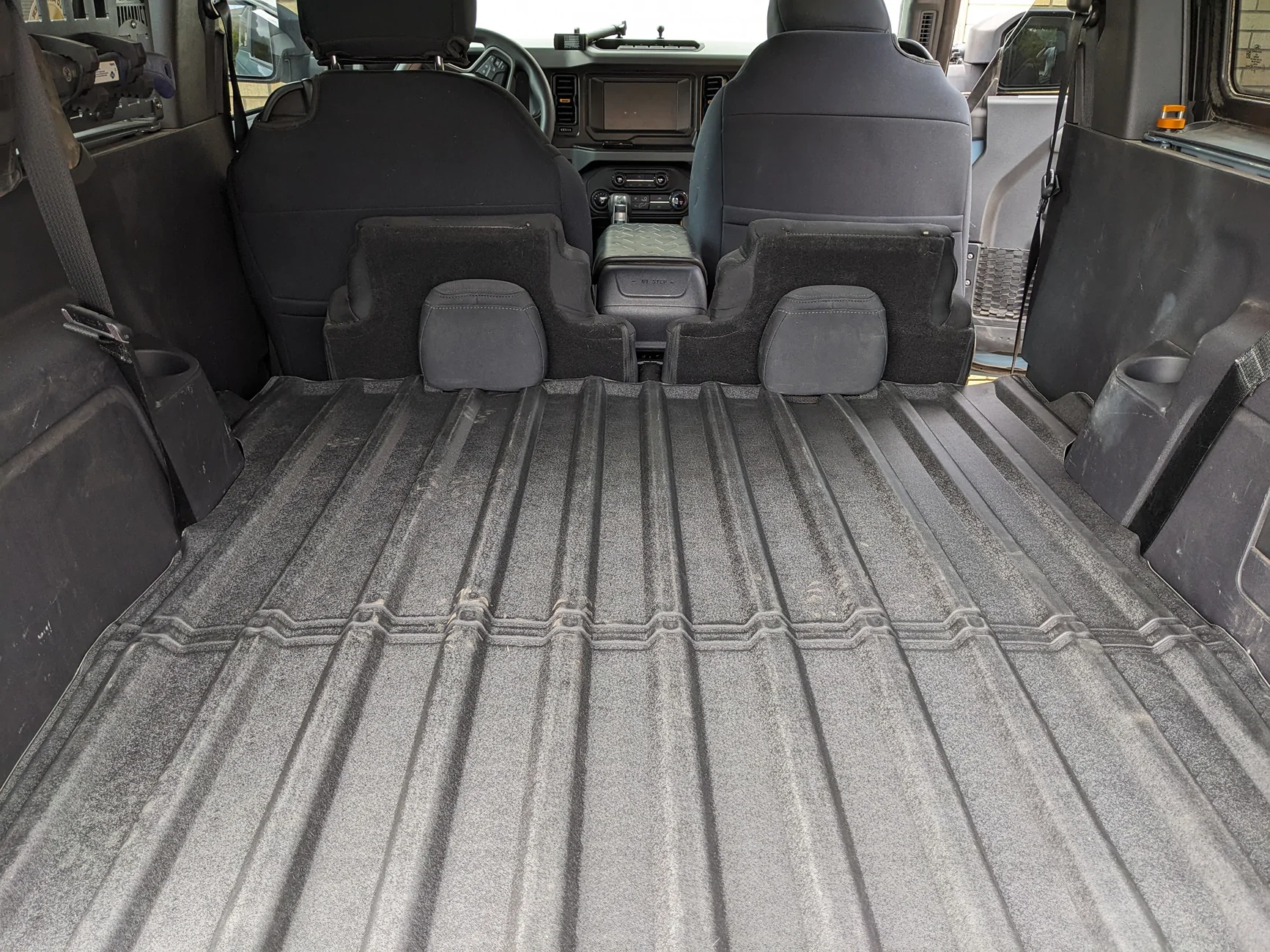

For further concealment I cut up a Ford Maverick bed liner, and now "there's nothing to see here." Plus it's really easy to remove if I need to stuff someone in the rear seats.
