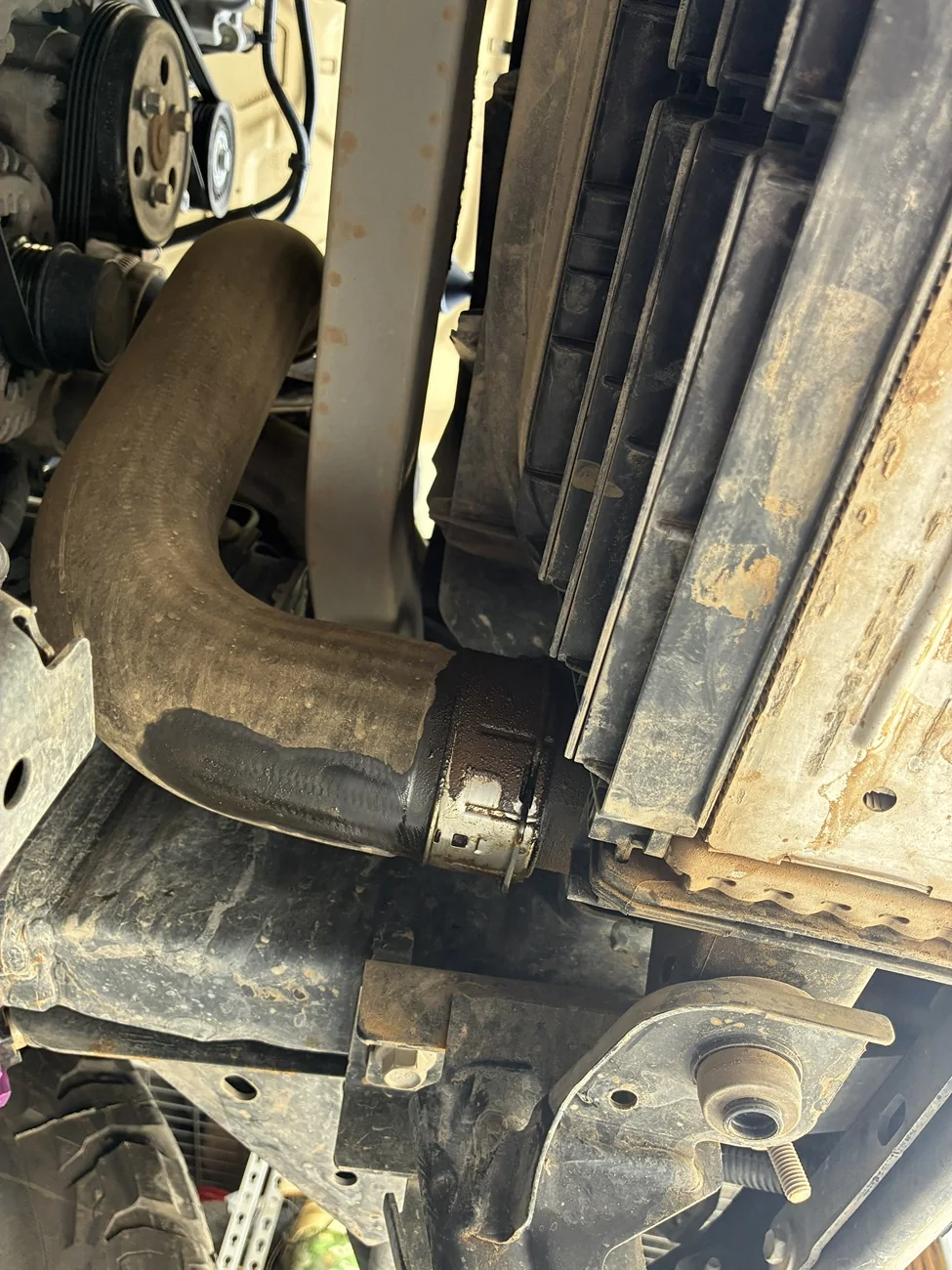

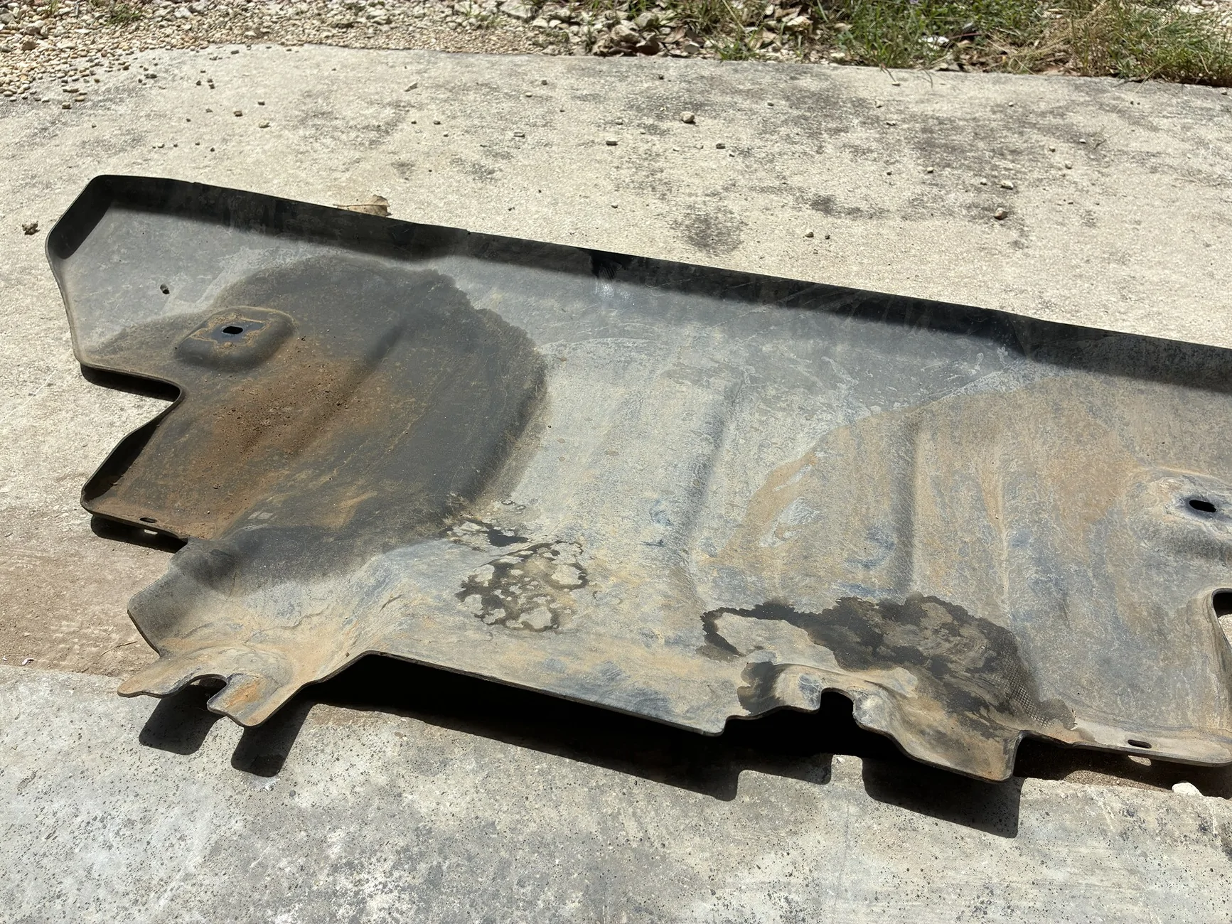

I was doing a transmission, front diff, transfer case fluid change this past weekend and when I pulled the front bash plate i noticed a fair amount of oil , that looked like it was coming from the Charge air pipes right at the boot past the intercooler. usually when you have oil in the intercooler and plumbing that means your turbo is leaking oil into the system. Has anyone else experienced this?

You need to invest in a catch can it looks like. What motor and miles?
