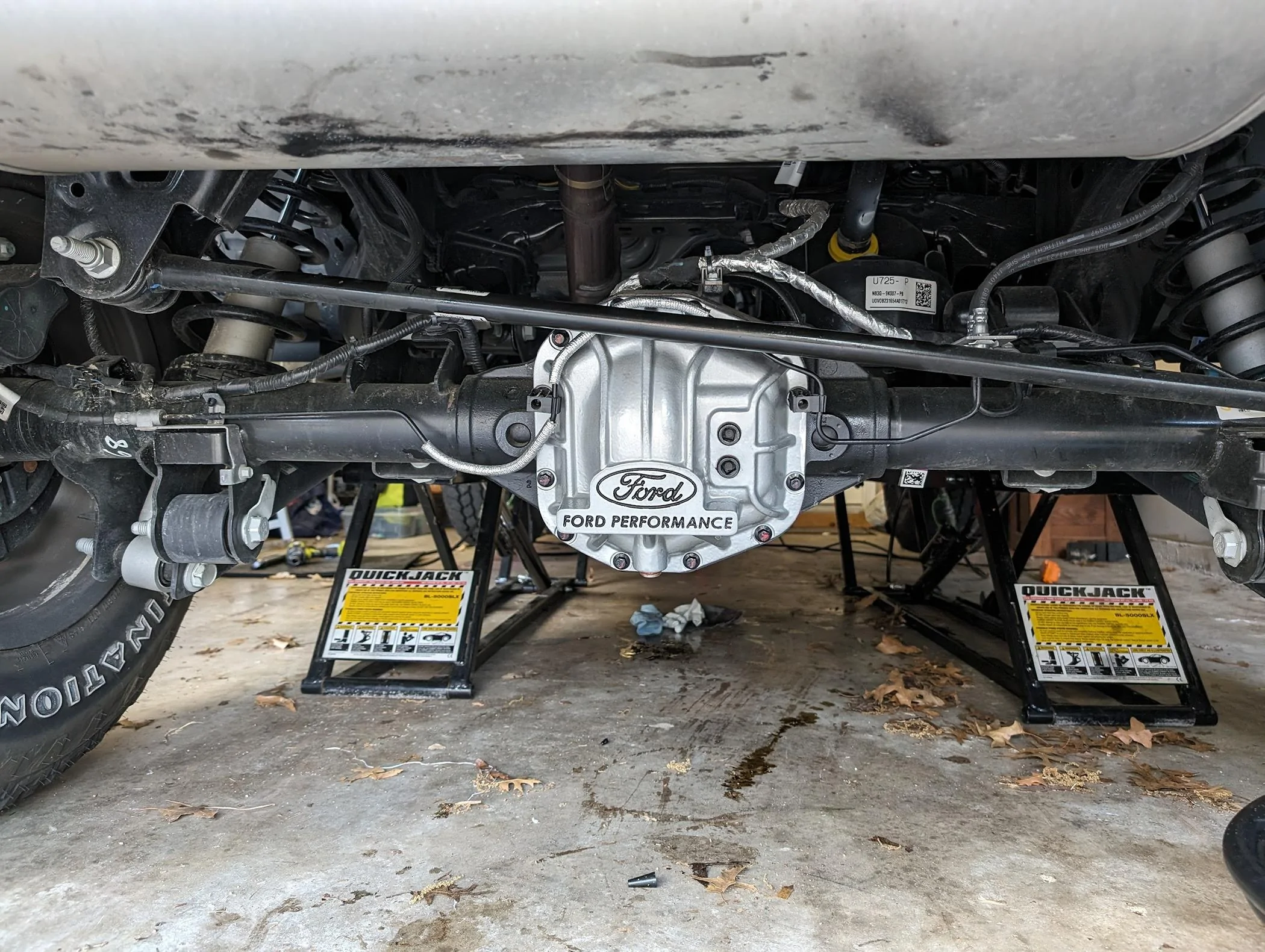

Picking up a new Badlands SAS next week and will be driving it back home to AZ from NY. I've been reading lots of posts related to the need for early oil changes in the diffs, especially the rear but hoping to find an easier way vs opening the cover. Any thoughts on using an extraction pump through the fill hole to accomplish this task? Are people funding aftermarket covers with drain holes?

The Ford Performance one is an example of one that offers a drain port, so no need to remove the cover each time.
Cost isn't bad.
Remove and install maybe 30 minutes, including refill with fresh oil.

It’s arguably just as easy to unbolt the cover as it is to use something to extract the old fluid instead. It’s only a few bolts and the gasket is reusable, so no need to worry about that.

When you pull the cover off there are some places on the bottom of the differential that create small pockets.. It would be iffy for a pump to be able to reach the very bottom of the differential cavity to pull the fluid out of the little pockets. These pockets are the very places the gunk sinks to. I would really like to get a better differential cover but will not put one on until my 2nd draining with the standard cover. This is to get as much of the break in "dirt" out as is possible. If is pretty easy and not real expensive so for me it makes sense. But, some people never drain their differential and get 200,000 miles and all seems OK.

Plus the trick is to leave one or two top bolts loose, so the cover just hangs, versus falling off.
Way easier and more effective than a pump.
Gasket is reusable.
The Ford Performance diff cover is the way to go through with its drain port.
