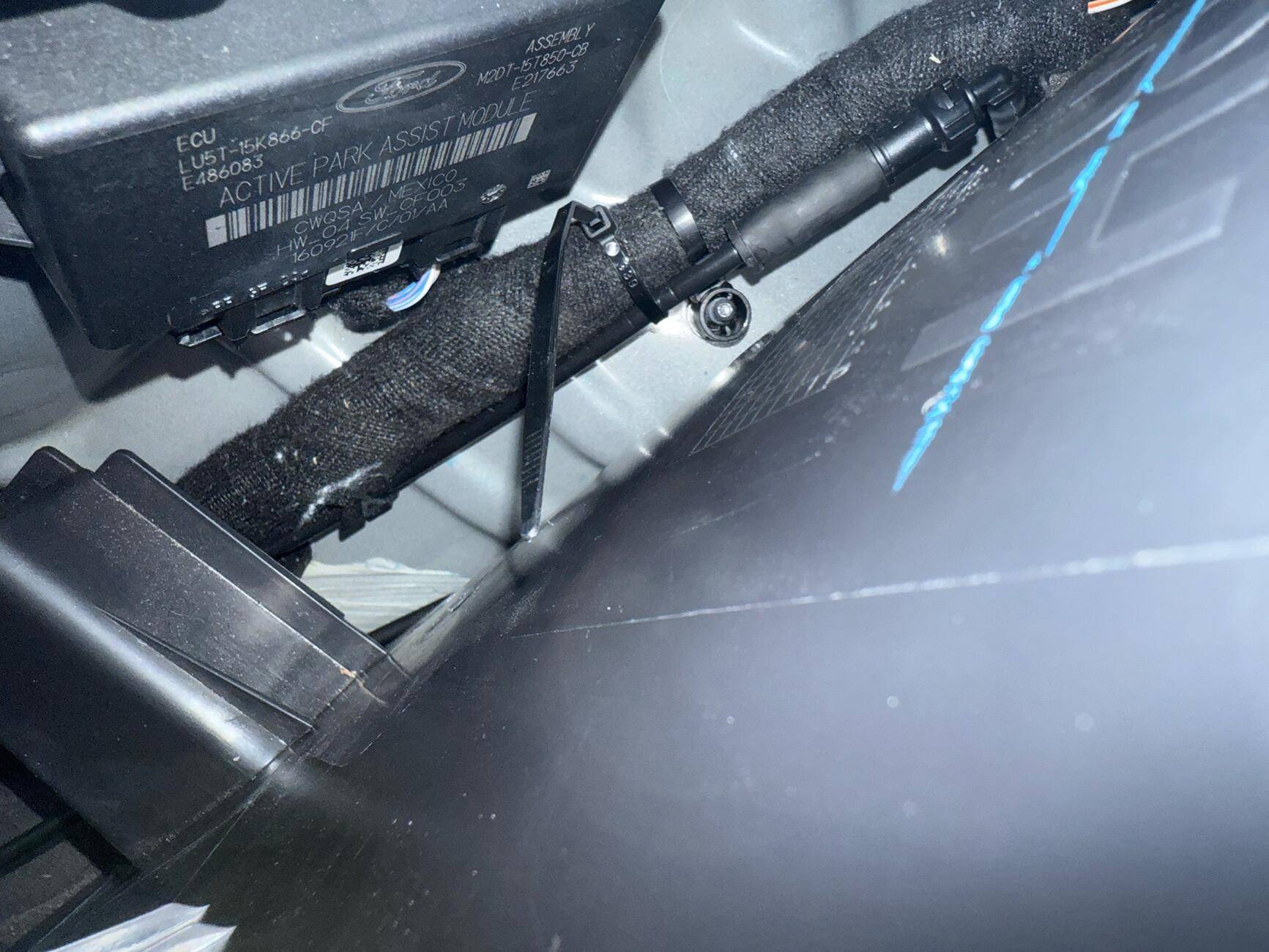

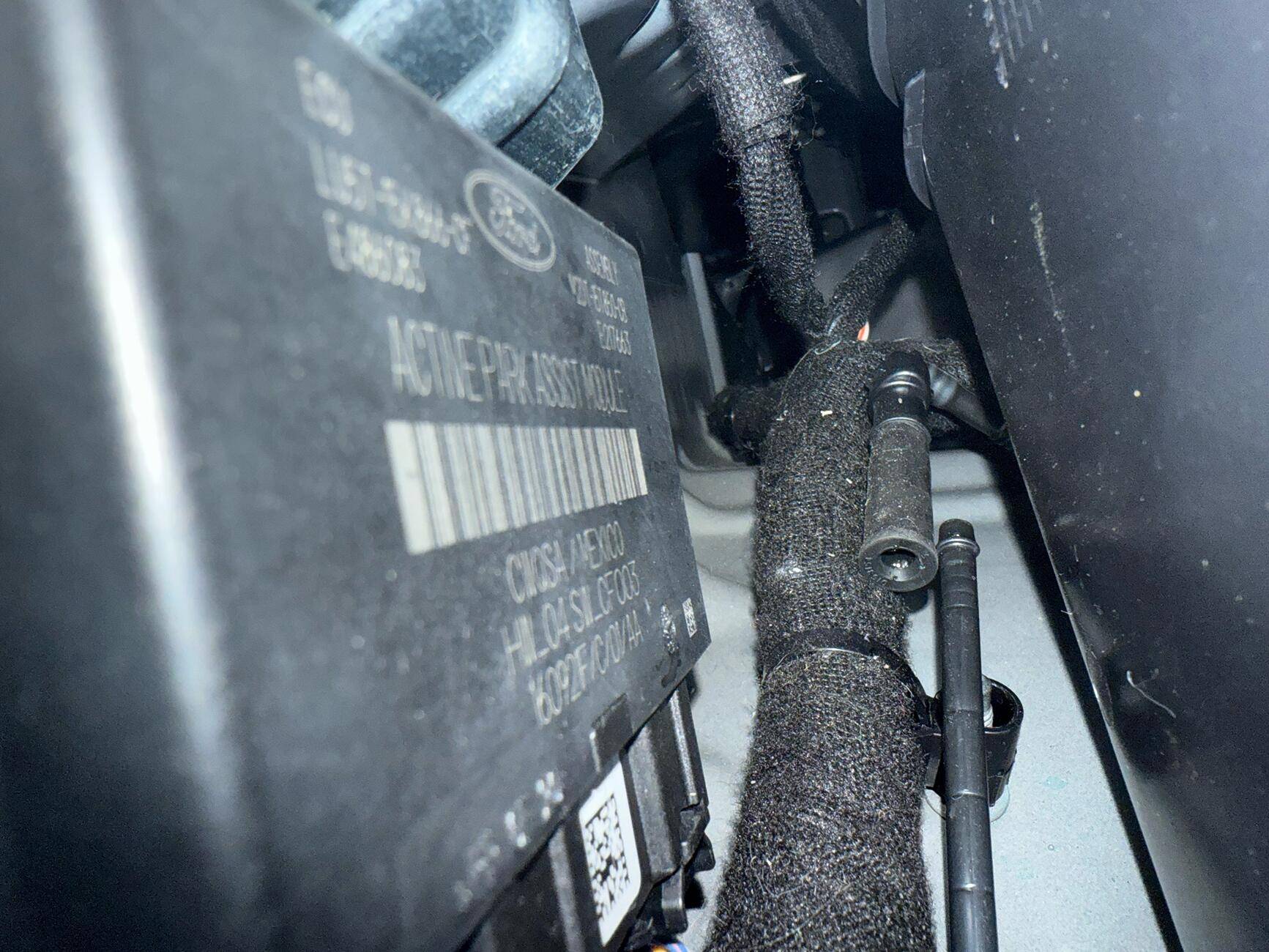

6G Forum Wins again. Thanks guys. I attached some pics for future reference. I also fed a zip tie on the tube...hope that keeps it attached into the future.
