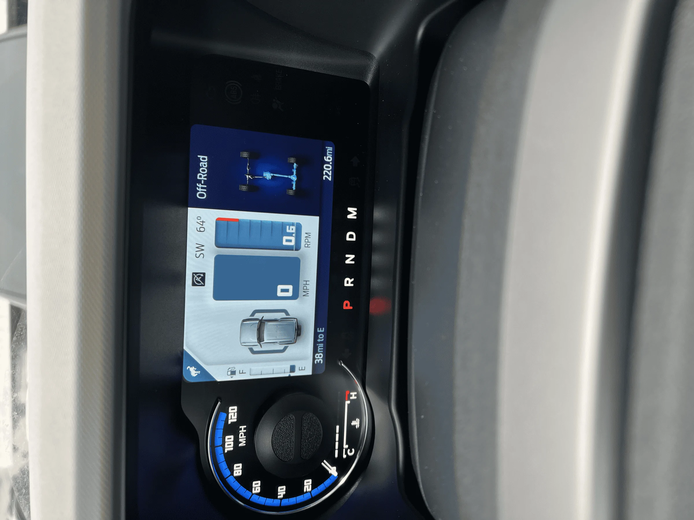

Let my son take my Bronco to the beach and now Off-Road Mode with part of the transfer case lit up blue is on my dash and I can't figure out how to get rid of it or disengage Off-Road mode. Help needed.

^^Thank you but not understanding. I turned the Goat mode back to normal but not understanding, "For where your speedo is just push arrow up/down on right side of the wheel." Here's picture of what I'm seeing.

Use the buttons on the right side of the steering wheel to get out of Off Road mode on the display.

Use the arrow buttins on your steering wheel to scroll to a different screen. There is a YouTube video on the various screens.

To be clear, that screen does not show you are in "Off-Road Mode." It is a display screen that shows what drive you are in and if any lockers are engaged.
It currently shows you being in 2wd. If you were in 4wd the front axle and driveline would also be blue. If lockers were engaged, a padlock would appear over the differentials.
As stated use the buttons on the steering wheel to cycle through the different displays.

Now that you have that out of the way, keep poking the up arrow until you get to "Configure My View" and follow the instructions there. You can select what is visible and what is not when you use the arrows to cycle through the different views. It will only let you choose 7 of the 15, but at least you can make sure you won't see the ones that you don't want to see.
