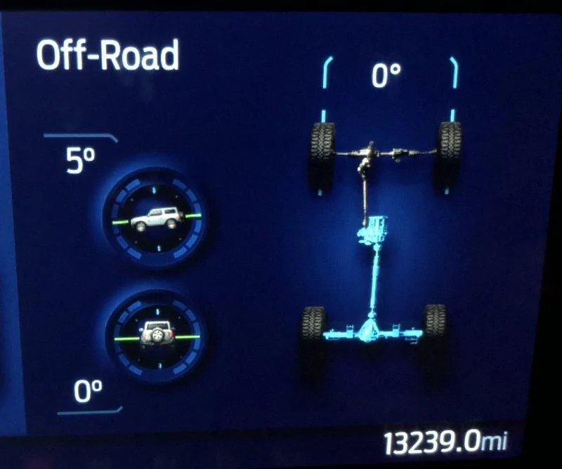

Below is what the Off-Road screen looks like when you're not doing much off road. This was taken just now in my driveway so I could explain what you see here.
The two circles on the left side show pitch and roll. My driveway isn't flat, so it shows a pitch of 5 degrees with the nose down. But no roll to one side or the other. The third "degree number" on the top right shows steering angle. When you turn the wheel you'll see that number change.
If I'm in any mode other than 2H, it will show up below the rear tires on the display and more of the drivetrain will be colored. It has additional indicators if lockers are engaged. If the air pressure has been reduced in the tires it will show the pressure of each tire next to it. I usually drop to about 20 psi in the dirt, so I'll see those numbers by each tire. Even though I have a 4-way inflator/deflator, not all tires will be exactly the same and they go up in pressure as the tires get warm.
This display mode is worthless to me on the street, but is absolutely valuable to me off road.
