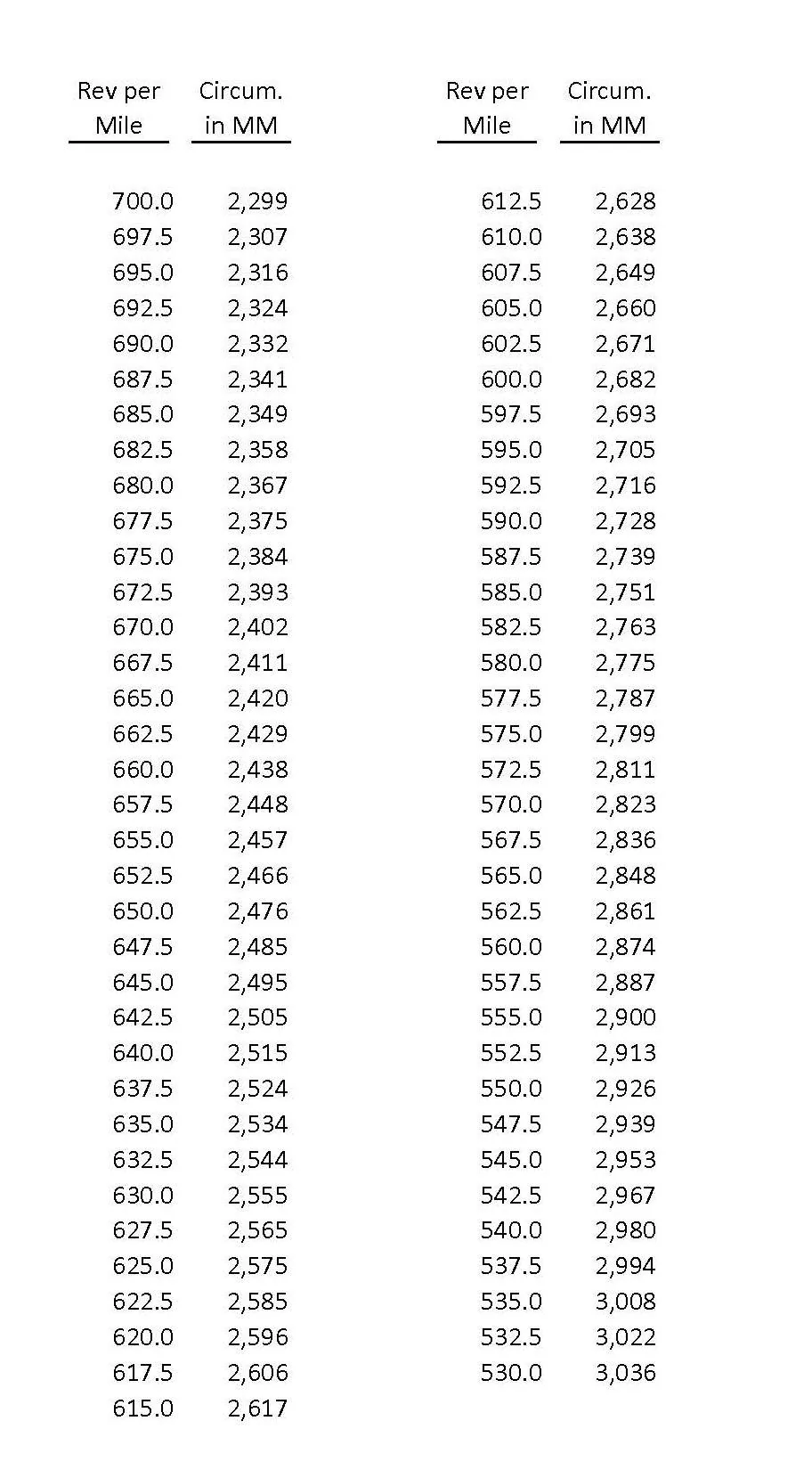

hmmm....that is the correct mm for that size tire. not sure then

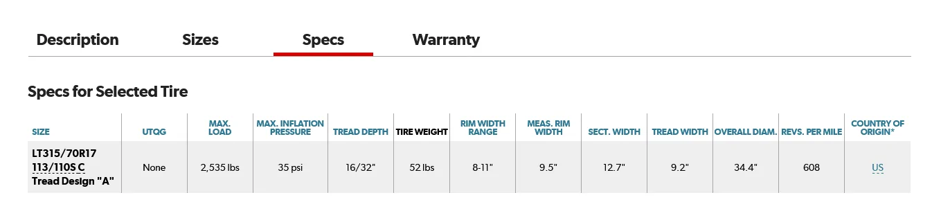

The calculations won’t match. Nitto says my 37’s inflated Diameter is 36.85”
Which would be 2940.5mm in circumference.
Yet only 2800mm in forscan matches every GPS perfectly.
The only way to get an accurate speedometer is trial and error using a GPS.

Hm, I'll add an asterisk to the original post. Sorry for posting then going MIA. We had a death in the family so my Bronco hasn't been a huge priority.
I'll try to go back and confirm the numbers. Anything I put in the table was from a dealership-provided VIN with OEM tire specs shown on the listing, but I suppose there could always be mismatches or changes after delivery.
