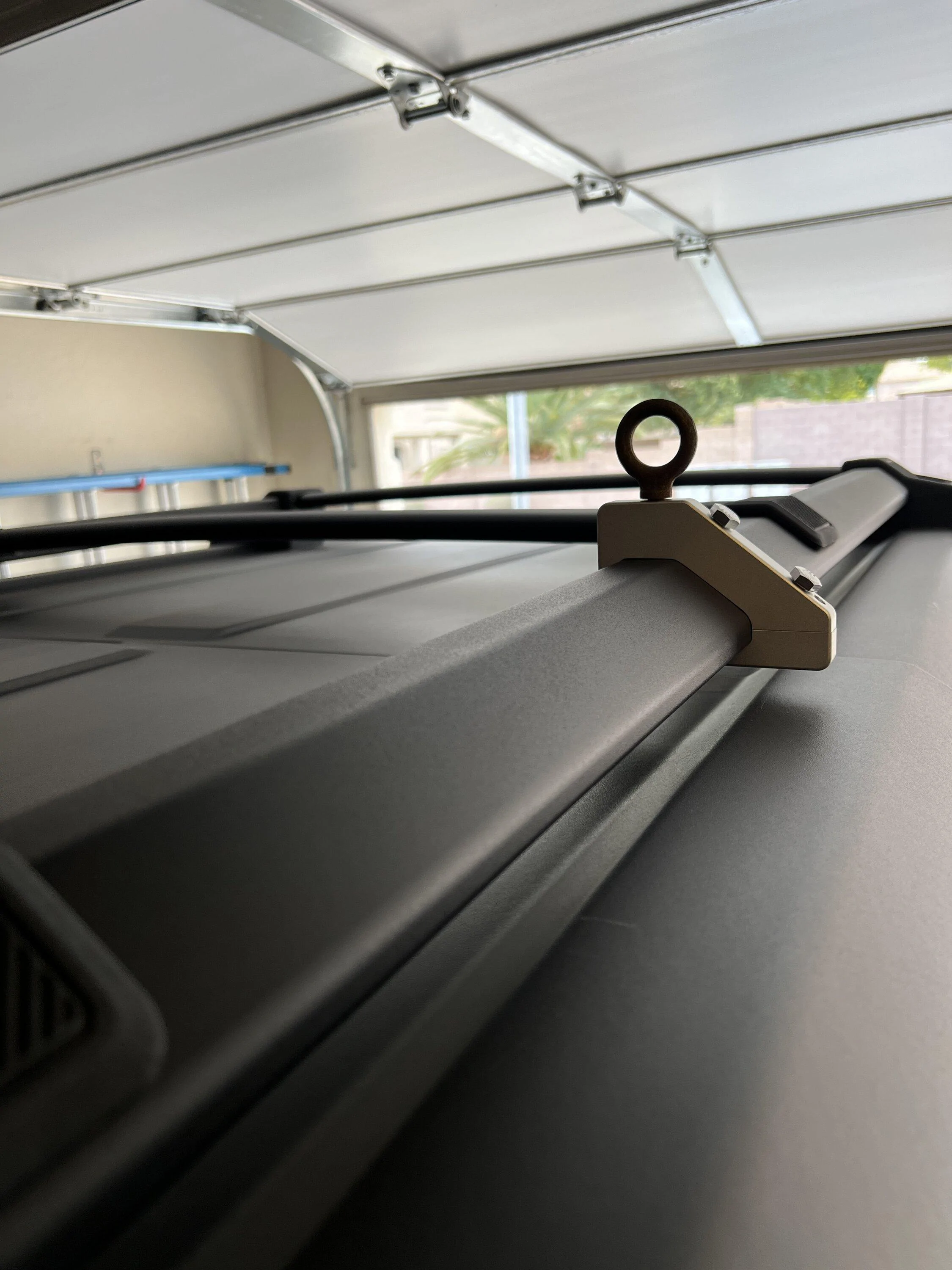

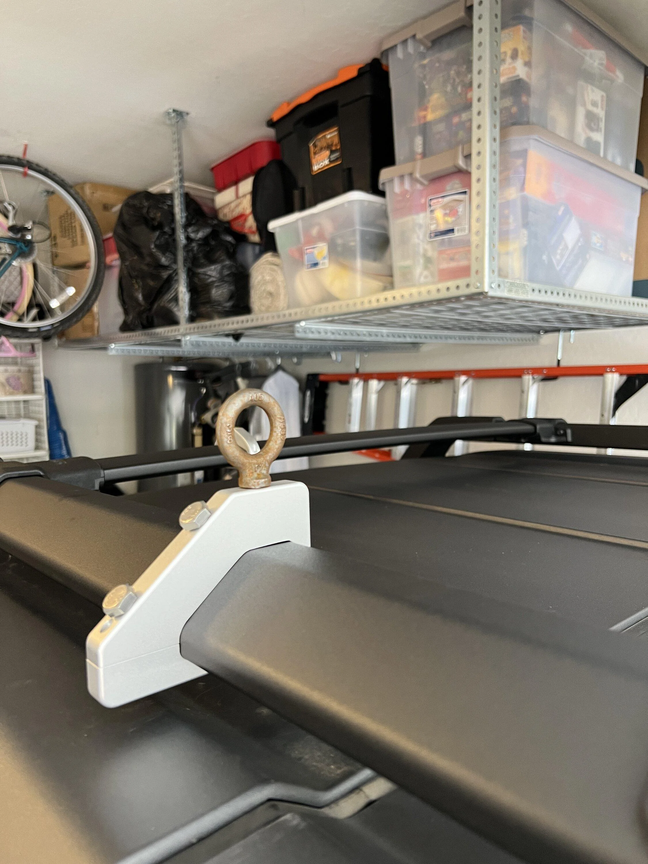

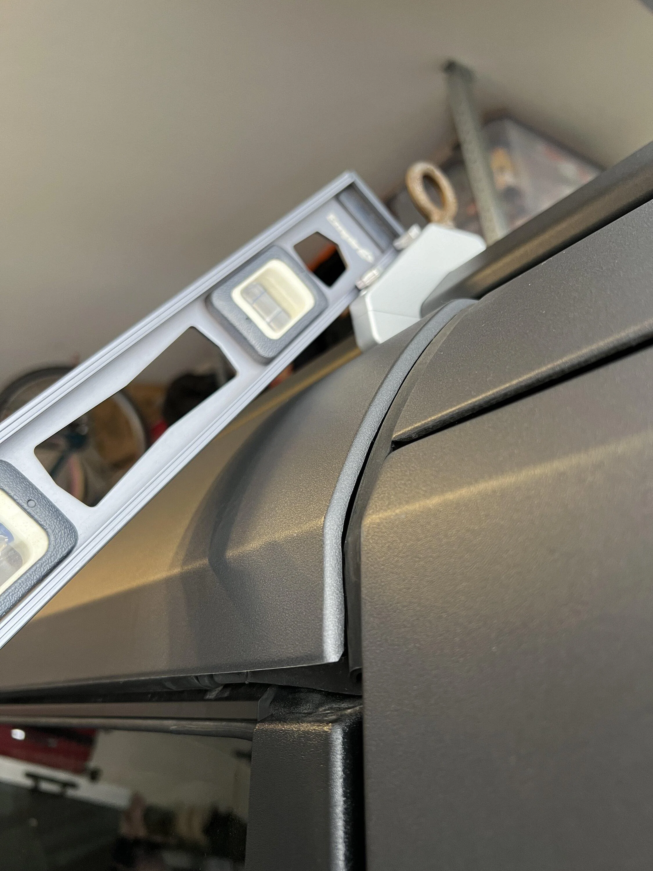

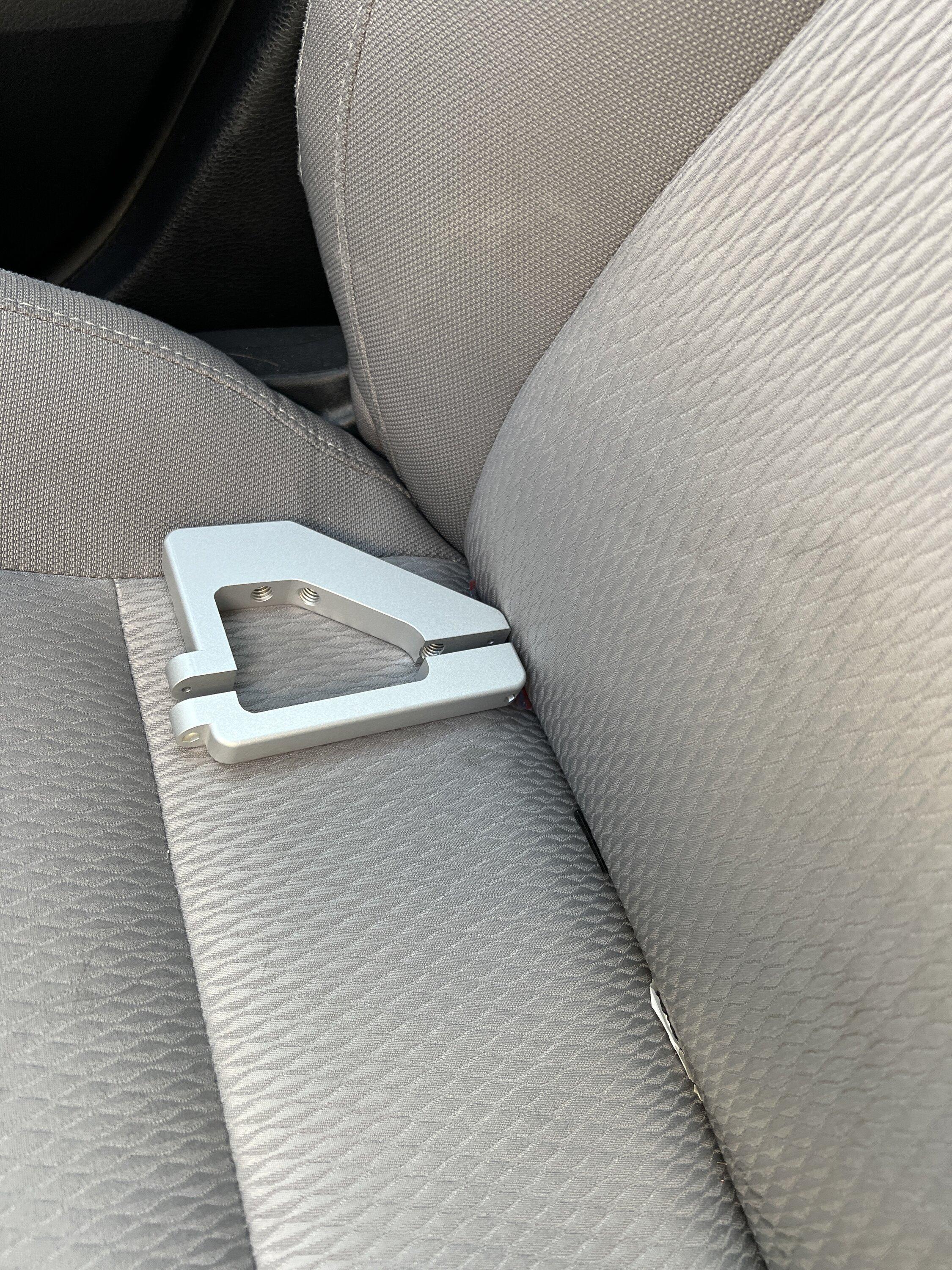

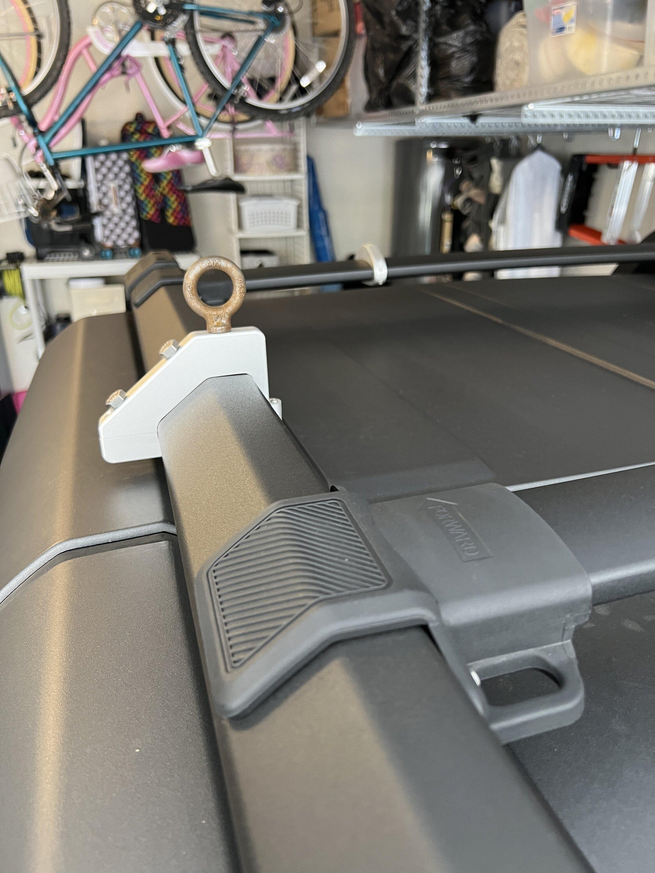

Final prototype came in today and fits very well over the side rail. Finish is consistent all over and threads are not affected by the anodizing. I'm happy with it and as of this post I have opened up the preorder. Slight change to the preorder is I've changed it to be a preorder of 50 individual side rail mounts instead of 25 pairs. Each will include the M3 hardware to secure it to the rail, an M3 allen key, and three 1" hex head bolts.
There is a slight increase in wind noise to be expected, however it isn't very much more relative to how much wind noise there already is. I would recommend installing the bolts even if nothing is mounted to limit any potential whistling sounds.

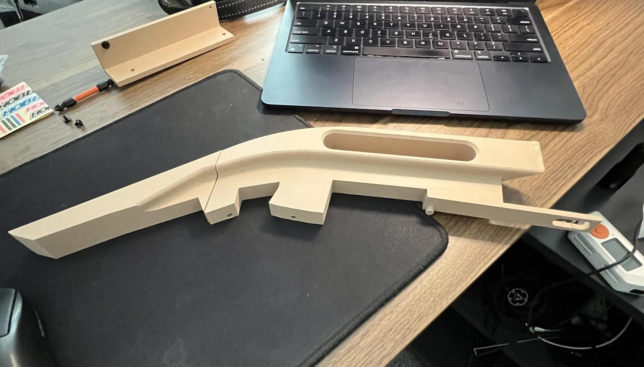

On another note, I have been working on replicating the hood tie downs to make them out of solid aluminum. I've got the mounting holes lined up, and now I'm working on adding in accessory mounting options. I would imagine this will be quite a bit more expensive to have machined but would probably look really sweet on the hood. If I end up ordering some for myself I will be sure to add them on PCBway as well.

The quote on getting a machined version of the hood tie down was 1k usd each so for now I will just use plastic if I want to have my version on there. I figured I'd also share those files here if anyone wants to make something of their own with it. It looks very similar to the above picture other than several more holes for mounting, some cosmetic changes, and changes of the mounting locations for better fitment. Here is the google drive link to the stl file for it which can be sent to any 3d printing service.
