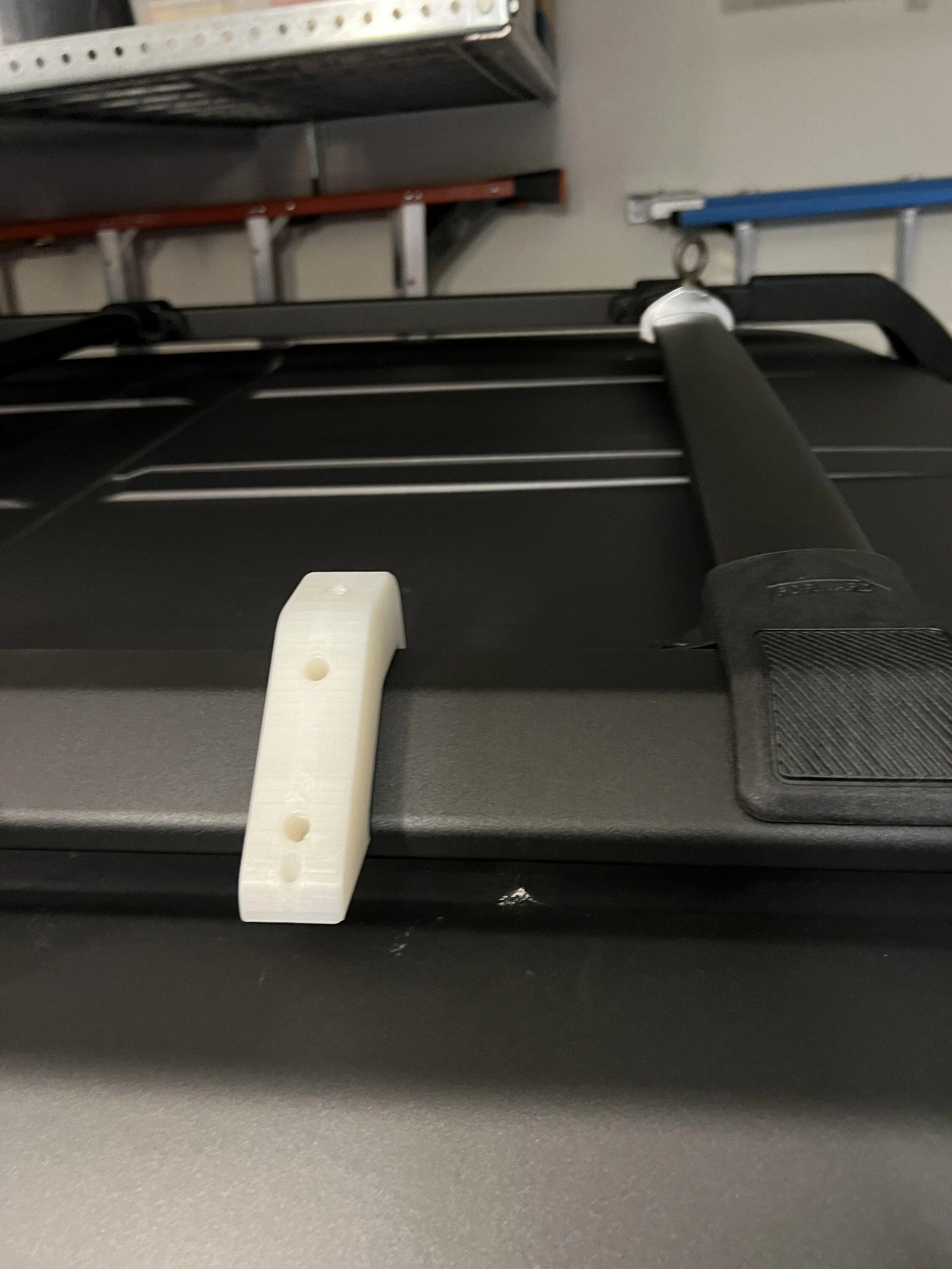

Should have a side rail plastic prototype within a couple days. 2" from center points on the two holes on the angled side. If I do a run I was thinking of including 2x crossbar mounts and 2x side rail mounts but it's going to be in a preorder fashion.

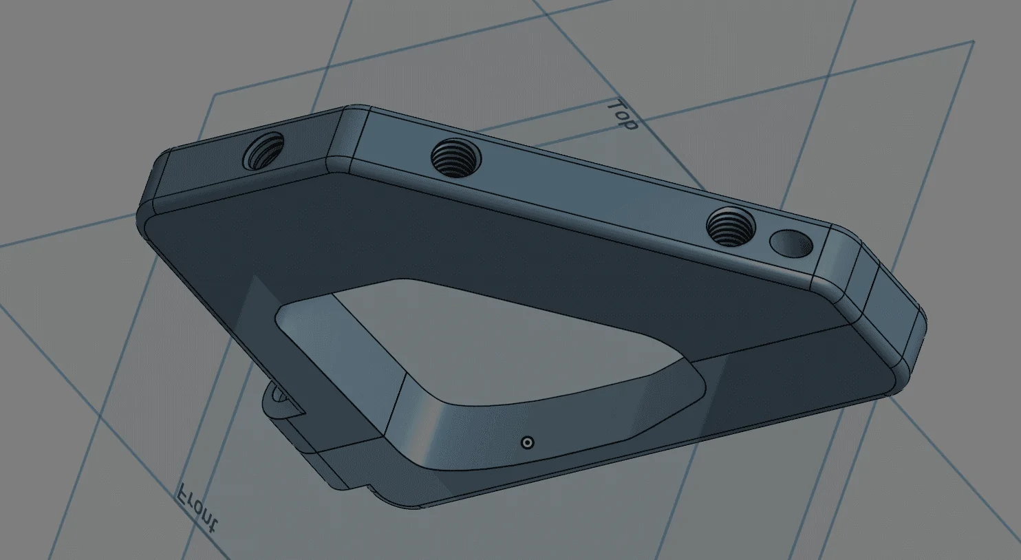

There is a single vertical hole and then the two angled for a total of 3 threaded holes

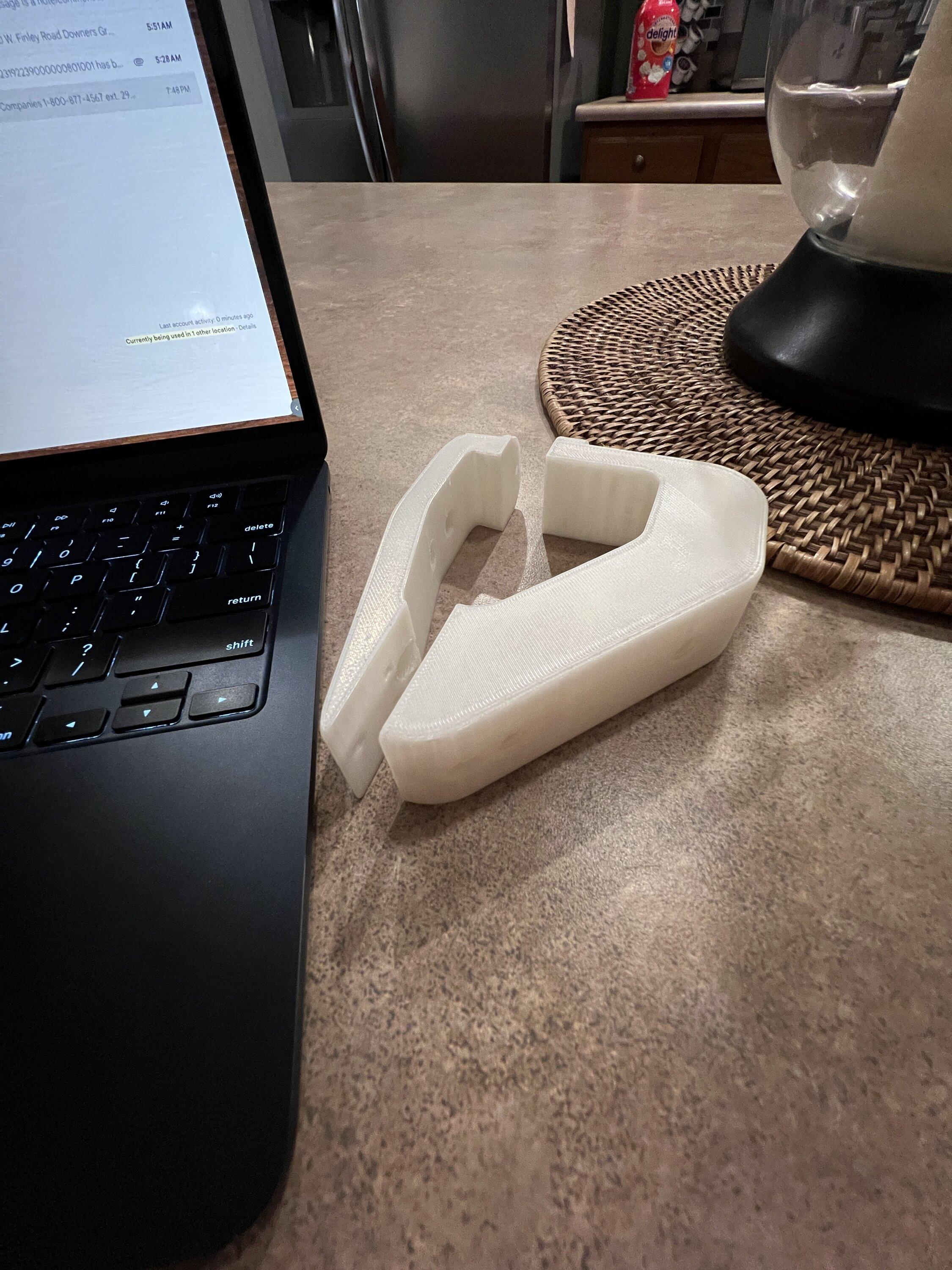

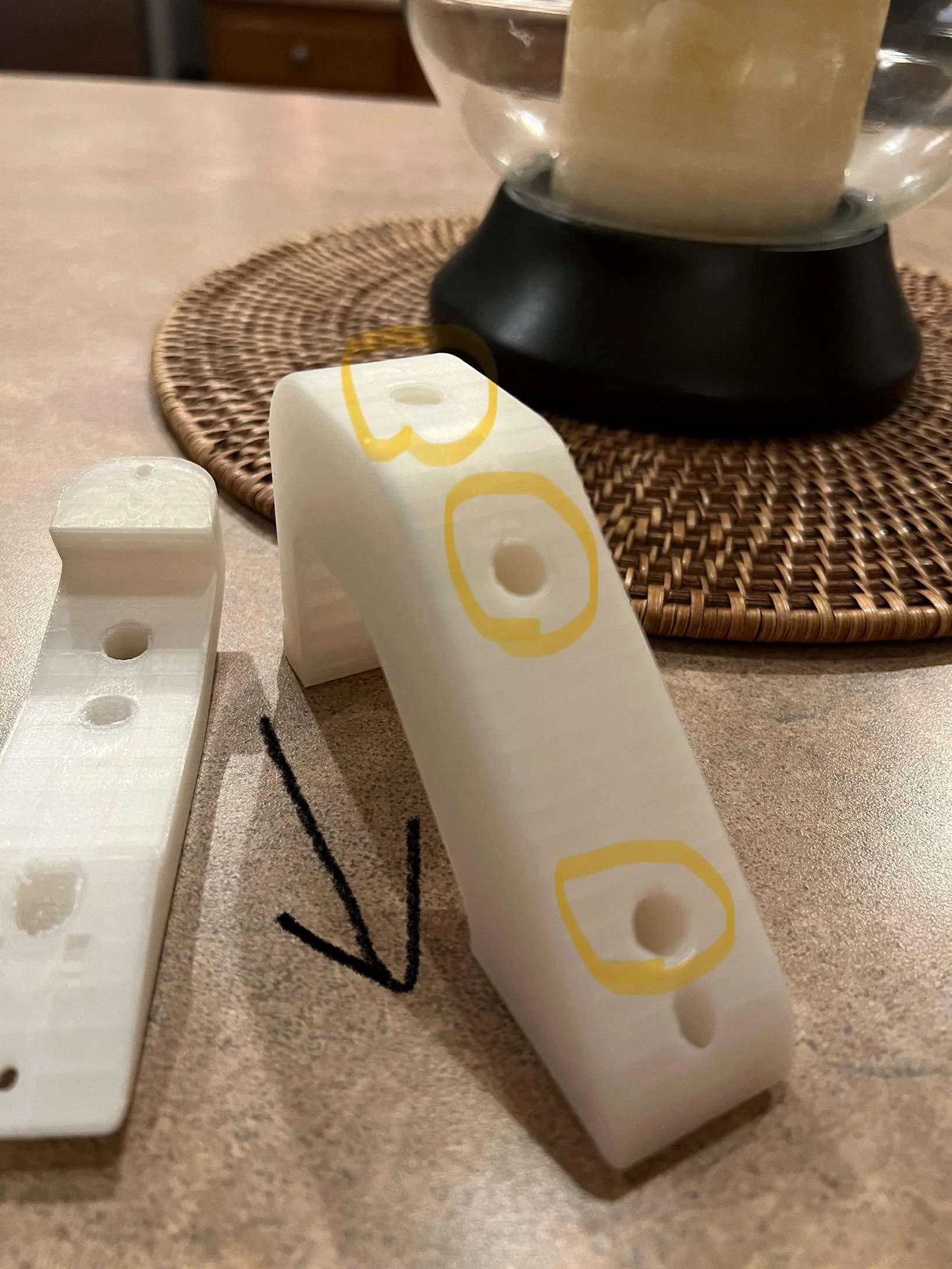

Prototype is in but needs the bottom piece reprinted. I’ve marked it up to dhow the holes and some directionality. Highlighted holes are threaded 3/8 16 and the arrow points to the outside of the bronco. The aluminum version will be slimmer width wise with everything else being the same. Will this bolt configuration work for those wanting to use it as an awning?

We need some folks with awenings to measure the hole spead for their mounting brackets. I mean you could always drill new holes but it would be nice if there was a "standard" out there.
That bottom hole may be tough to get to once you bend whatever bracket to get your vertical mount surface

The more I look at random google searches for awening mounts the more it seems like that angle could be problematic.
All the brackets look to either want to bolt horizontal with downward bolts, or vertical with sideways bolts.
I found one set of universal brackets that it seemed to allow you to angle, but they are $70.
Now of course for possibly mounting other things, the angle may not be an issue.

I think your concern is with the angle of the mount hitting the roof. I don’t think it will be too much of an issue. Tough to get scale from the first images but it isn’t small.
