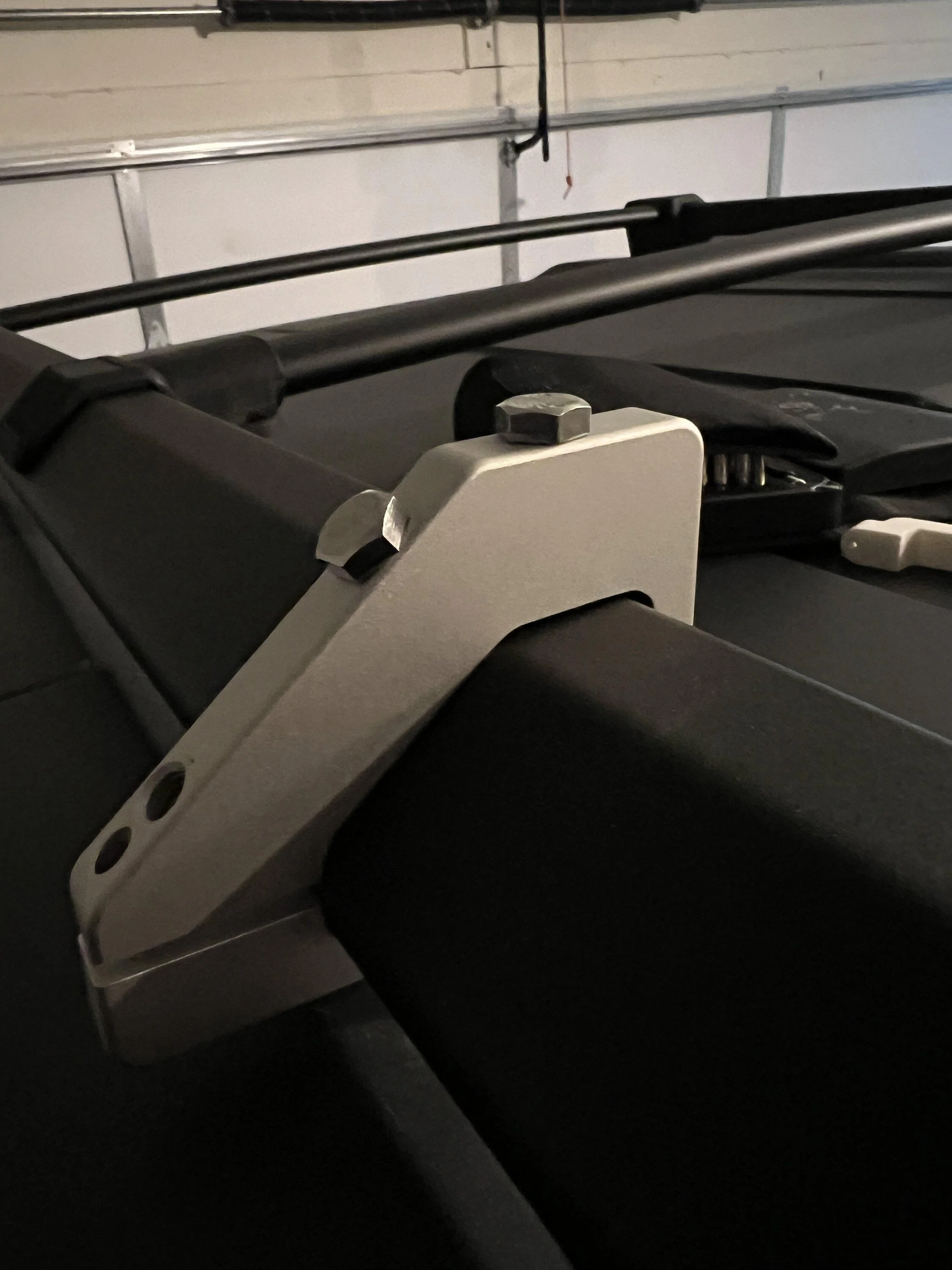

Very cool idea. I like the use of the factory roof rack. Wondering if i could mount my Hi-Lift jack to the side rail mounts, for easy access. I'm sure the cross rail mounts would work as well.

Website is joshuafisk.com. Currently the preorders are not live but I will enable the preorder option after I have the aluminum prototype to ensure everything fits properly. Currently focusing on the siderail mount but if there is interest on the crossbar mount I can do a preorder for that as well. Current plan is a run of 50 siderail mounts that will be made of bead blasted 6061 aluminum with a clear anodizing. They will be sold in pairs so for the first batch there will be 25 pairs of the siderail mounts for the preorder. Pricing is looking like around $150 for a pair of siderail mounts so that would be two top pieces, two bottom pieces and the m3 bolts and locknuts to secure them around the bar.

CNC prototype came in a few days ago. The tolerances were too tight on the cnc aluminum version to go around the sidebar where the 3d printed plastic prototype bent just slightly enough to go around the sidebar. However I have made adjustments to the design and have a new cnc prototype on the way. On a positive note the clear bead blasted aluminum looked very good in my opinion and the anodizing did not affect the threads. The color of the aluminum after the clear anodizing was close to space gray.

Mabbett was one of the companies I reached out to with unfortunately with no response. I would have much rather worked with a manufacturer to produce this but after no luck with many of the major bronco manufacturers. I decided to source them myself and offer them. Being just me the idea of floating large amounts of money to offer them in a non preorder/batch fashion isn't appealing but I am trying my best to get these in the hands of the Bronco owners that want them.
