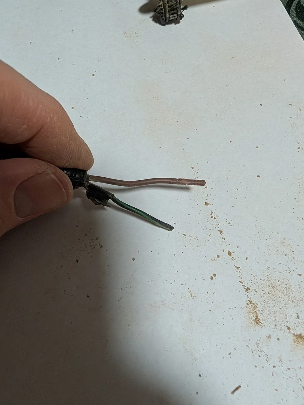

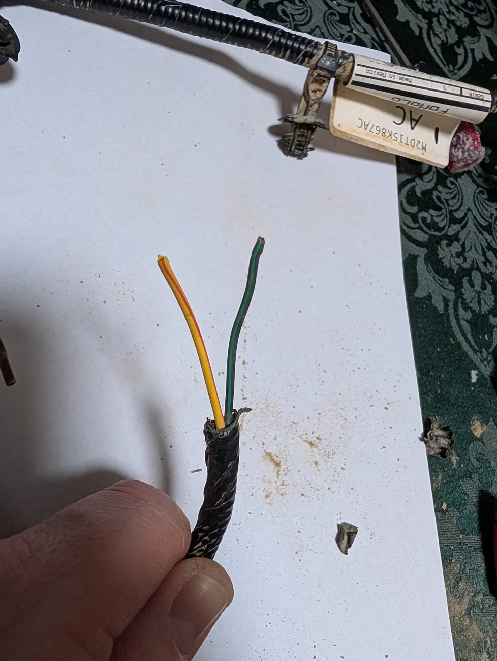

I am in the middle of a bumper replacement, removed the OEM capable bumper with factory fogs, and splicing in some aftermarket LED fog lights in the new bumper. Rather than worrying about finding a compatible plug I am just going to hardwire the new lights into the harness. Just checking my electrical theory here… The common wire between these two lights is black with a green tracer. I assume that is the ground?
On the driver side. The second wire is solid brown, and on the passenger side the second wire is yellow with a red tracer. But both sides have the black with a green stripe. Here are a couple pics.
Black is normally a ground wire in automobiles. Ford uses black with various color tracers for ground wiring in all the diagrams I've seen.
But instead of guessing, use a volt/ohm meter and measure them.
I'm surprised that the supposed hot wires are different colors. But then I don't design wiring harnesses.

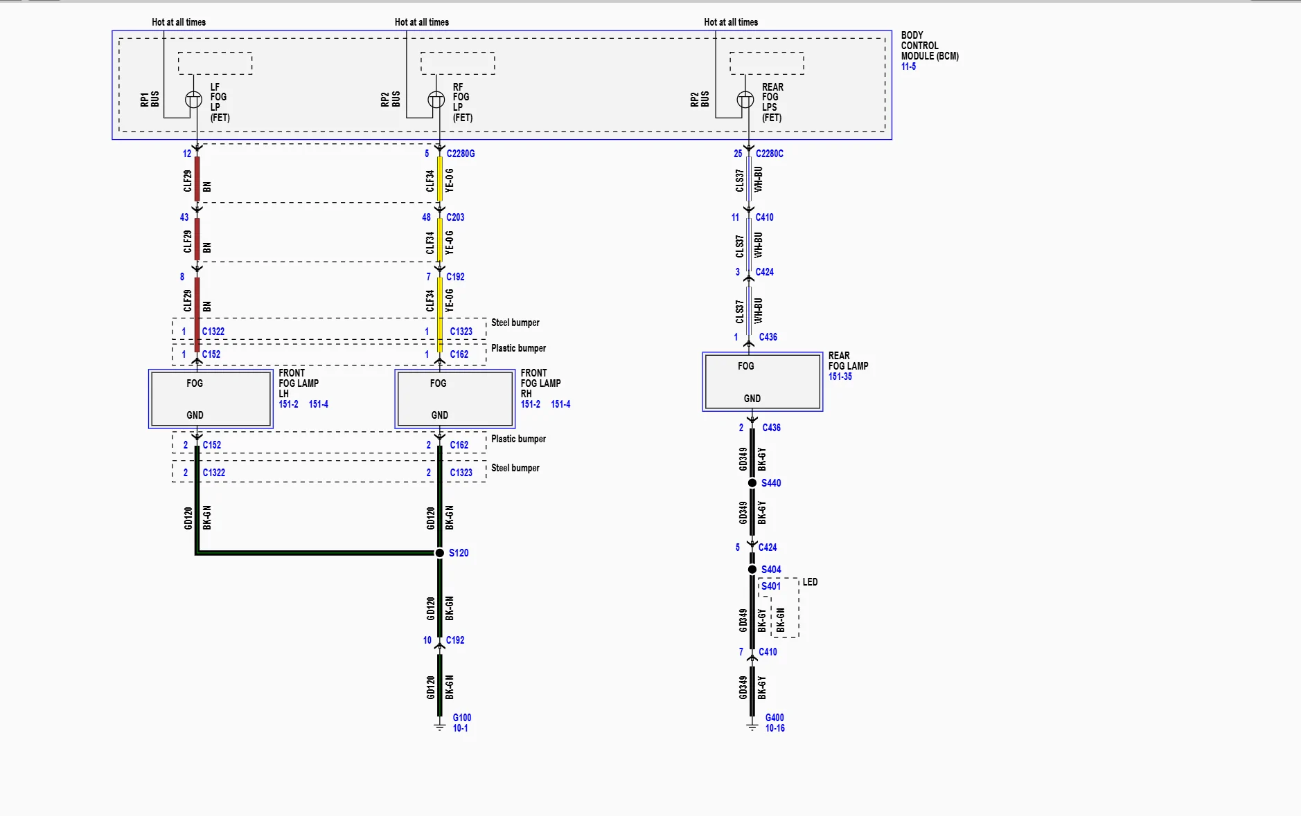

Ford does or at least did some odd stuff with wire colors, especially ground. Black/green, black/white, black/red, black/grey, etc. I've even see some black that were power. The reason for multiple ground combos is mainly for testing identification since you could have 10+ ground circuits going through one harness and if you're trying to find a specific wire to check open/continuity, if they're all the same color there's a high probability of getting the wrong one.
Don't ask how engineering determines what color combos they use, I have no idea but was told they were going to go with a one piece harness (no or few inline connectors) sometime this decade. That was a couple years ago and haven't heard anymore about it but that could really make fixing or replacing, interesting.
