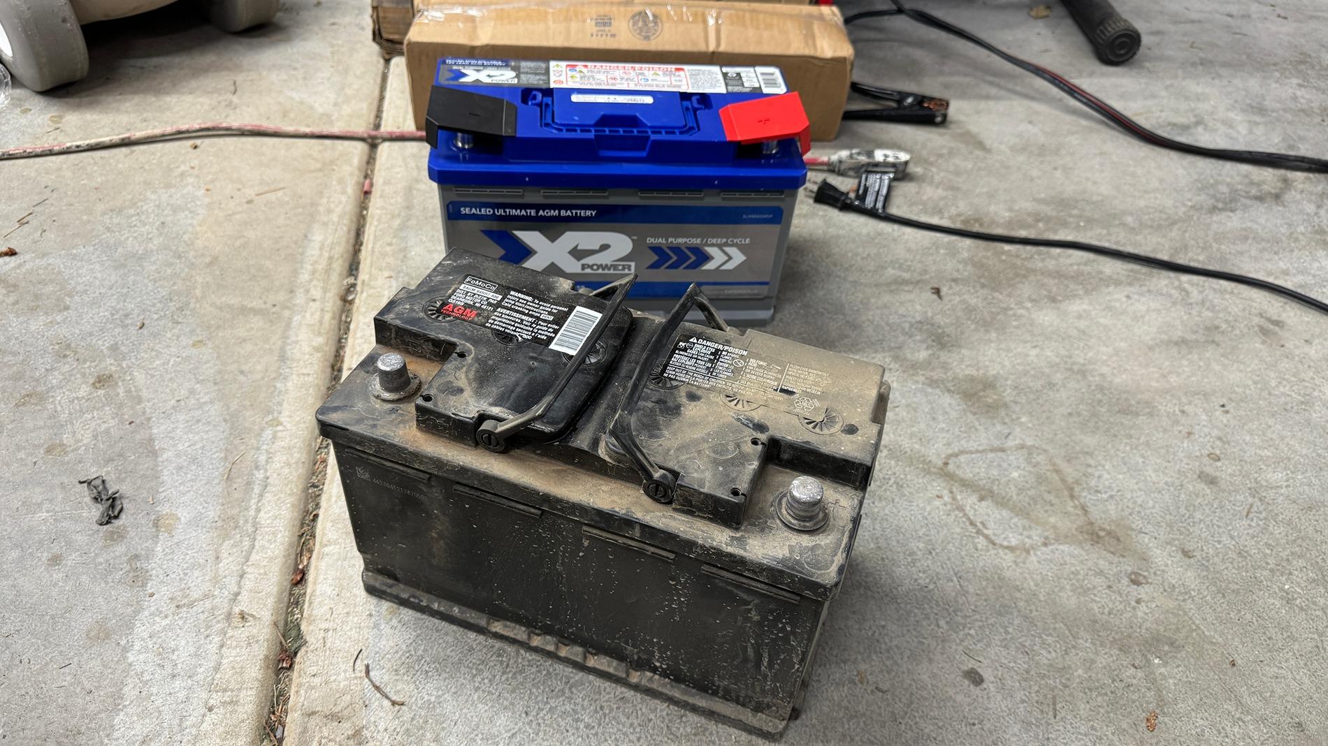

I replaced mine at 32 months, it was dying well before that. My Duramax OEMs lasted 11 years, so who knows.
