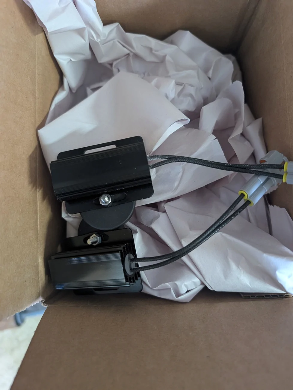

got the new resistors today, they came unbranded, but looks the same. Just finished up putting them on (takes me about 20 minutes to replace the lights now-a-days), Initial test was working just fine, going to leave the bronco outside for a bit since its around 20 degrees here, and will update if its confirmed to finally fixed the issue.

So yea, the new resistors do not fix the issue, while initially they worked, after driving around for about an hour, they hyper-flashed from time to time. Perhaps some progress was made as before the turn-signal would always hyper-flash, now its less frequent therefore hard to pinpoint what causes it. Coasting in gear, turn-signal on, come to a stop caused it a least 2 times in the hour I drove it. 15v to 13v battery jump? I dunno.
Still unacceptable imo and have already sent them another email.
Ill be leaving them on for the time being to try and get a proper video of the issue.

so the good news is that they are keeping an open dialogue with me and have been helpful dealing with this, the bad news is that it's believed that new resistors might not fix the issue entirely, I got this message from them
Voltage regulators in the alternator shouldn't really allow the voltages to get much higher than 14.4 volts. This is the voltage that all of our products are designed to be their maximum, so with them getting higher than that, this could ultimately be part of the problem.
and then the potentially really bad news
If this 15volt issue persists, it's possible that the taillights may not be capable of working correctly without a complete redesign, but I'll let the R&D and engineering team make that kind of call.
I'll keep y'all posted ofc
