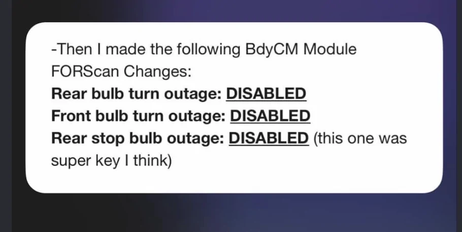

made these changes with Forscan. No probs since.

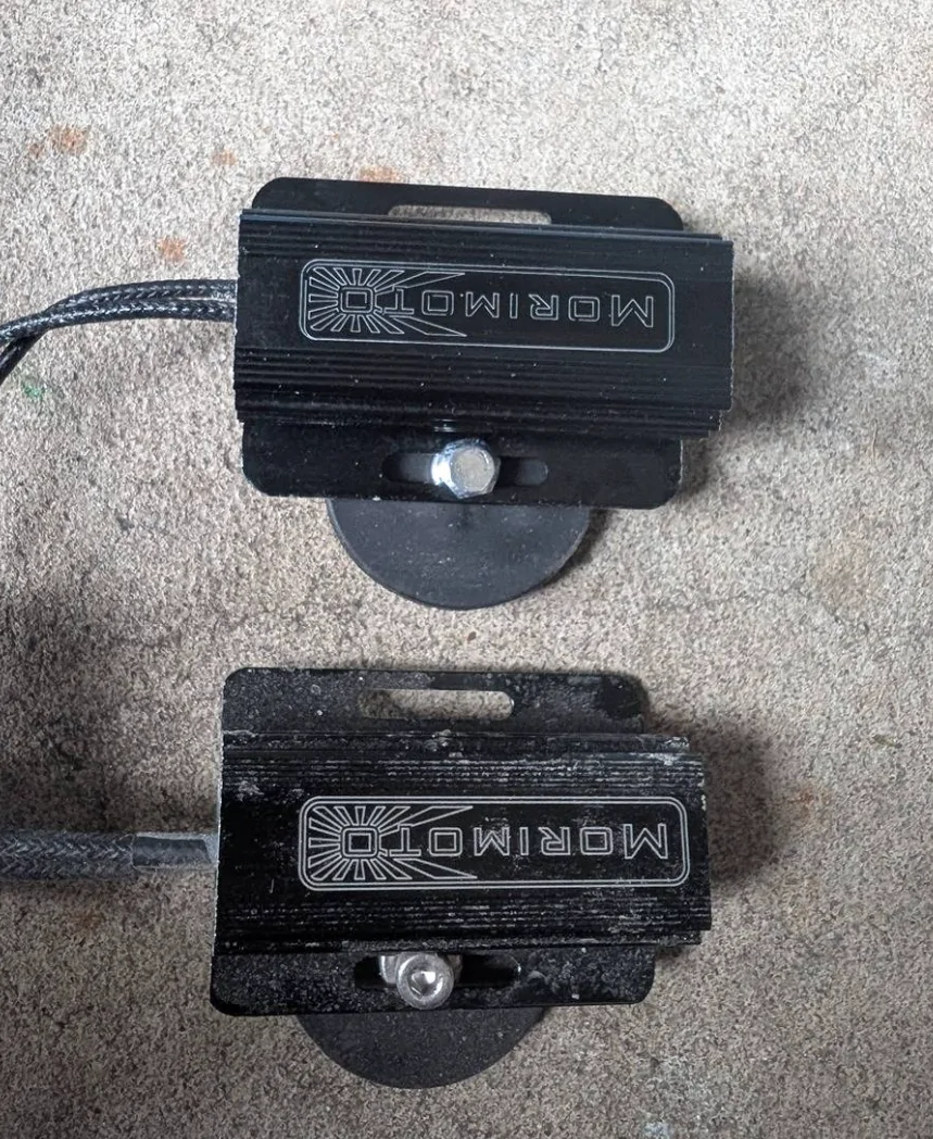

Anyone have a pic of these resistors Morimoto designed with their lights?
They should have a heatsink on them and be rated for at least 50w if you plan of them lasting more than a couple of months

Any idea if you can leave a faulty resistor in place and make the Forscan changes?
Preemptively expecting these to crap out and it’s a challenge to remove the passenger tail light with the Turn Offroad HD carrier in place.
Not my photo. The bottom is the original one. The top is the updated one that was supposed to solve the issue. Plenty of heatsink.
Ford Bronco Now that it's getting cold... re: Morimoto XB Tail Lights issues? 1763055636660-u5
Since the FORscan changes would be eliminating the alarm that the resistors are designed to prevent from tripping, I would assume you'd be fine. Just have to periodically check that all of your banks of LEDs are still functioning since you would no longer have a fault indicator.
