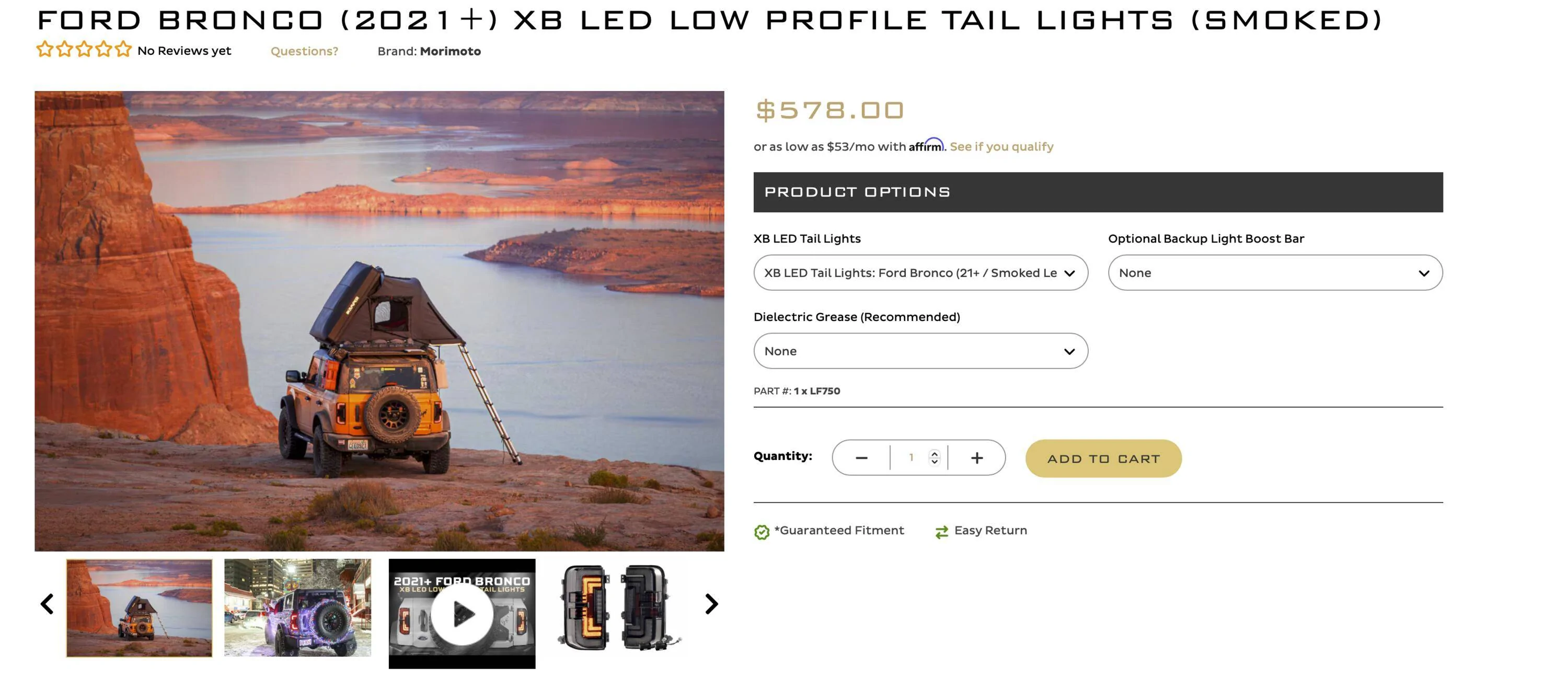

new? Where from?
Oh crap. Looks like I scored a set before they realized they never adjusted their site with the recent price increases. They were listed at $495 and now they’re $578. But with the BLACK discount code they’re currently $532.34 shipped at Panda Motorworks.
