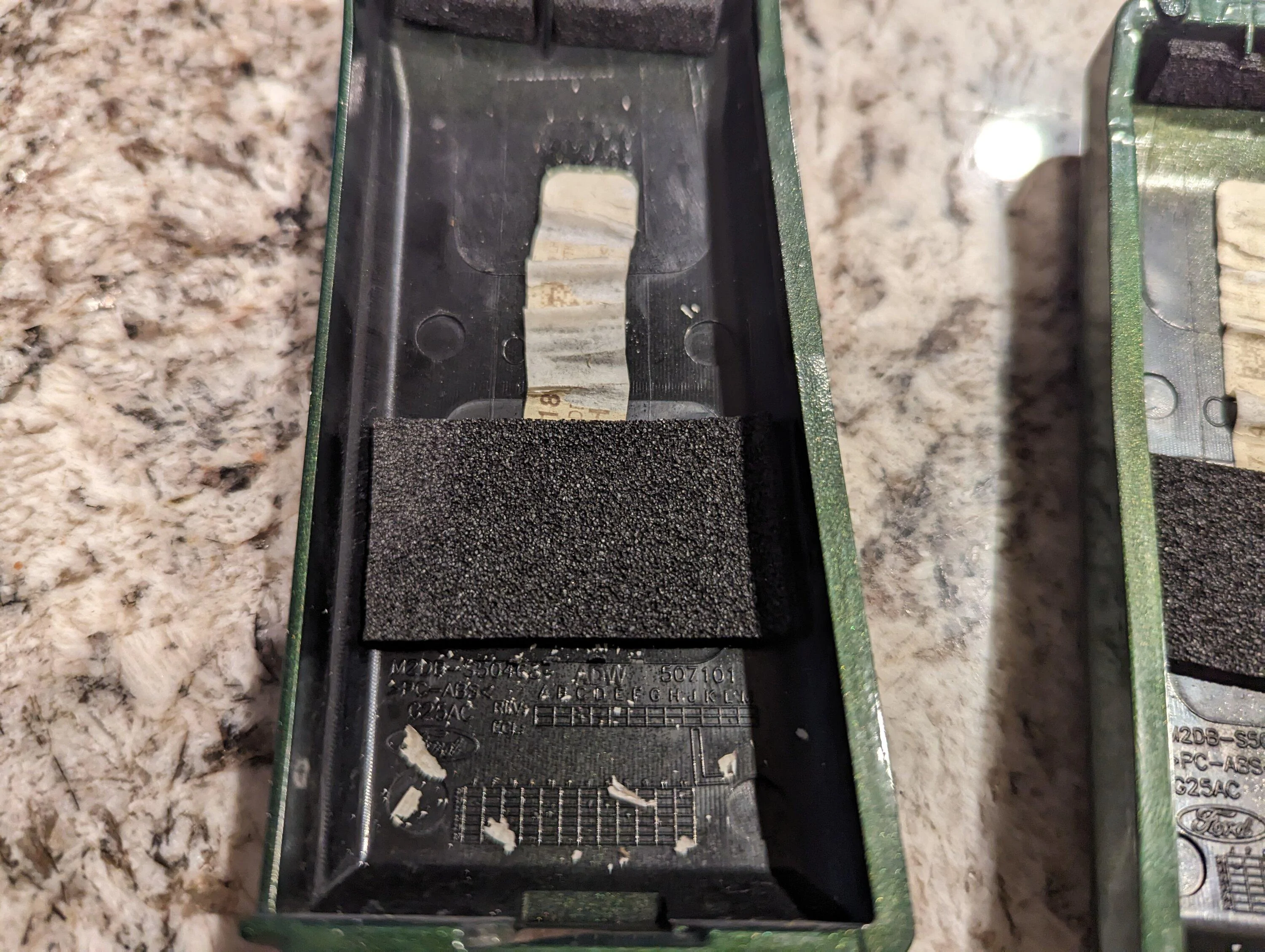

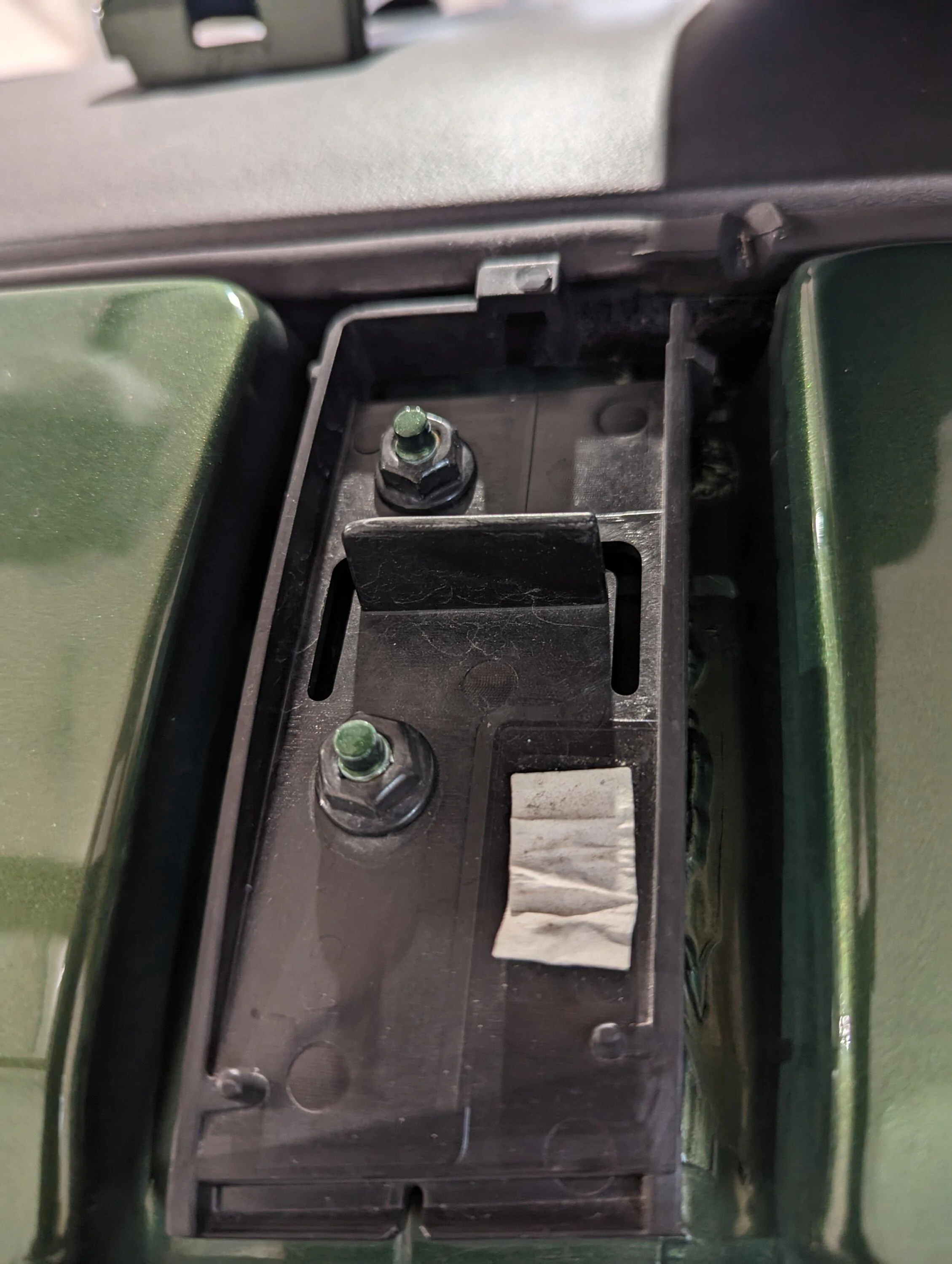

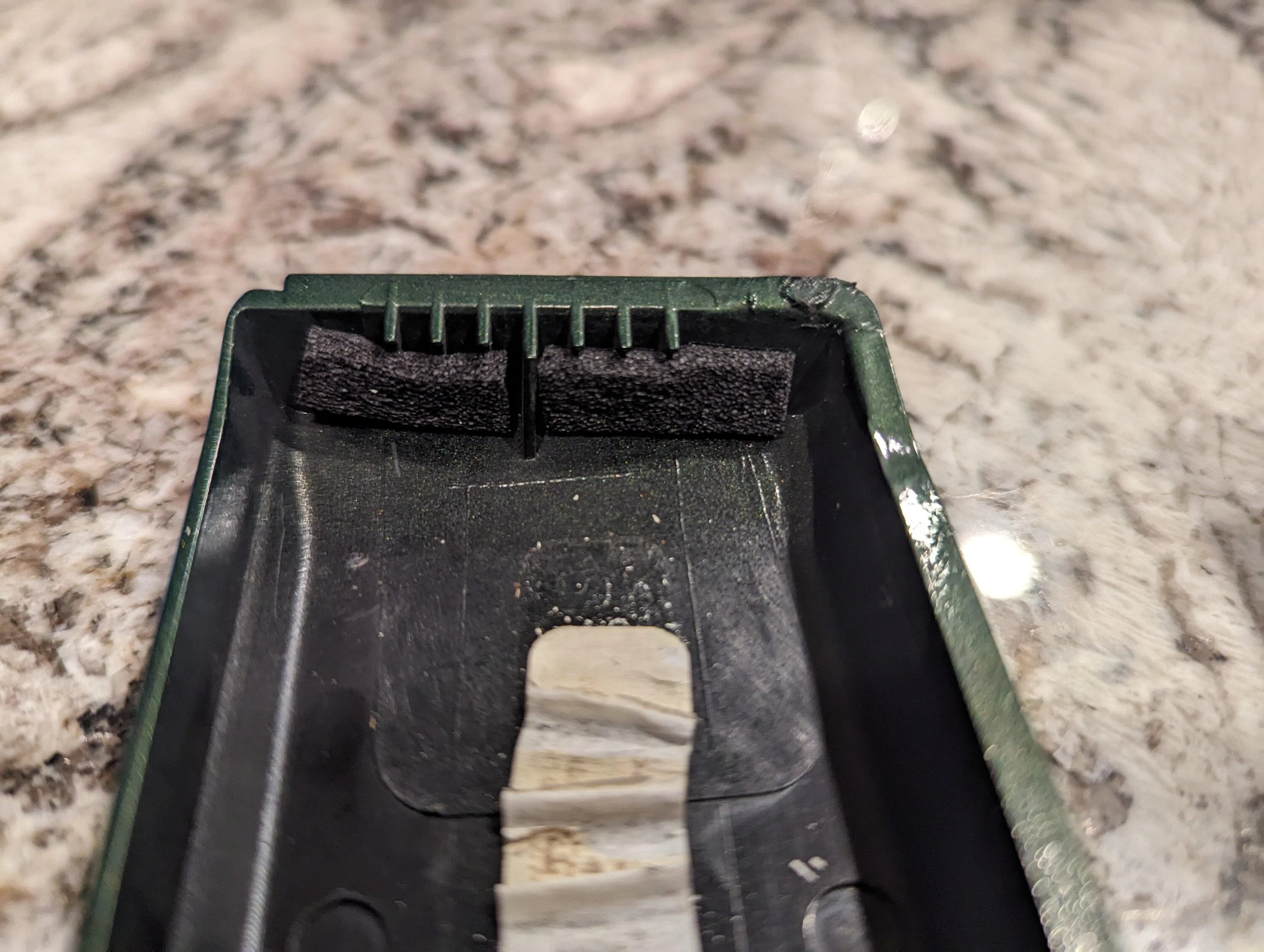

I think I narrowed this down to the painted plastic covers used on the windshield frame mounts. I wasn't hearing the noise every day so I waited until it was pretty obvious to pay closer attention. I pulled them off a couple of days ago and the noise disappeared. Trying this solution out - added some stick-on foam to the covers. I'll report back in a week or so.
