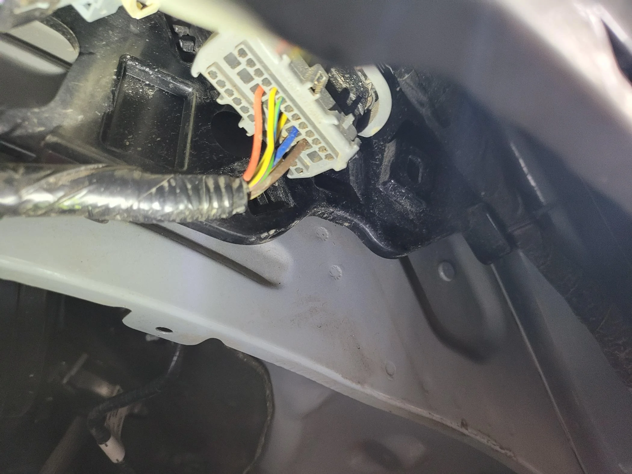

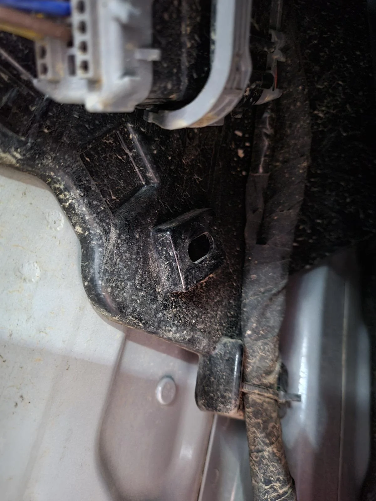

Just got the same issue for a week now, just in time when the bumper to bumper warranty is out. Mine started as a static sound kind of rattle when I'm gassing on low speed. Now it appears even on high speeds. I thought it might be the windshield cowl being slightly warped. I taped the warped parts and still makes noise. Now I'm thinking it might be leaves and debris inside the cowl area. I'll try the foam covers this weekend, and hopefully resolves my issue.
Peteduce
Oct 1, 2021
72
122
Bay Area
18 ND
Update found my issue. It was the plastic inside the driver side fender. It holds wiring harnesses that goes under. Its held in place by three plastic clips, only on its left side. So I just placed a stick on foam under it. Noise is gone. Well, most of it. I probably should have placed more on top.
How did you access this area in the fender?
