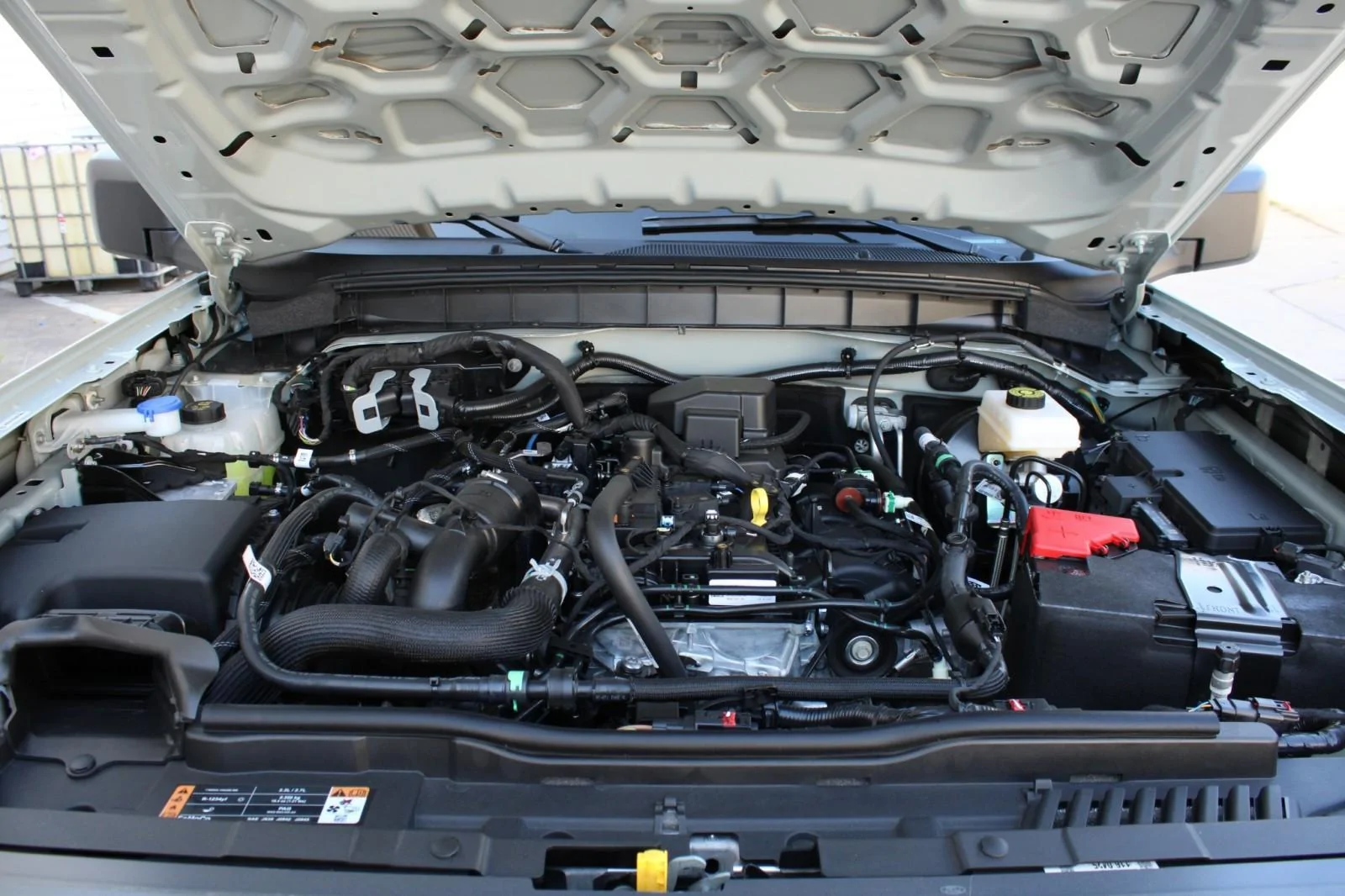

-Is the 2.3 Eco normally at an angle? I don't remember, but found a couple pics as of Today and I'm thinking motor mount.
-Would a pothole be enough cause a motor mount or other mount to break that causes the exhaust to shake and vibrate?
-Is the motor suppose to setting on the front diff?

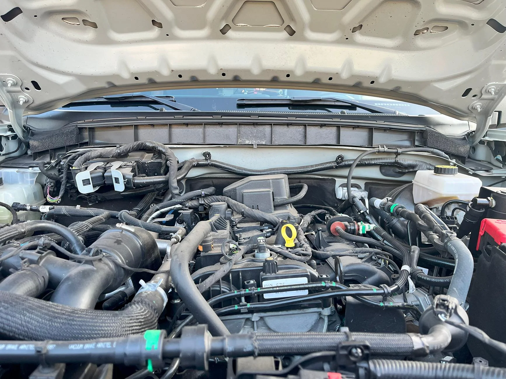

My Motor - slanted towards passenger side - Don't be judgey - I know I need to detail the motor!

Random bronco for comparison

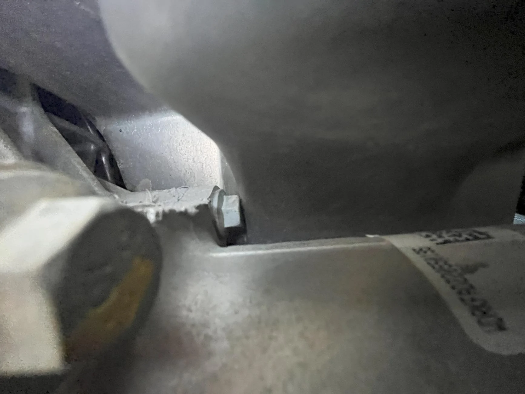

View of the oil pan right next to the top bolt of the front diff housing. just seems close to the point of constant contact.

In that first pic the whole engine does seem to be slanted. Broken motor mount possibly?

There was a thread on here a while back where one or more of the motor mount bolts had fallen out or were not installed. You have a similar issue.
