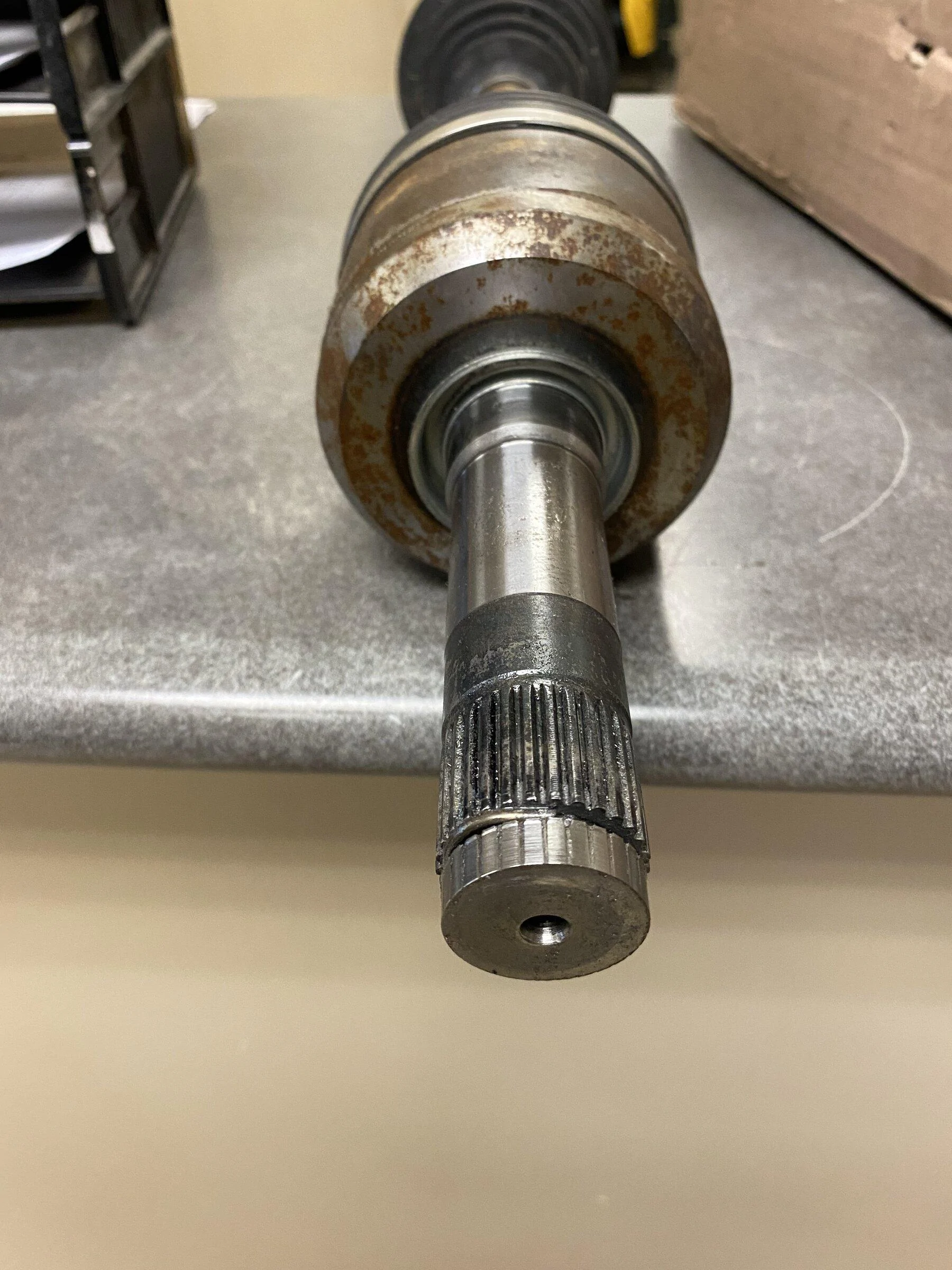

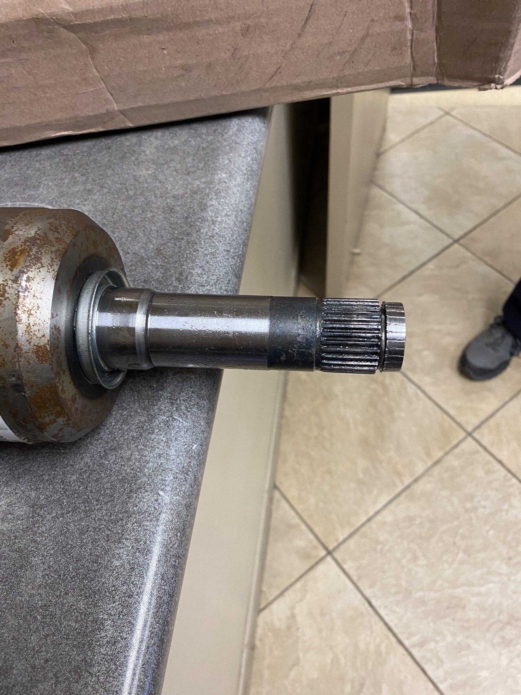

Picked up my Bronco today. Got some pics of the bad axle shaft. Seems to drive good, tested everything before leaving the dealership.
Hoping everything is good now, time will tell. Thanks for all the input on this. I do wish they would have replaced the diff, but service says it’s been flushed and will be under warranty if something happens.
Hoping for the best.

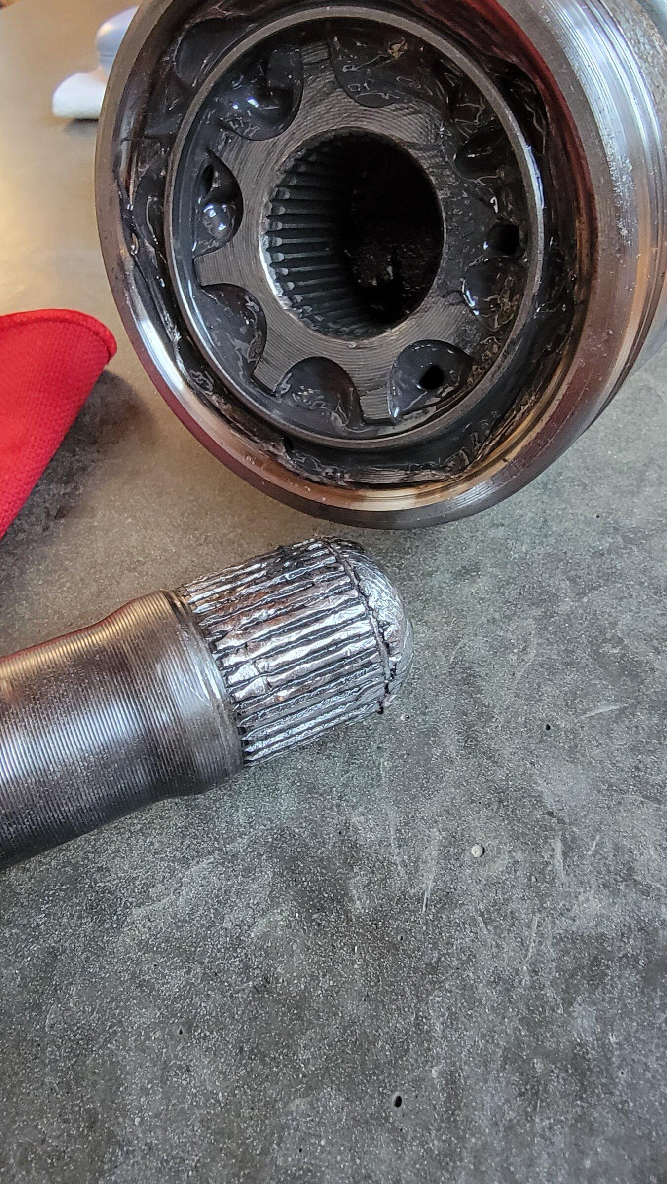

I was about to tell you the same possibility. We just got ours back from the dealer yesterday 1/31 and this is what it looks like. No c Clip from the factory and axle never seated into the joint. Didn't show up until I tried 4WD on our gravel parking pad. Front wheels never engaged. The local dealer declined warranty stating it will happen again and again because it has 35" tires and 2" spacer lift from Rough Country. My full story is
Ford Bronco No 4x4 from the factory 20220201_084134
Ford Bronco No 4x4 from the factory 20220131_164708
in another post. We are waiting to hear from Ford Corporate regarding warranty. I'm going to do a post, since I've gathered a ton of info, regarding axle angles from different models including our Big Bend with RC spacer lift.
