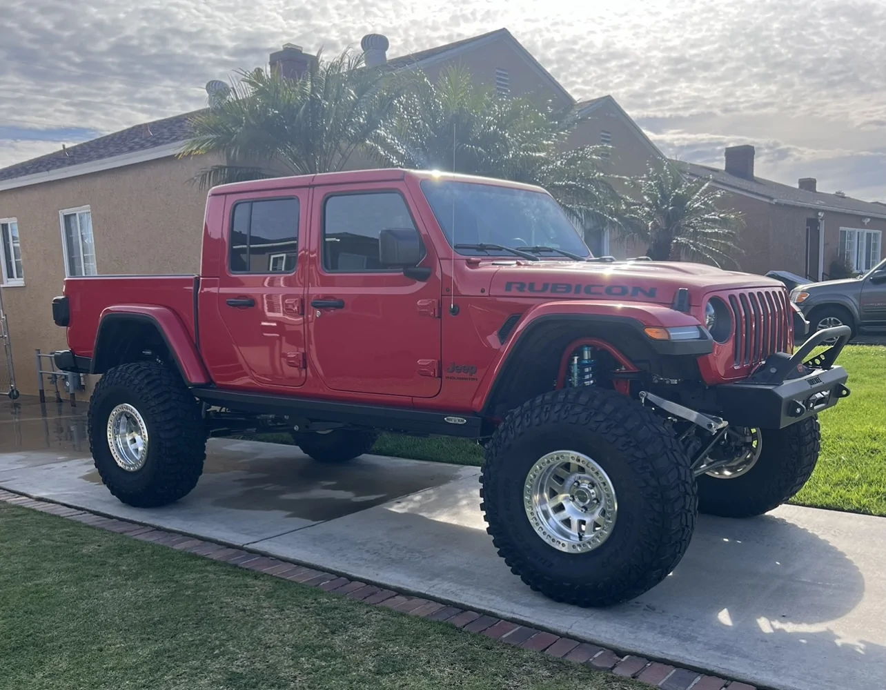

I use anti-seize on my Bead locks. In my humble opinion you would have to be nutty to use Loctite. Water causes corrosion on those bolts and the anti-seize works great. On all the bead lock wheels I’ve owned, none of the ring bolt’s have ever loosened up using the anti-seize.
