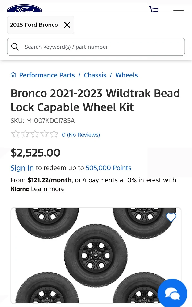

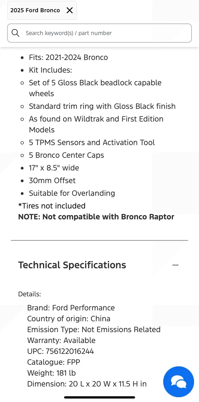

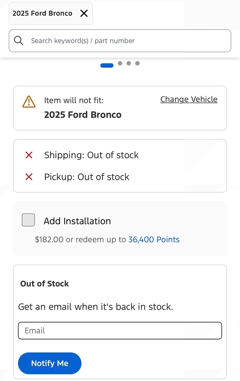

Trying to learn about some of the differences on the raptor versus a regular bronco. Why will these wheels not work on a raptor bronco, Thanks.

Lug pattern is different between the Raptor and other trim levels, also they are M14-1.5 size lugs on the Raptor vs. M12-1.5 on other trims. I believe the Raptor is 6x135mm.
